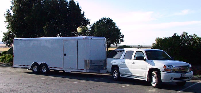

Anytime you are loading any trailer you want it to have as much tongue weight as it can stand
You should NEVER exceed the manufactuers maximum tonque weight specifications no matter what other people try to tell you. You should also NEVER exceed the manufatuers maximum GCVW (gross combined vehicle weight) no matter what other people tell you either.
To do so places your safety, and the safety of others on the road at risks.
If your within the manufactuers specs, there are devices to help control a trailer. Weight distributing hitches help balance the load between the front and rear axles. Anti sway bars dampen side to side motion.
