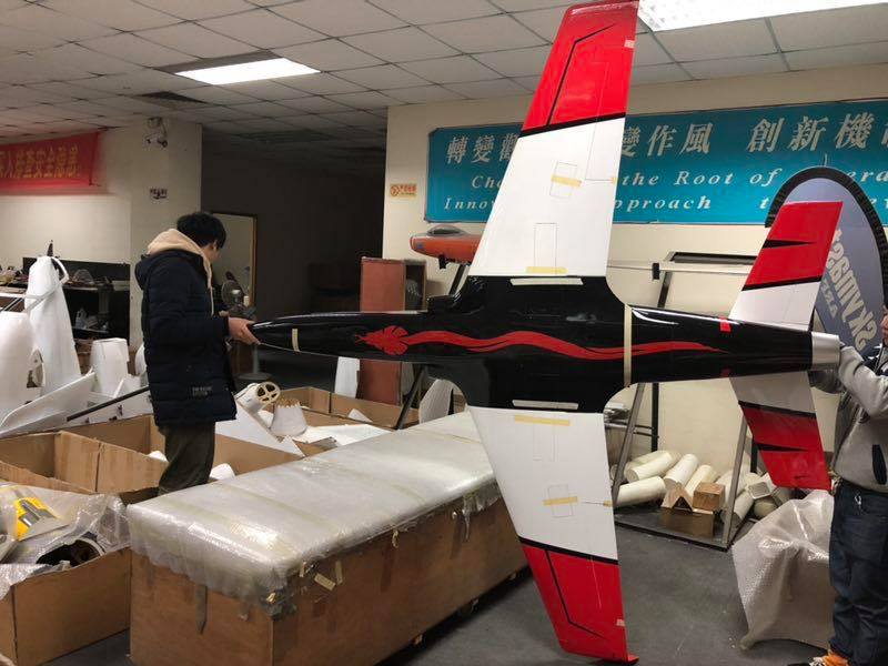

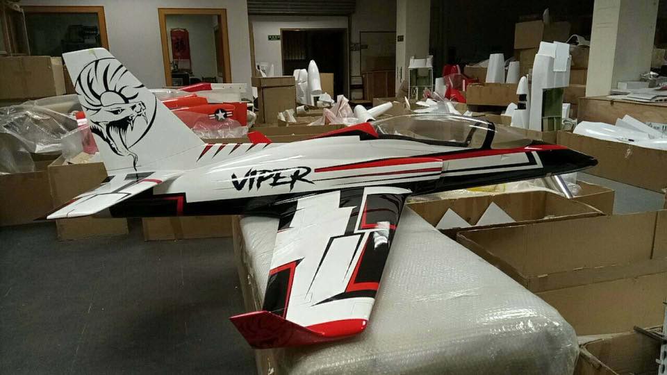

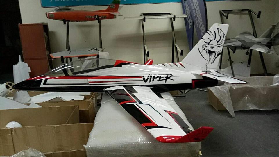

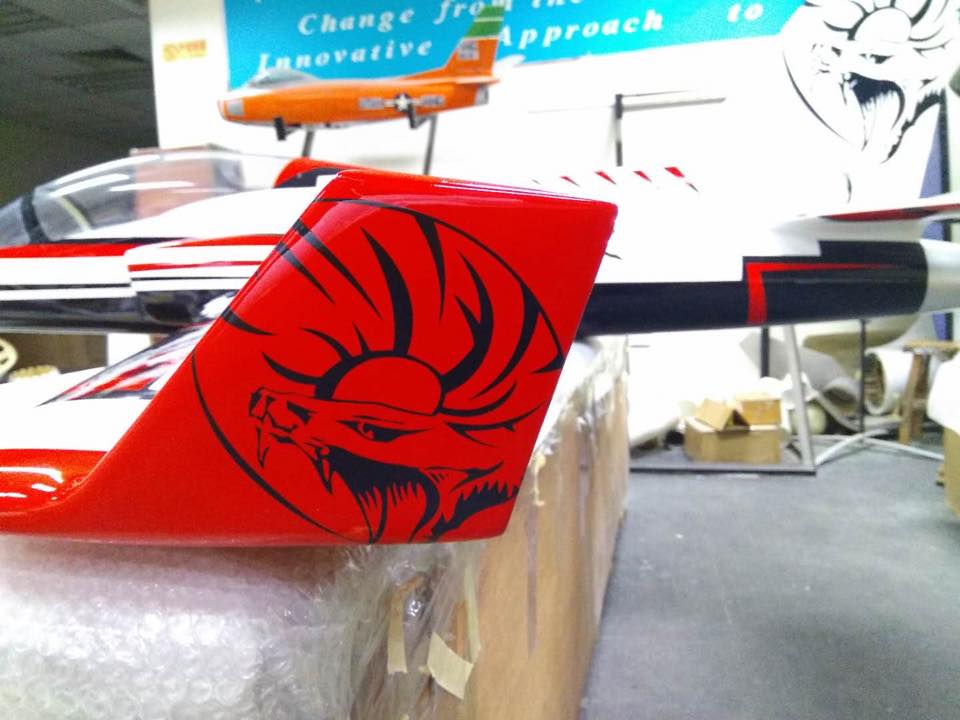

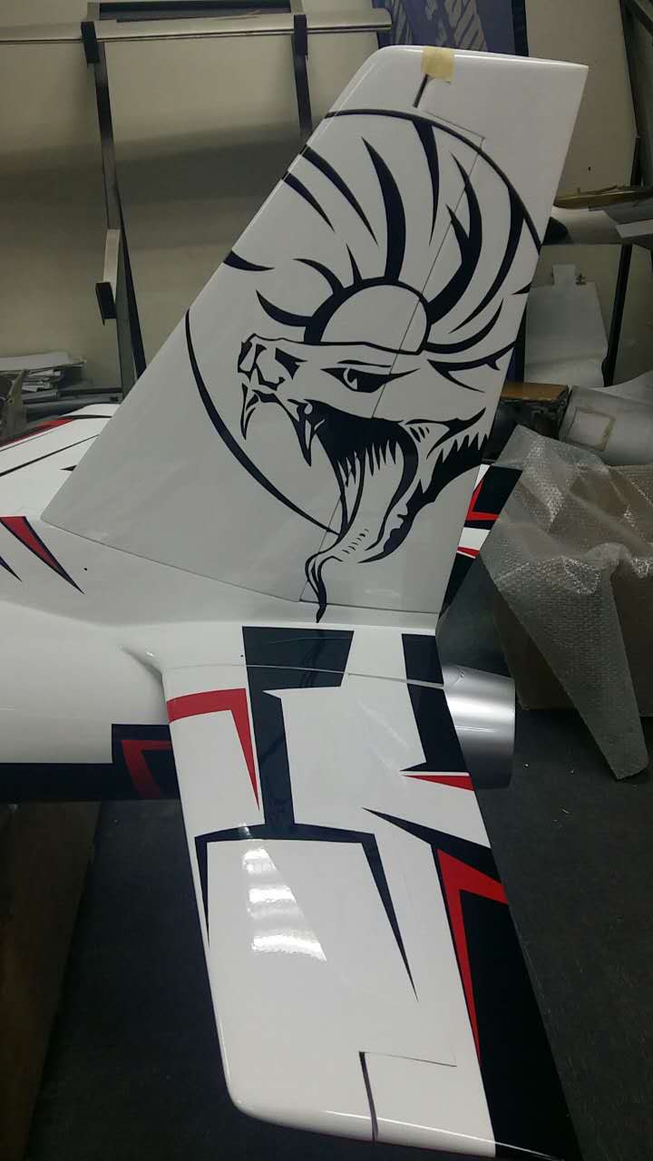

Old 01-31-2018 | 06:18 PM
  #1727
Posts: 2,478
Received 24 Likes on 21 Posts
From: Kaohsiung, TAIWAN
Nice color scheme by customer himself designed.,
