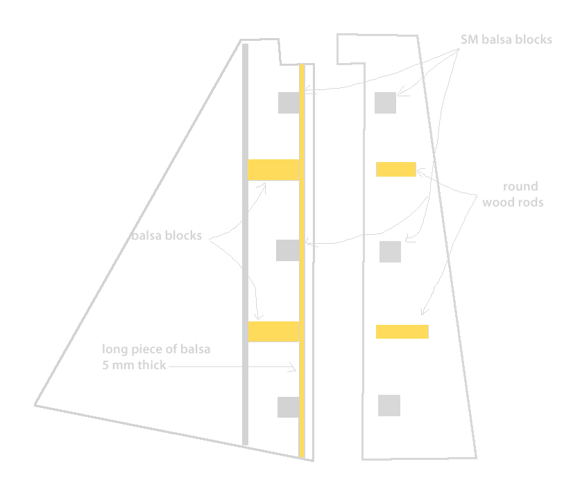

I forgot to say that I also put a long piece of balsa, 5 mm thick, glued on the fin behind the rudder because the rudder didn't go to touch the fin and the hinges remained out of the fin for almost 5 mm.
I think that nobody will understand what I said
and I don't have pictures....
Alessandro

I understand what you mean, no need for pics
the brass tube i hysol'd onto the hinges, did the same thing as the balse you used.Jascat,

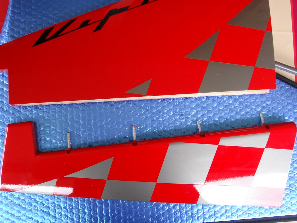

Hi Duncan
Thanks for the pictures.
i made some pictures of my fin and rudder. There are already 4 hinges inside, and it seems, they are already glued in into the rudder.
Looks like robart, but isn't robart.
Are your hinges glued in too and how did you removed them ?
Another point is, the balsa block inside looks stable,.... but there is nearly no glue around
I think i have to invest a lot of time to stabilize fin and rudder.
attached some pictures
Kind regards

You are right again Duncan (it's becoming boring ah ah ah) I had to put two blocks of balsa inside the fin and two hard wood rod in the rudder. I think that now my two hinges are more solid than the three SM because, as you see from the pictures of Nicolò, the SM balsa blocks inside the fin are not so secure....[&:]
Ciao
A
[/quote
Hi Alessandro
"..I had to put two blocks of balsa inside the fin and two hard wood rod in the rudder..."
Sorry,.. but how did you do that ?Did you open/divide the fin and/or the rudder
Kind regards
Rainer

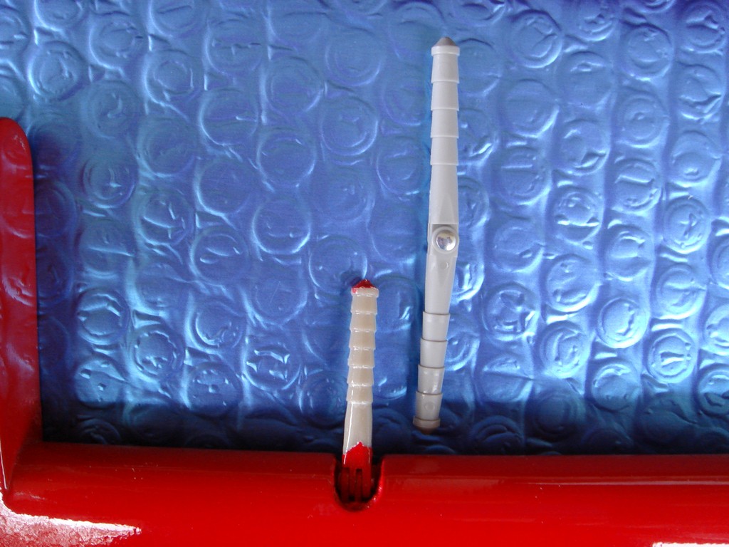

Hi Rainer
You are lucky in the fact that when i got my viper, it was up to the builder to fit the hinges in the rudder. Measuring how deep each hinge had to be sunk and getting it right, took a fair amount of time.
The part of hinge that goes into the fin, is the part i hysol'd the brass tube onto. The brass supports the part of the hinge that is left in the open, giving strength to the unsupported area.
Duncan
Duncan
