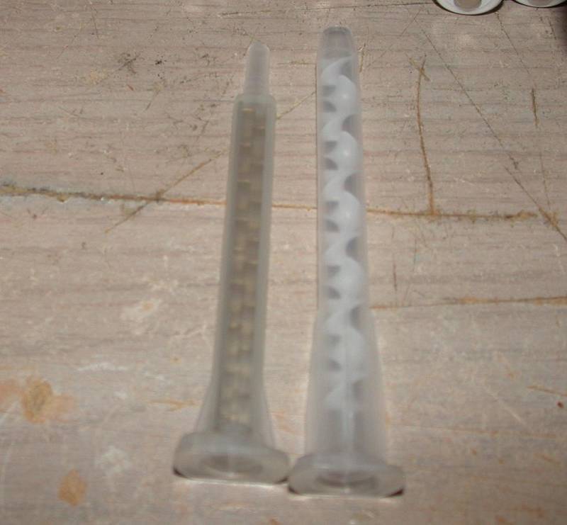

I have used both long and short tips for years and ALWAYS check the quality of the glue joint after each gluing ( mostly because of this air problem again ). I have not detected any alterarion of the bonding quality with short tips.
The tips that I have included in the links above are proven over at least 4 years of regular use...

Yes, waisting product in the tips is a problem.
On the other hand, I keep using them because love the precision of the gluing joint that they offer.
I have done many tests with Hysol and other products. There is no way that the glue strength is multiplied by two when mixed in a cup. I have not noticed any difference in fact.
The mixing tips when cleaned with acetone can be reused around 10 times.
there are two different styles of the short nozzles, the one on the left in the pic is acceptable and gives a complete mixing, the one on the right does not and shouldn't be used.

KC, where does each of the nozzles come from (who makes them)?
Tim
