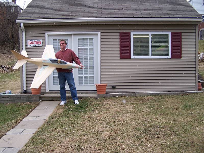

Hi Guys,
I have been flying turbines for the last 10 years with my trusty Futaba T8UAP. I have made thousands of flights with this TX and Futaba recievers, Futaba and Hitec servos and Never had one issue with this radio setup. I was forunate enough to win a New JR 9303 2.4 at Kentucky jets last year and I guess it is time to make the switch. I am planning to put it all my jets and I am wondering if anything special should be done. Right now I am using 2, 5 cell Nicads in all my set-ups. In my scratch built jets, I need the extra weight in the nose. I am running these packs and switches directly into the Futaba recievers, no regulators. Again I have never had a problem with this setup. Do you think I can just swap the recievers and use the same setup with the JR Recievers? Any suggestions or comments would be appreciated.
Thanks in advance,
Ron
