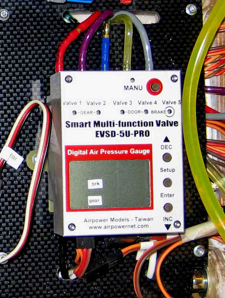

Most installations will require some restriction in the flow volume to keep the gear and/or doors from slamming up/down. This is unrelated to the delay you set between the gear and door sequencing.
For my particular installation (Skymaster ViperJet) I found that I needed more restriction to slow the gear down. I replaced one of the provided restrictors with a Robart, which has a smaller diameter. Note that a restrictor on either side (up or down) will affect the flow in both directions since the air is restricted both going into the cylinder and out. You usually have to experiment a little.

It doesn't matter where in the line you install the restrictor but you might want to put it where it is accessible. I needed to slow down all my gear so I put the restrictors close to where the line exits the unit. You can see them in this picture.
Craig

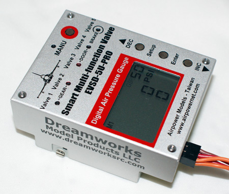

Anybody have an issue with one of the read outs Gear or Brake can't remember which one, but one of them reads constant 240+ psi , while the other works flawless. The valve functions correctly just one of the read outs wont change value now Very odd....
C
Old 08-18-2009 | 08:44 PM
lov2flyrc's Avatar
My Feedback: (24)
Posts: 6,102
From: Daytona Beach
Default RE: EVSD-5U valve Install
Sounds like a pressure sensor went bad. What PSI are you filling the system to? Give us a call and we can replace the unit for you.
Todd
