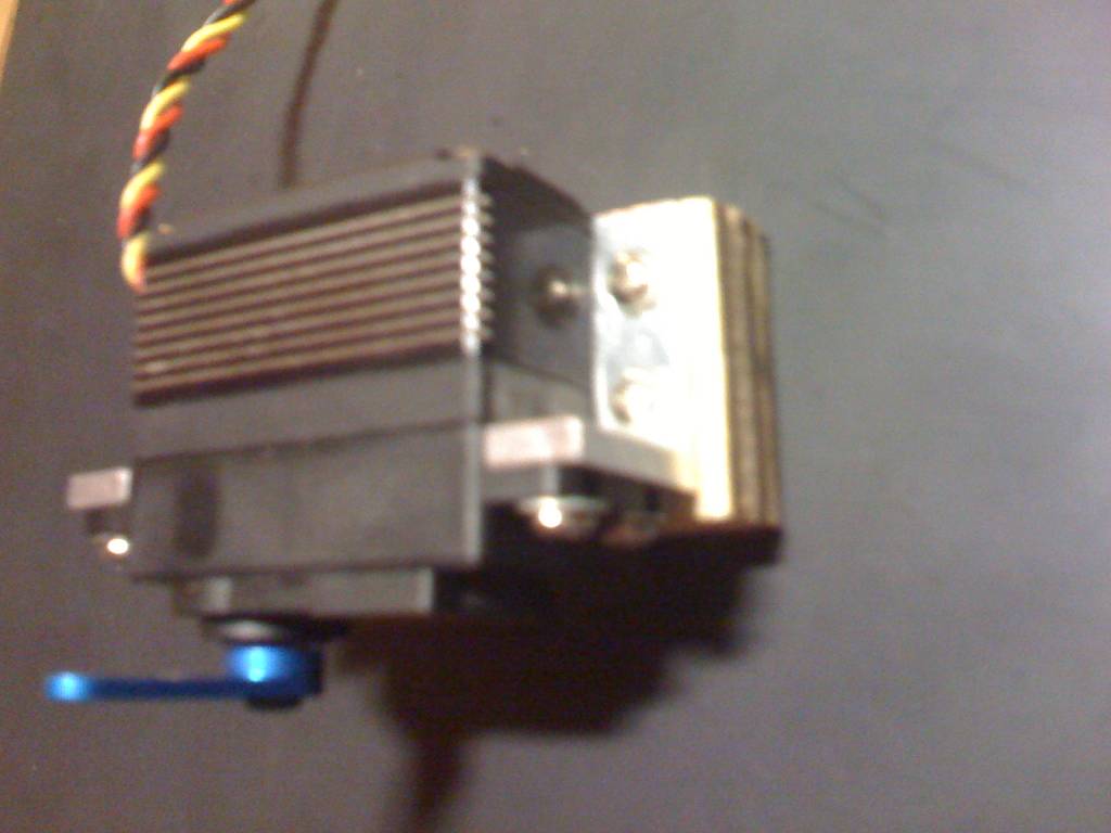

Old 12-23-2009 | 07:14 AM
  #89
DelGatoGrande's Avatar
My Feedback: (23)
Joined: Mar 2004
Posts: 3,001
Received 17 Likes on 11 Posts
From: ATHENS, , GREECE
Default RE: Skymaster L39 build

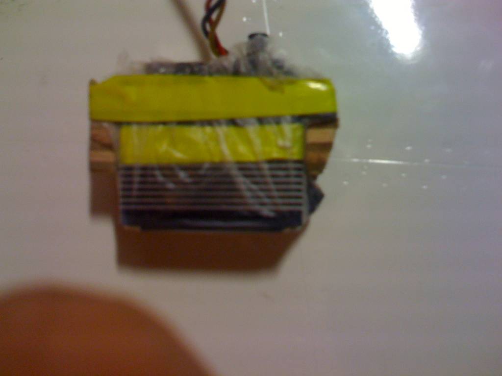

about the aileron servos i dont agree how the manual show to instal the L aluminium suport to the wood and the servo.
my way you get the corect height for the servo and the servo screws go vertigal in the wood nerves and not paralel with the danger to seperate.
hysol everything and its good to go!
poor photos becouse of iphone use

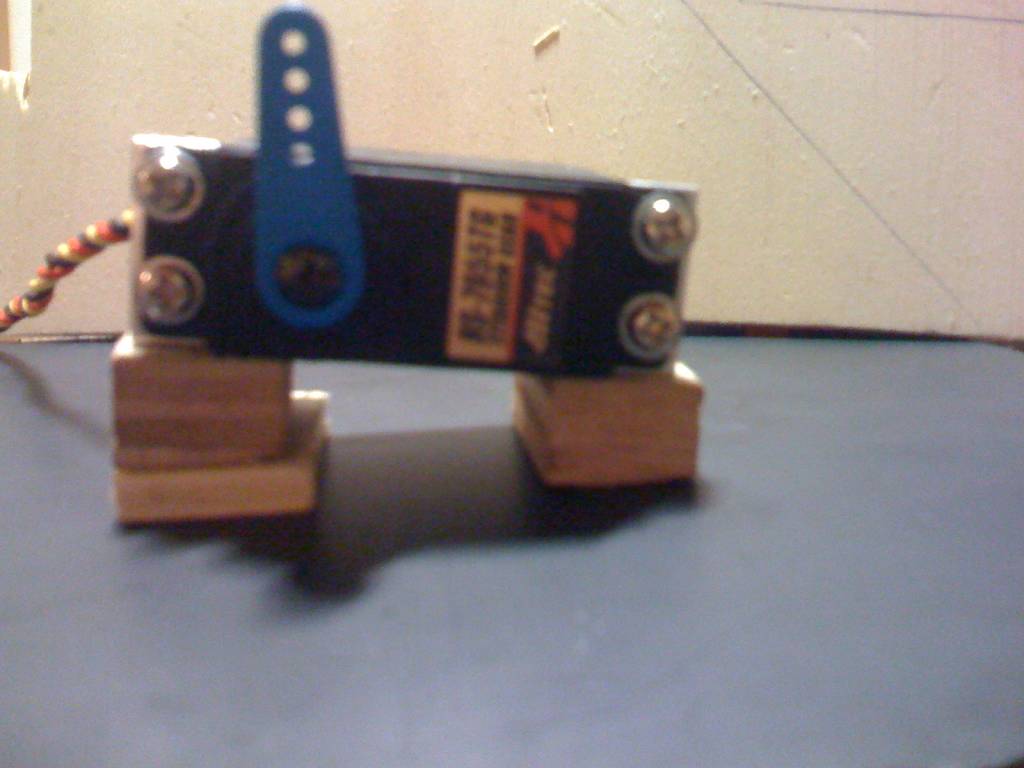

about the stab servos...
we used a very strong flash light behind the stab and you can see there is a good space in the center of the stab to have the servo..
with a hach like for the ailerons..
anyway i went with the manual on this one and made the two small wood servo suports
tight fit and i removed some of the wood of the stab to get the corect depth..
i used a plastic bag just to protect the servo of gluing together with the stab so i can remove it later..
hysol everythink in there and push it in..
forgive my poor english
BigCat over + out

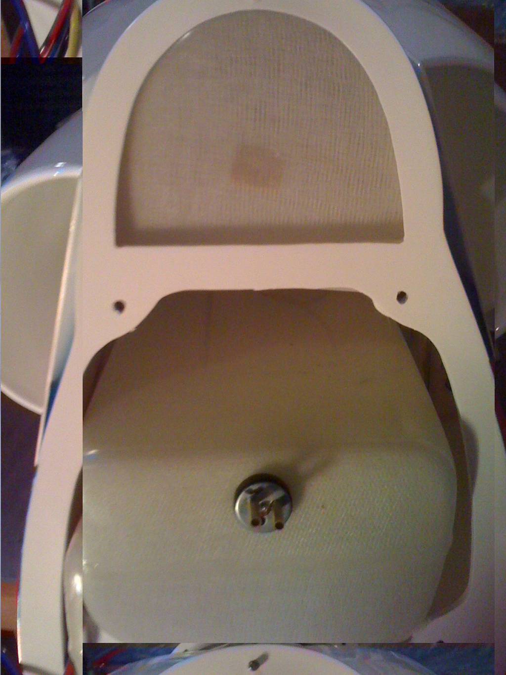

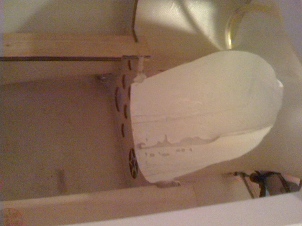

top tank can be mounded with fitings face aft so it wont interfear with rear cocpit

Good idea.........wish I'd done that.
I found the bottom tank interfered with the aft cockpit too. Shame they made it so big, just 10mm shorter would have avoided lots of hassle.
Cheers, Alex

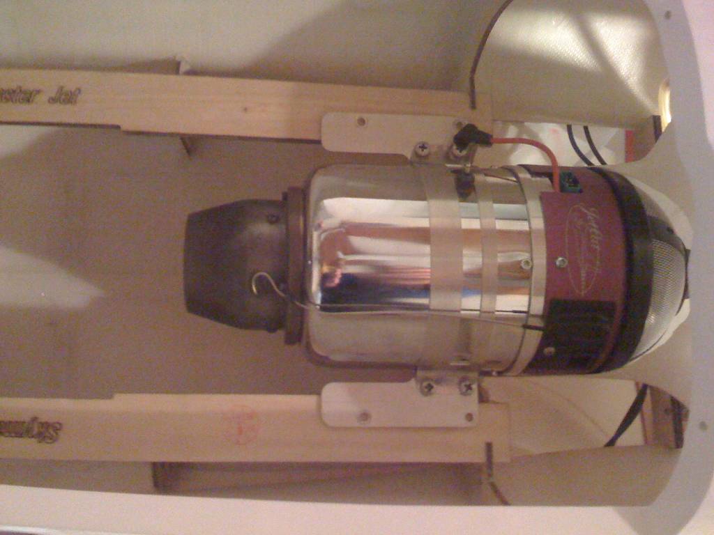

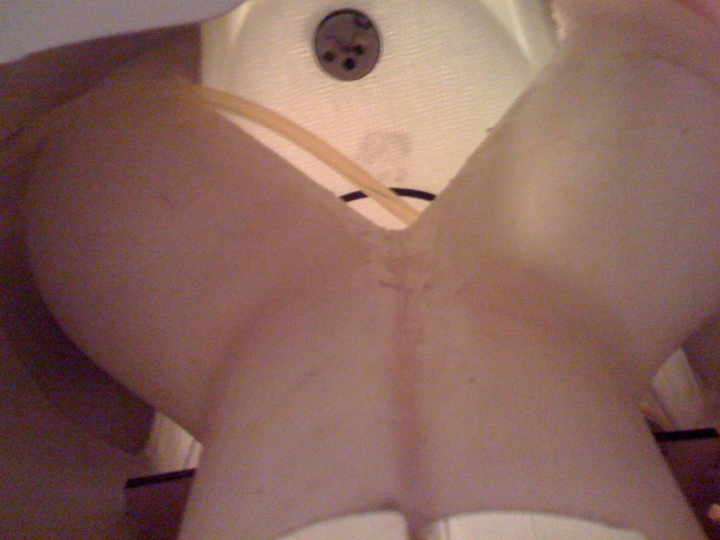

just turn it around...sometimes when i finish building im bord too[&o] to go back again
two powerbox lipos in the nose with jetcats lipo
in a try to avoid extra waith in the nose so to achive proper cg...so total waith low
intake cut out to bring engine forward as far as posible..longer pipe will be used ofcource
we will see at the end how it balance
