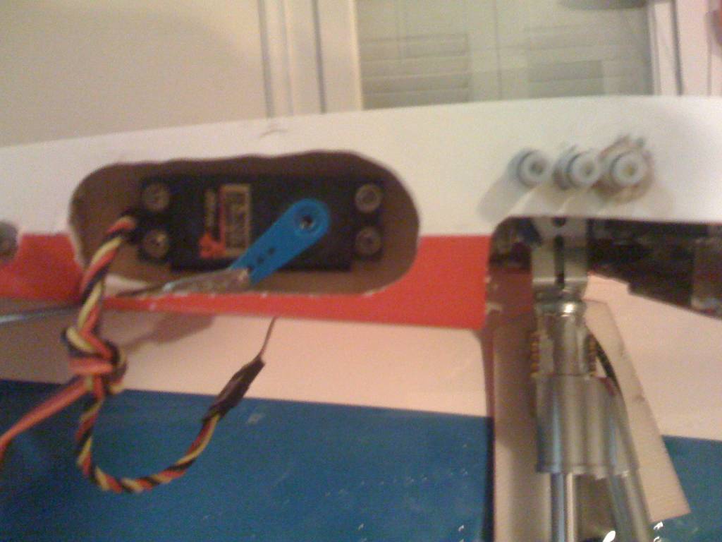

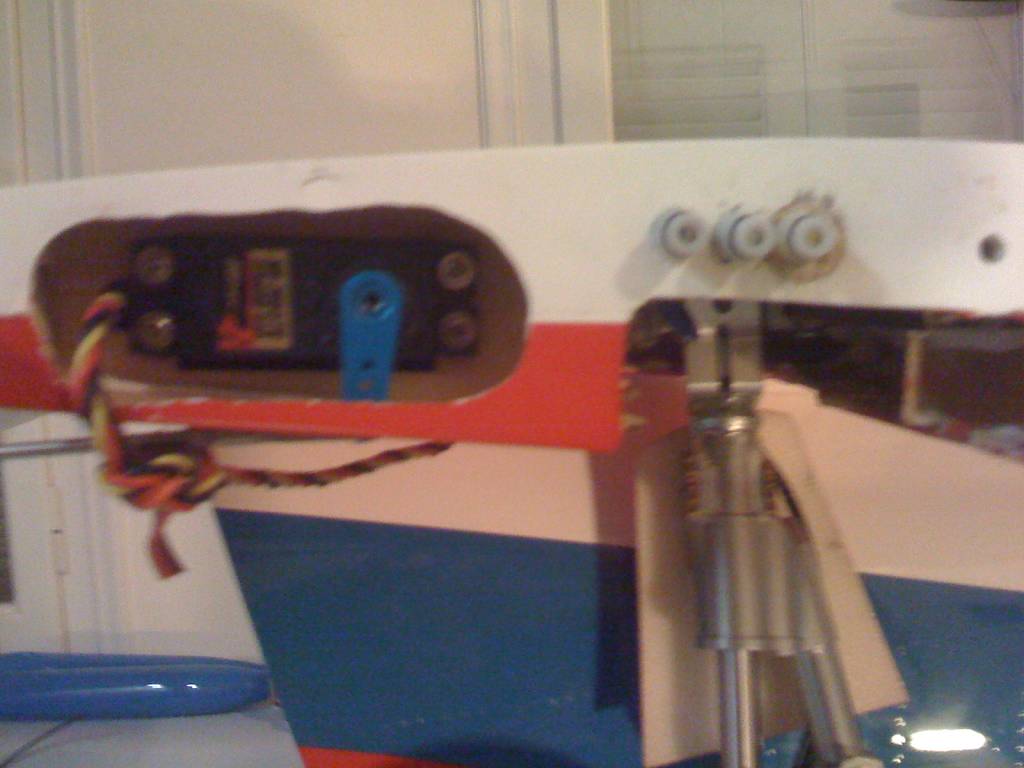

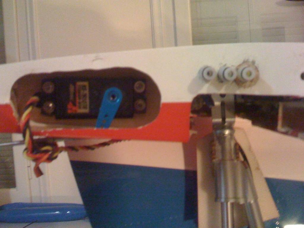

Here is a question for you l-39 builders who have installed your flap horns..
When I mounted my flap servo on the cut out rib just inside the wing root, there was a nice cut out for the servo. I then cut a slot on the bottom of the wing for the servo arm.
As I am about to glue the horn in the flap I measured a direct line from the servo arm to where the flap horn would sit, only to find that the angle that is produced by screwing the servo to the servo rib produces an almost 10 degree intercept point with the hinge line.. So the rib was not glued in perpendicular to the hinge line. Hope I am making myself clear on this one.
Has anyone else noticed this problem? I guess I could build an angle into the way the servo mounts, or I could just live with the angle and hope there is very little binding as a result of not being perpendicular to the hinge line.
Has anyone noticed this in your build? and what did you do to fix the problem?
Stan

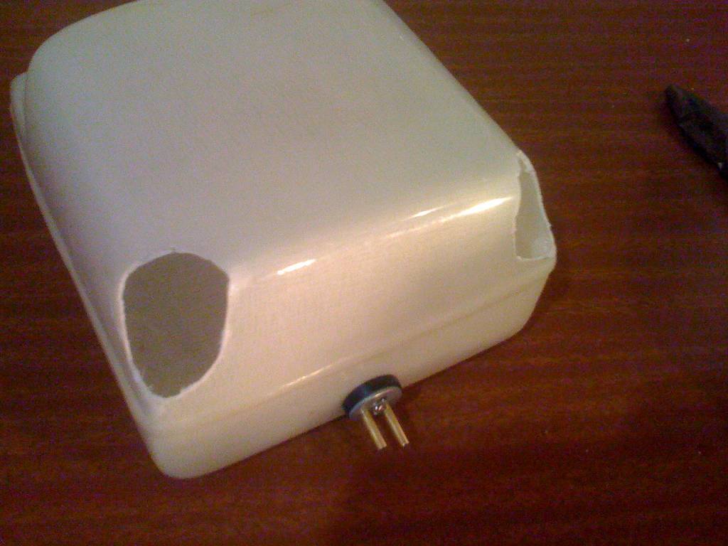

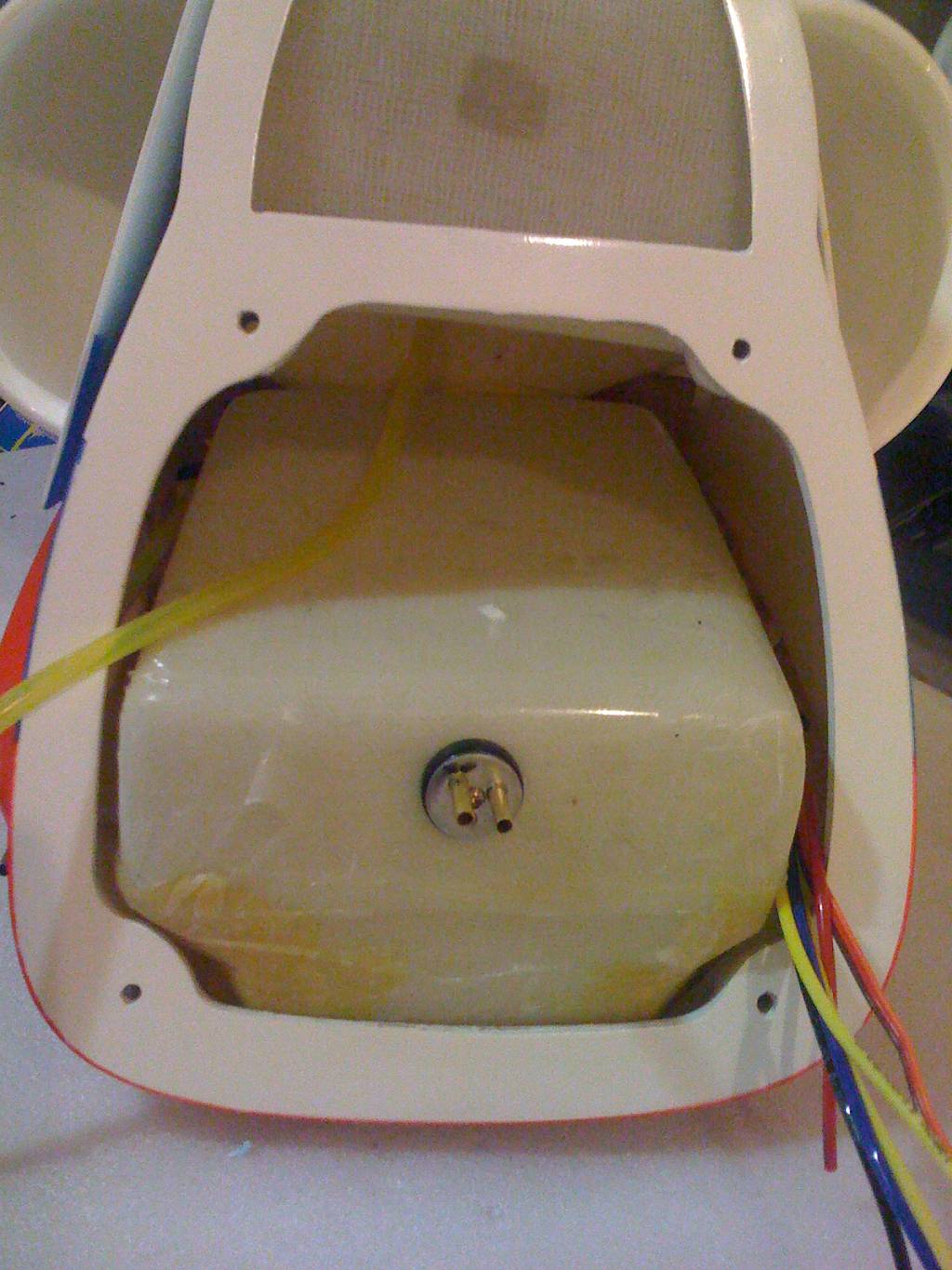

cut the corners out from the big tank to clear the fuse if you like..
this will give litle more room for smoke tank in the midle of fuel tanks.
few layers of kevlar and fiberglass will make the new walls..

Hi Stan
I did notice that issue. It would certainly be best practice to pack one side of the servo to line it up with the hinge line of the flap. I just left it as it was, the binding will be minimal so I'm not concerned myself.
good work on those tanks George.
Cheers, Alex

Alex
I tend to agree with your assessment. The amount of binding should be very little. Not worth changing the angle of the servo especially after the slot for the servo arm is in.

..here is my flap link but not yet programed...binbing is very litle..not a promblem i think

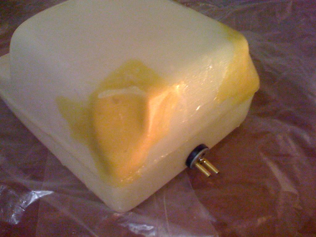

just to show how main fuel tank fits after the cut outs in the fuse..

I guess I am having the same issues with the fuel cells, It appears that the air inlets are in the way of the tanks sitting proper. but I am not going to cut and patch the bottom tank, but i think I will turn the top tank 180 degrees.

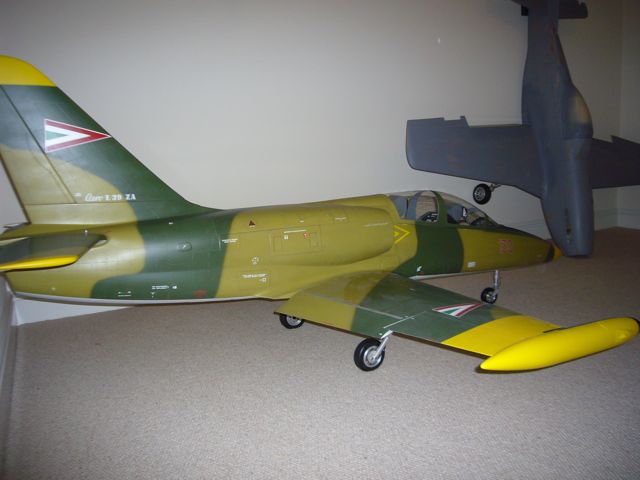

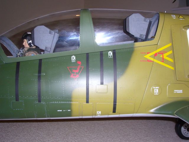

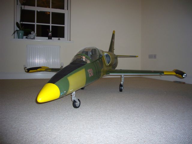

Hi Guys
It's all finished..................just waiting for some good weather and a bit of time to take it flying, Ali's offered to do the maiden.............it's been over a year since I've flown anything bigger than a parkzone model so I'm pleased Ali's going to fly it [sm=regular_smile.gif] Must cut down on the building!
I'm going to make some ordnance for it when I get time, think it will really enhance this model especially with those long drop tanks on it, I've only seen models with the shorter ones....
anyway here's some pictures.

Forgot to mention the canopy frame hasn't had a clear-coat that's why there's a slight colour variation. Will do it when I spray the next model in a few weeks...
