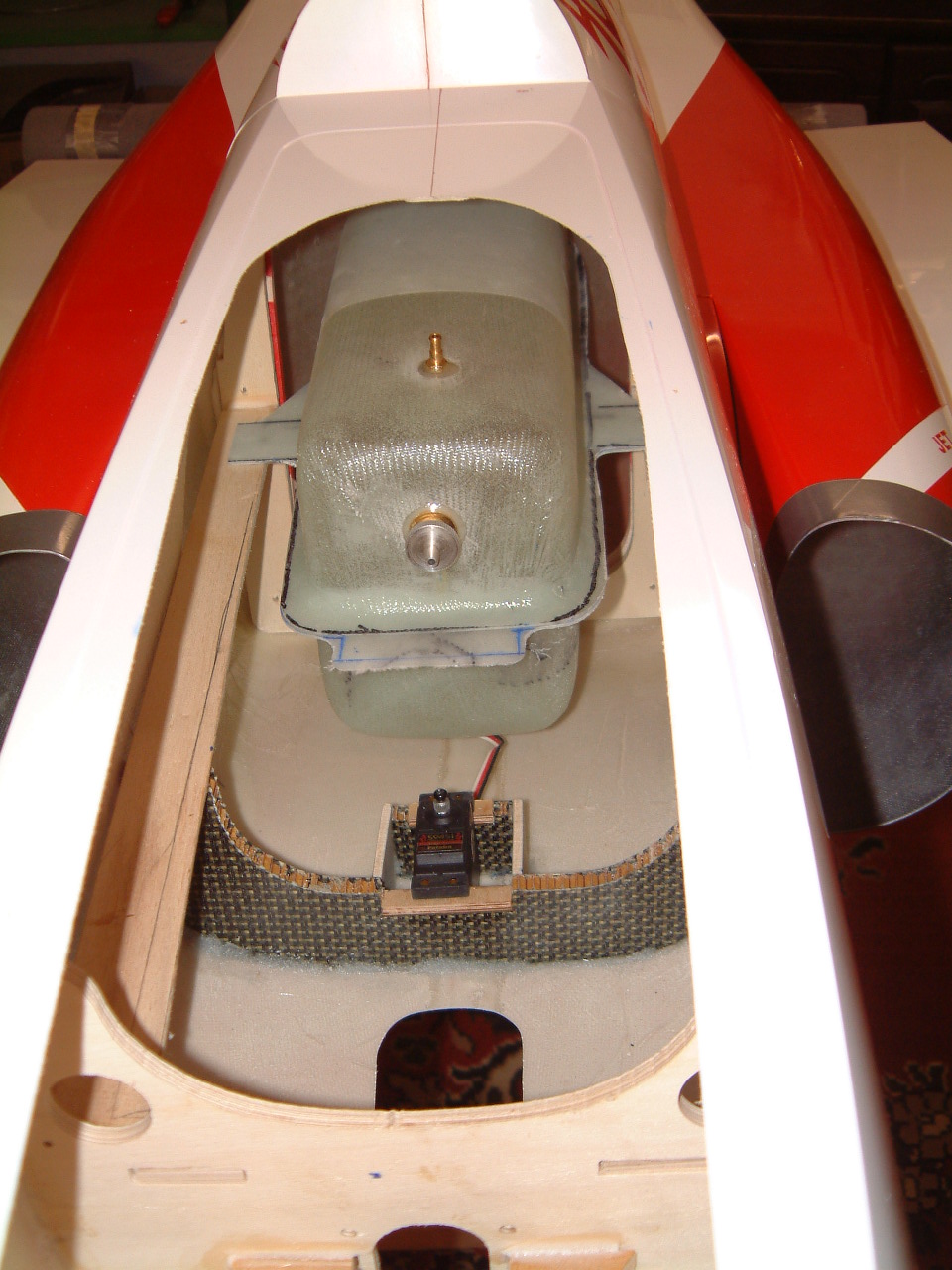

I have just launched into the assemblage of my scorpion ADJETS and I am has the research of ideas to ameliorate assemblage. If you have ideas and photographs to ameliorate my installation.

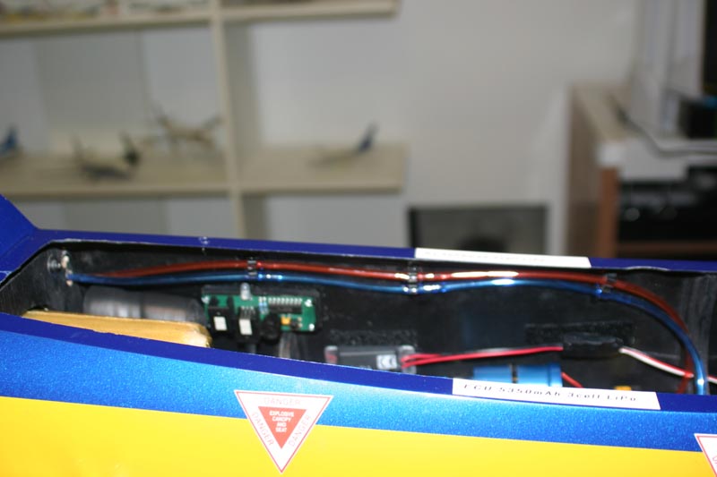

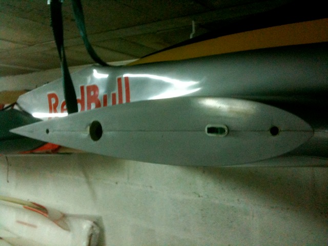

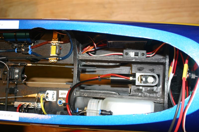

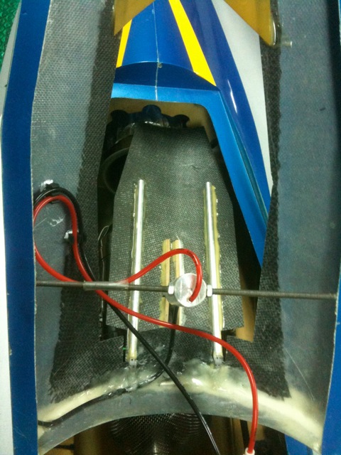

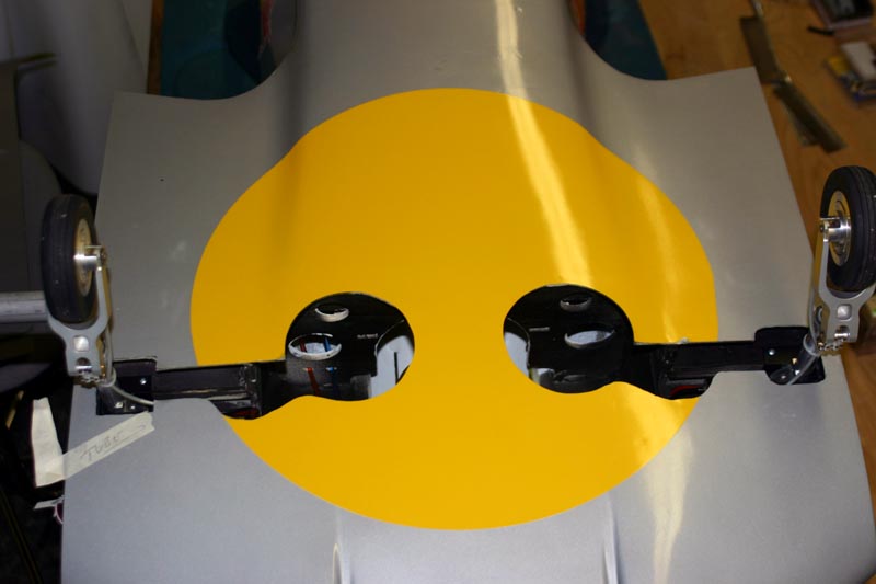

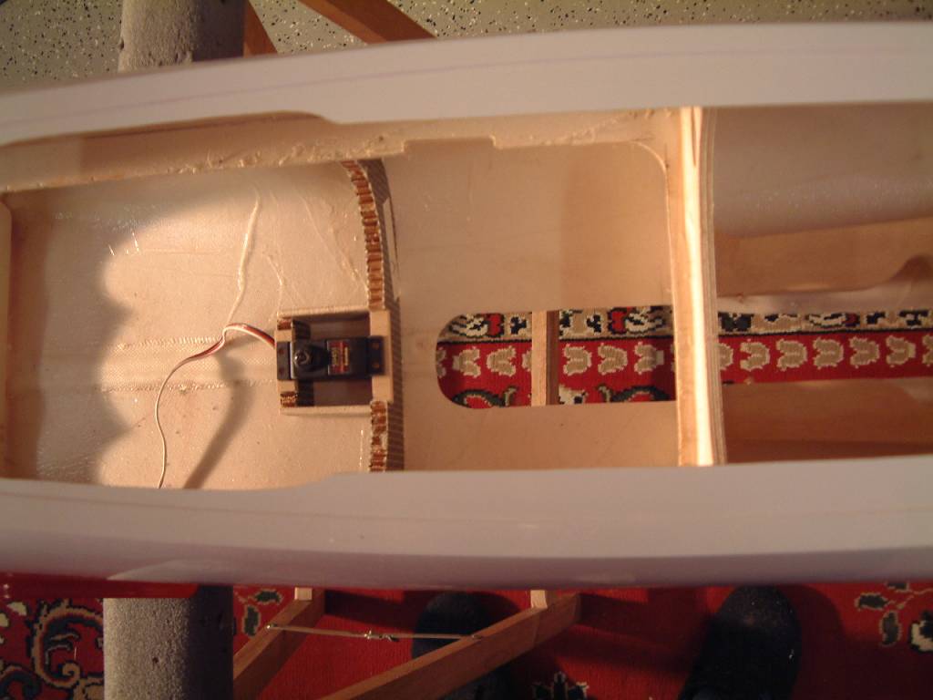

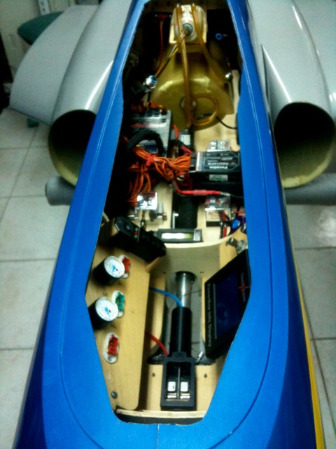

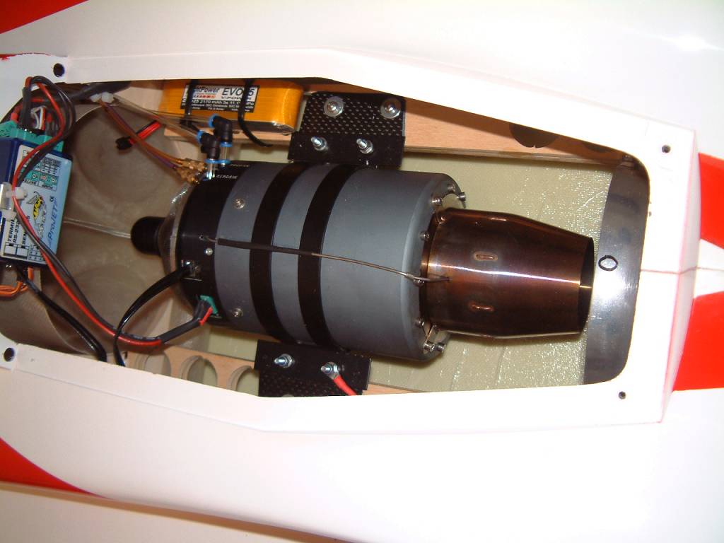

Have built and flown the Scorpions and have attached a few pictures for you.
What construction issues are you looking to resolve?

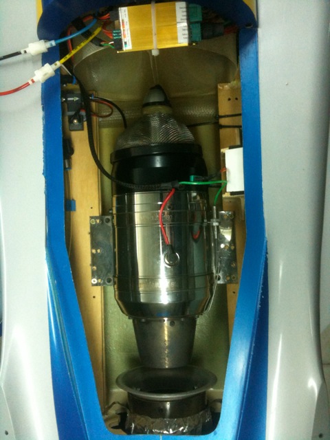

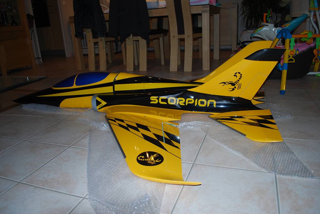

I seek to have an installation of the most simple and clean as possible.
Because I think some things can be improved in this scorpion.
Thank you for the photos which will give me ideas
Old 11-16-2009 | 05:17 PM
Joined: Jan 2009
Posts: 115
From: au dessus des nuages, FRANCE
Default RE: Search ideas of assemblage scorpion ADJets
Je recherche des photos pour modifier certaines choses comme EX: éviter de faire des trous dans le fuseau parti avant pour fixer le boitier de train(mettre des vis et des écrous au lieu des vis a bois).

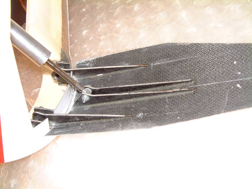

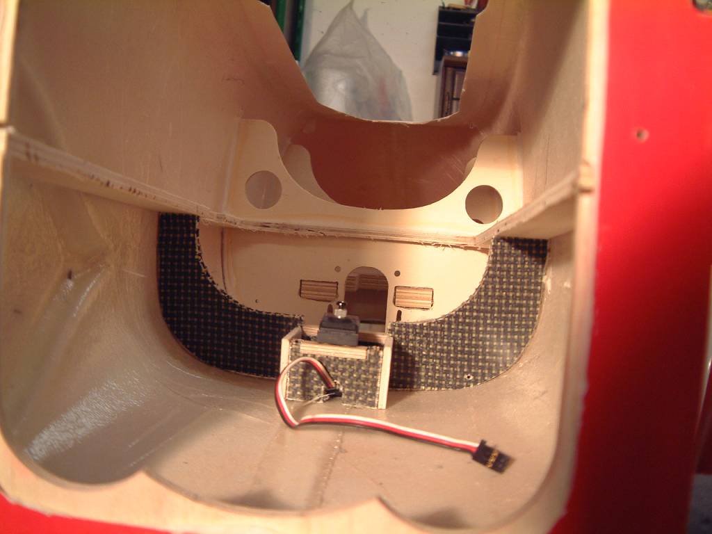

A few things quickly come to mind:
-Take note of the extra ribs installed on the front landing gear mounting - they are weak and break easily
-Build some covers over the wheel wells on the main gear to prevent debris from getting to the turbine inlet
-I made a tray on top of the existing tray so I could make a nice clean installation
-Put the CG on the wheels or maybe on the struts - makes the plane much easier to land
-Make sure there is no slop in the elevator linkage
-Use the jet-tech 4l fuel tank for the Scorpion

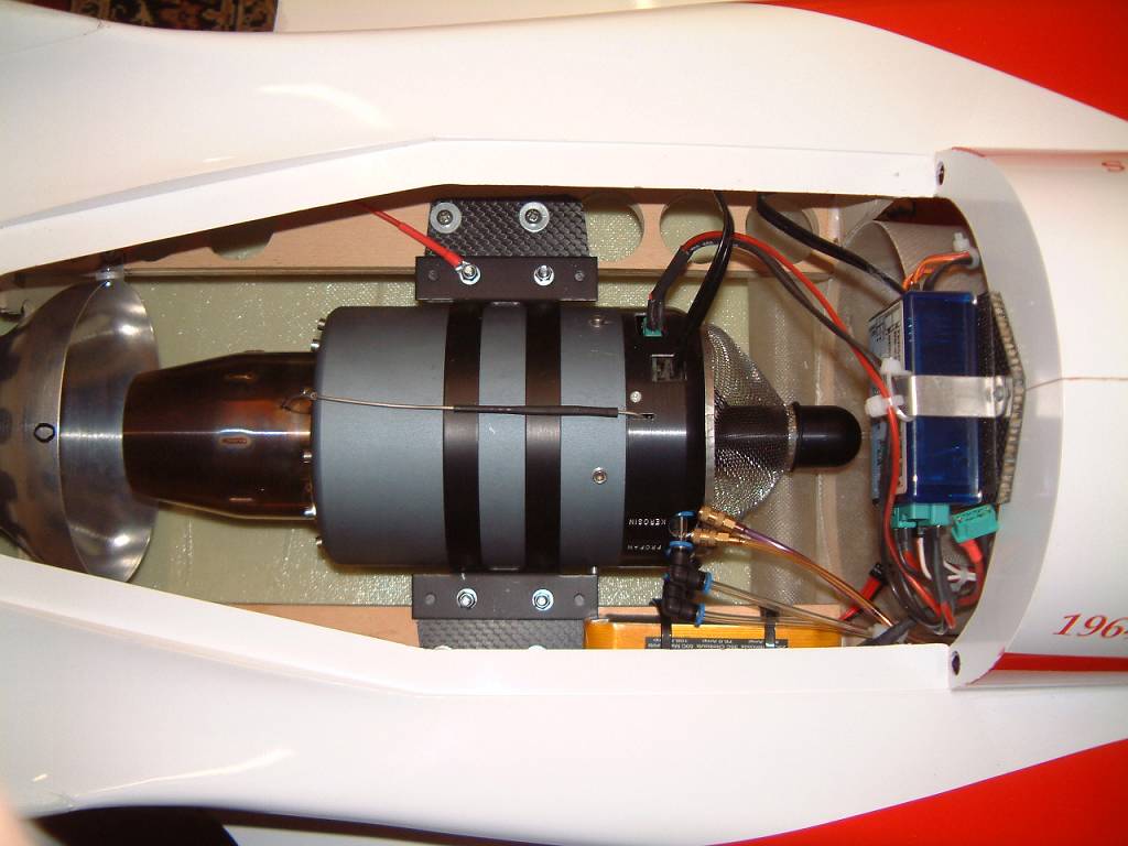

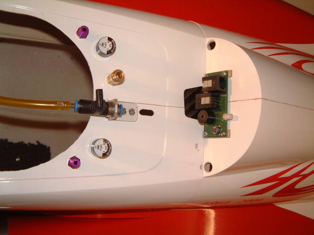

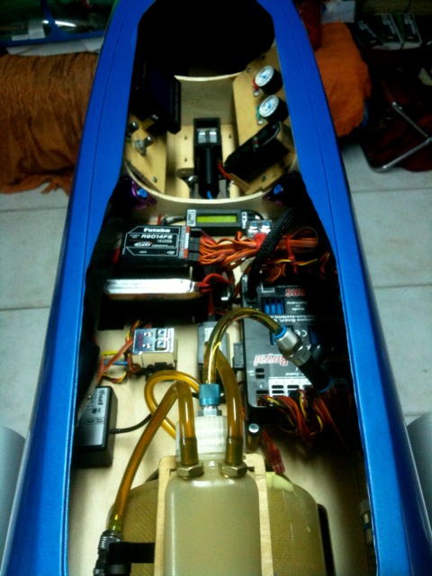

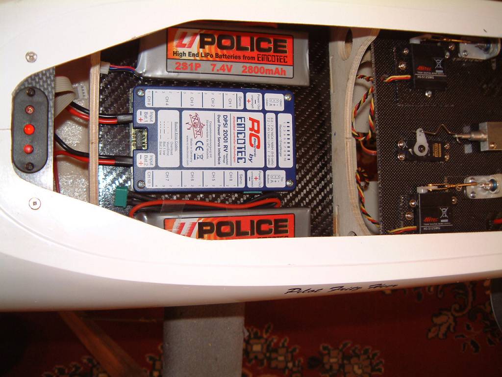

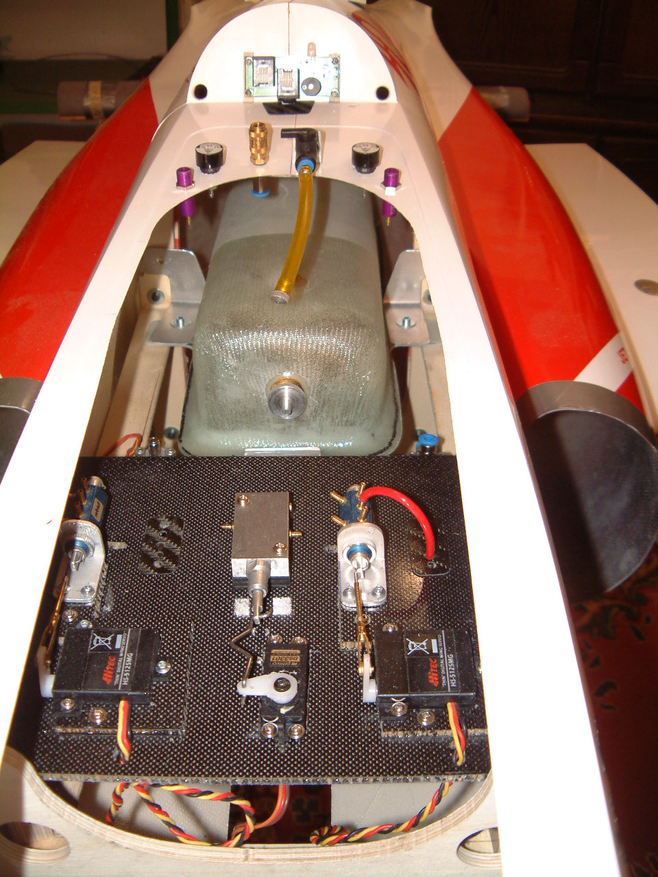

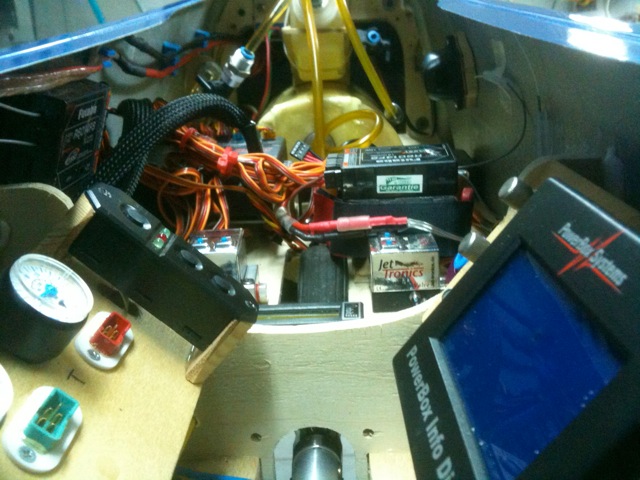

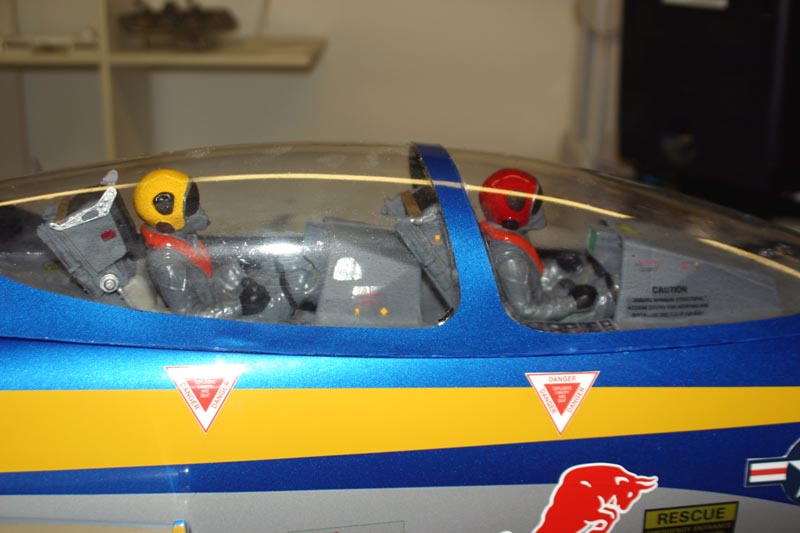

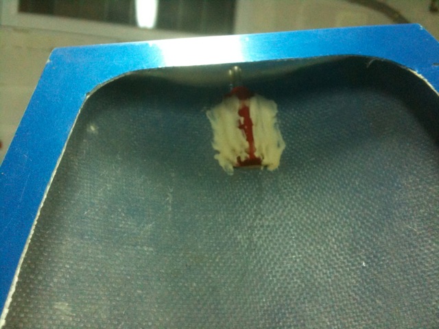

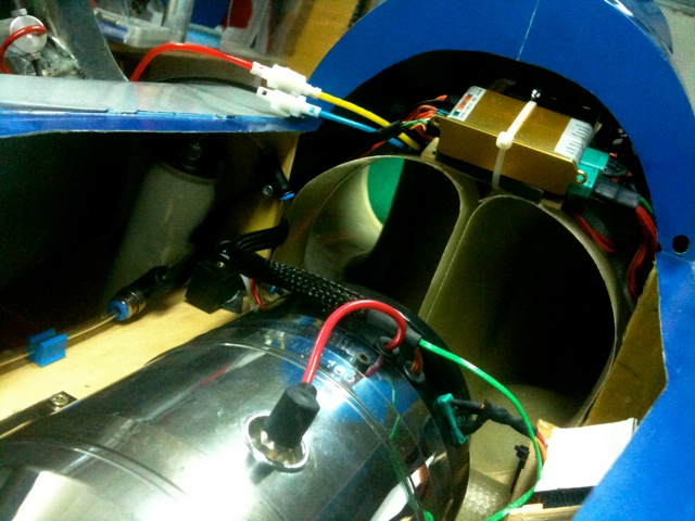

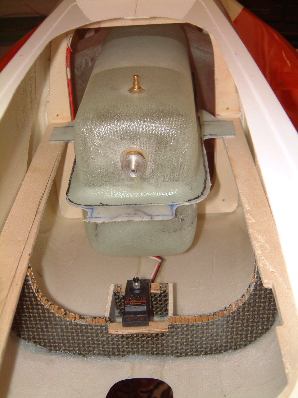

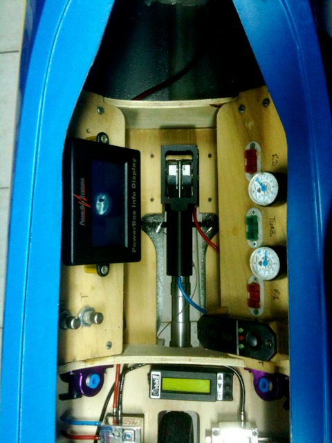

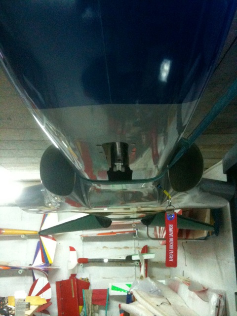

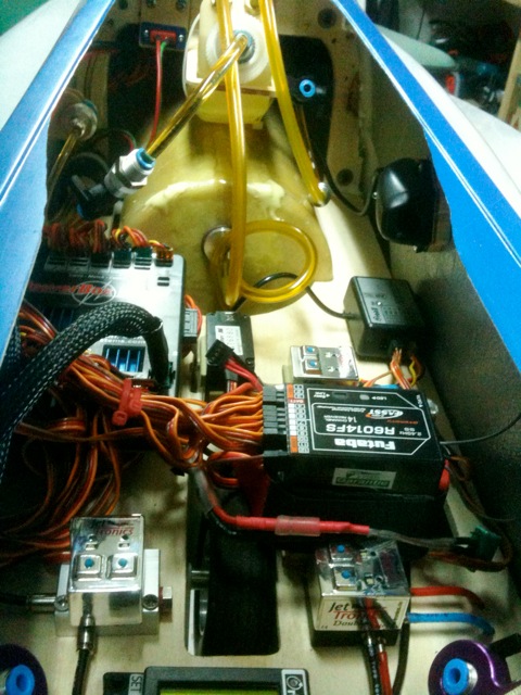

Hi - some pics of my equipment in the AD Super Scorpion.
Note: fuel tank is self made !
Rgegards
Fritz,Switzerland

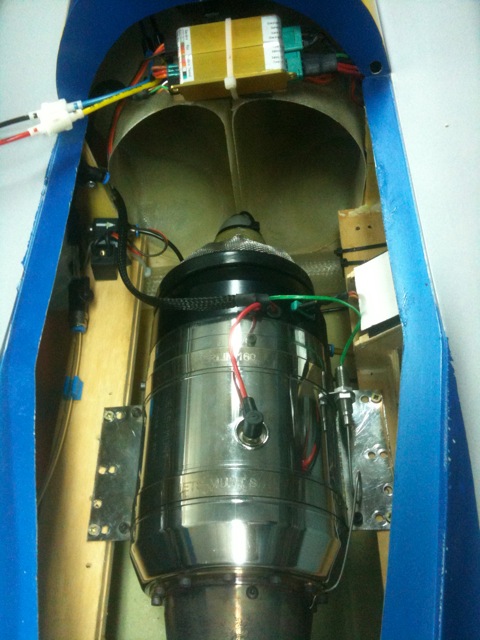

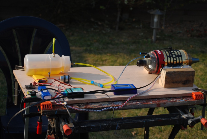

Superb work on the scorpion Heer

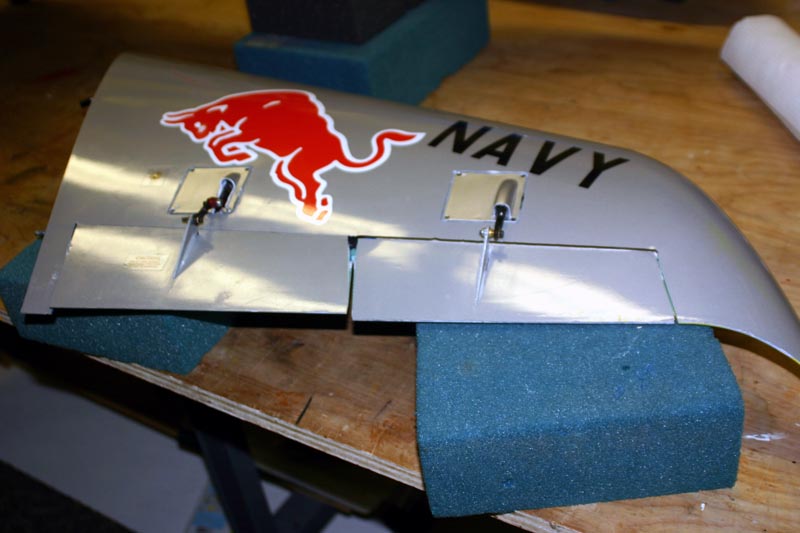

My Scorpion is equipped with a turbine FRANK TURBINE TJ74s, the only problem with this turbine consumption but it grows 165N, then the tank 4Lsera mandatory.
So I do think a little mix of all the edits I see here is that it asks for photos, so you can give me some ideas of low points to change
Eric if you have pictures of your scorpion I'm a buyer.

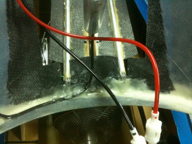

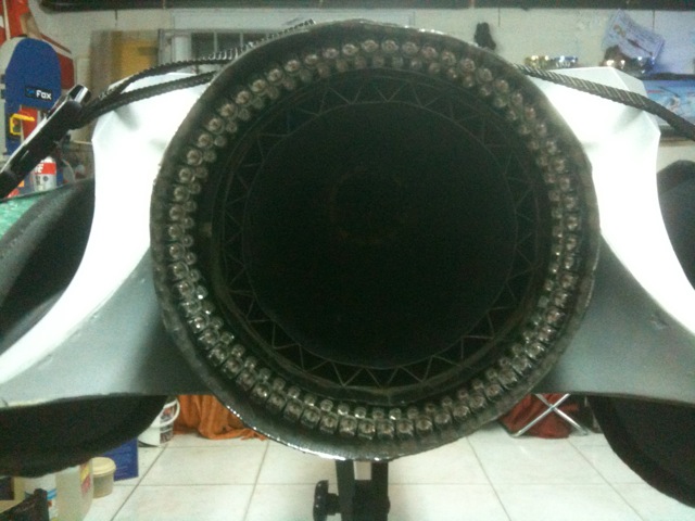

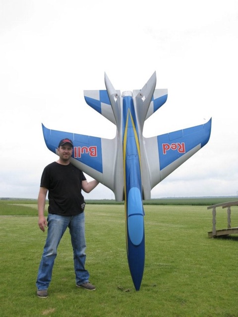

Here is my new After Burner, specially made for Scopions, it is distributed by Aviation Design.
[youtube]http://www.youtube.com/watch?v=jIrS23XJdSI[/youtube]

Wow, those A/B lights are excellent !
[sm=idea.gif] I need some for my Y/A F-15
HERR, any problems having e.c.u. situated above inlet as in your photos, i am installing turbine and find that i would have to extend all connections if e.c.u. is in nose section.
My main concern is the heat in that area , but if it has proved to be ok then will do the same as I do not really wish to extend all connections.
THANKS IN ADVANCE
Old 11-18-2009 | 02:57 PM
Joined: Mar 2003
Posts: 397
From: Uetliburg, SWITZERLAND
@turbokalli
The heat in this area isn't so high that you have to expect problems.
Accumulate over 300 flights without any problems.
Regards
Fritz/Switzerland
