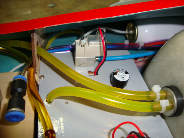

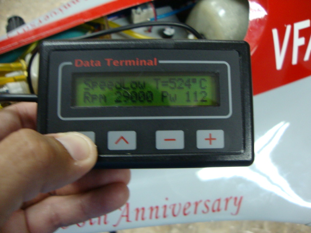

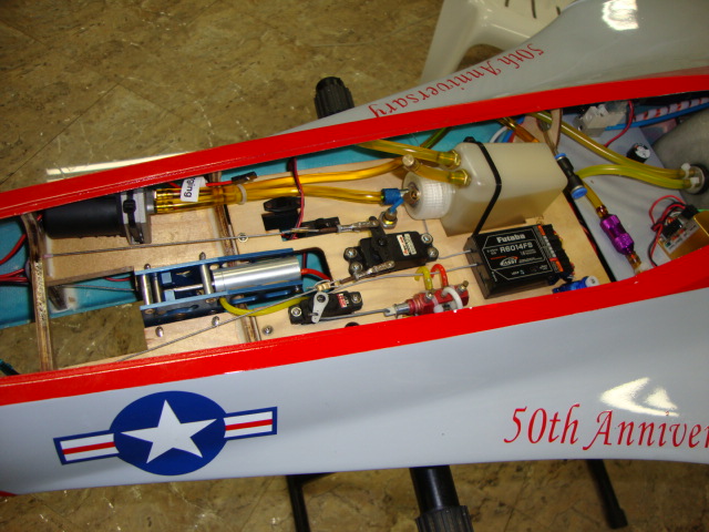

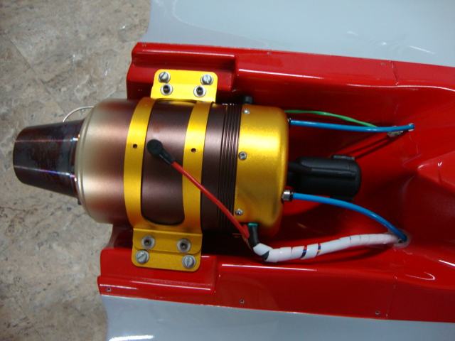

Old 02-01-2010 | 08:48 PM
  #70
Joined: Jan 2005
Posts: 23
From: , BRAZIL
Default RE: Kingtech turbine
Barry, the turbine is in my velox, the serial number is 0908130, the turbine is running, when I start to accelerate it stop and in data appear, SPEEDLOW.
I am putting pics for you.
Fernando

Old 02-02-2010 | 12:03 AM
  #71
JET FX's Avatar
Posts: 1,998
From: Sydney, , AUSTRALIA
ORIGINAL: ftgti
I am with a problem, the turbina working, and when I go to accelerate the turbina stop, in fadec write SPEEDLOW..
What can be?
Fernando
Hi Fernando, Sounds like you may have a possible fuel flow restriction? or air entering fuel system? Be sure that you install wire twist tie wraps around all fuel tube fitting connections. Replace those plastic tie wraps on your fuel tank as they can also let air in and are not recommended, Check that your fuel breather line has no restrictions or kinks, Check that your fuel tank clunk pickup has no restrictions also. Felt clunks are not ideal as they can cause fuel flow restrictions also. Check your fuel pumps flow rate also. It does sound like something straight forward is causing the problem so just going through the process of elimination for now.... Please let us know how you go
Cheers- Marty

Old 02-02-2010 | 06:39 AM
  #73
Jet Doctor's Avatar
Joined: Sep 2003
Posts: 308
From: Johannesburg, SOUTH AFRICA
Hi Fernando
We had a similar problem with the Kingtech, the only way we could solve it was to re-route the rpm pick-up lead away from all the other leads, including servo leads. Worth a try?
Old 02-02-2010 | 08:06 AM
  #74
Joined: Jan 2005
Posts: 23
From: , BRAZIL
I passed the rpm thread on the outside, and it didn't solve...
[youtube]http://www.youtube.com/watch?v=YZKYG9py0RQ[/youtube]
Old 02-02-2010 | 07:40 PM
  #75
marquisvns's Avatar
Joined: Oct 2005
Posts: 1,816
From: Pasadena, CA
Fernando, if you haven't already, please try re-learn RC
Barry
www.kingtechusa.com
