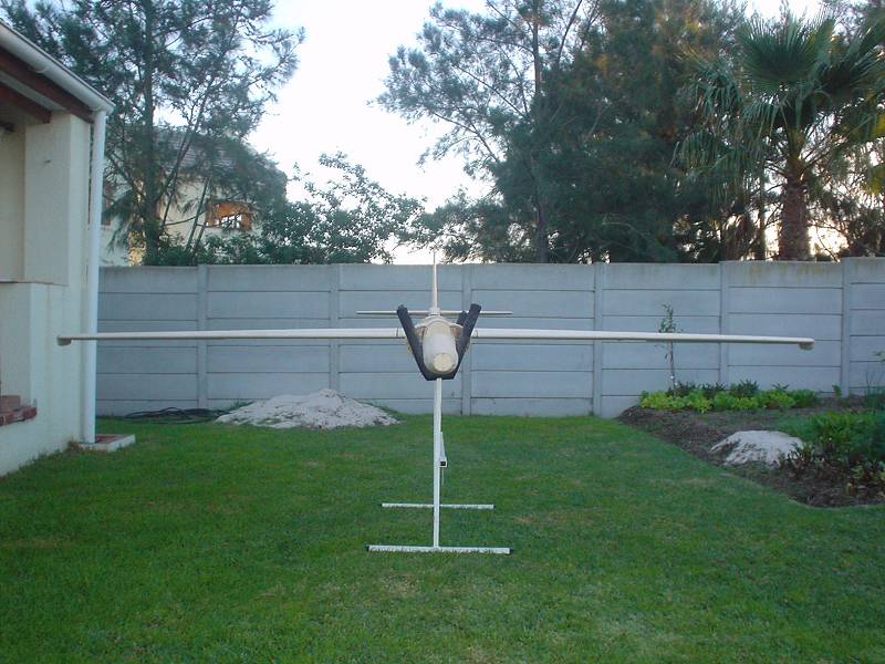

Hi There Fast Mover,
I Started working on this about a year ago now, and have run into a few problems allong the way, but the span on the aircraft is 3.9Meters, fully built up structure, and will be powered By a BVM 96 Fan. I figure if it gets off the ground with this then I will look at putting a Turbine into it. Retract wise It will fit a Trim Aircraft Retract, (since there is Limited space, a turbine will cure this instantly), which Turns through 90 degrees to save space. The Original plan I saw was a Bertella Plan which was lacking in all the detail to say the least, so I scaled the Plan and Redrew half of it to make it more scale based on an Italari Kit, although this U2 will never be a 100% scale, I will have a prototype from which I can build a second, and learn from the mistake of the first, (Foam wings will be the first thin I cut next time), If you would like more pics or info let me know
Regards
Sean

Sean,
Great looking model. I'm not sure a fan will fly that monster. Mine is 11.5 feet and the guys who've flown it say it needs a P-80 or better. The real U-2 takes off at a 60 degree angle. Just make sure you've got a long runway for the test flight. The U-2 drivers I work with say it does take kindly to stalls.[X(]

Hi Mike,
Thus far as you see the aircraft plus the fan, servos retracts, wheels, tanks etc... the all up weight is 11.5lbs, there is really no weight to the fuselage at all everything I have done to this aircraft is basically, carbon fibre strengthened skin of 3mm Balsa, the wings contain most of the weight. I expect the aircraft to be below 17lbs once all together. The Horizontal stab should help out slightly, as I am testing my luck as the fullsize has a inverted cross section. Your Fuz looks a lot more roomy then mine I am guessing, this is because the older version was a shorter wingspan, this is a TR-1 or U-2R version.
Is there anyone building U-2 from Scratch that has a plan in any CAD format? I would
Regards
Sean

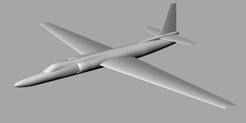

Default RE: U2 Spyplane
I have the U-2R or TR-1 in a CAD file. I will work something out with you if that is what you want. I have plans to CNC the plugs out later this year but I can't start till I finish my other project. It is drawn in at full scale but it can be change with one button. Let me know, I will help YA ! That's You in TEXAS ! Butch [email protected]
