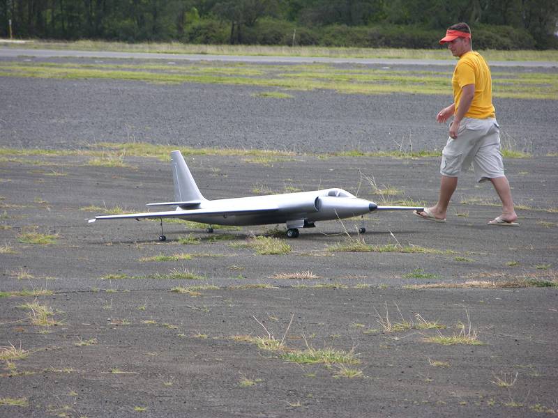

Yes, the U-2 Flew for a few brief moments, lifting off by itself, however it had a serious lack of power! I took off in a slight cross wind, and as soon as the wheels left the deck it started to drift to the right, the problem was with such a high aspect ratio wing as soon as you use the ailerons with not enough speed, well the wing will stall. The rudder was totally ineffective at take off speed, so I couldn't really correct to many spectators in the way, needless to say I broke the nose clean off, when the wing stalled, I have repaired it already, and will test fly it as a slope soarer at the end of November, after that I will upgrade to a 12kg turbine (more then enough power). I will post some picks tomorrow at work

First flight: check
crosswind: check +
spectators: check +
crash: check
Ya gotta wait for perfect conditions with a bird like this. Once you get the controls dialed in and comfortable you could be less strict about conditions. Not trying to put you down or embarass you here, just something to learn from. Others who have tried the U-2 have been bitten by the cross wind and tip stall. Most that I've seen, actually. Much like a scale sailplane, you get too slow and you'll have no control. Things to keep in mind; ; some flaps will help avoid tip stall, some reflex in the ailerons will too. At least 2:1 or 3:1 differential in the ailerons is needed. More travel in the rudder than looks natural. My personal preference with sailplanes, scale or not, is to put a aileron/rudder mix on the landing mode/landing gear switch so you always get rudder mix when close to the ground.

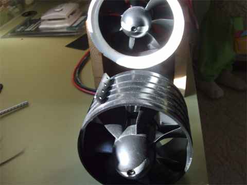

wsmalley, I had been intending to use a turbine in mine, but having left it this long am now considering going the e-power route too. We ought to compare notes. I'm thinking about doing a homebrew conversion of a ram-tech or dynamax fan, since I've got them in a box somewhere and some good, affordable motors are coming out. Shouldn't need too much power/thrust. Should be able to get 10-12 lb thrust out af a conversion - which ought to be plenty for my plane around 20-22 lbs.

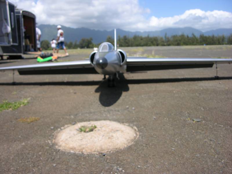

I second JOHNG's remarks. The U-2 is no crosswind airplane. Mine is built from the Kranz kit and I only have a couple flights thus far due to the trade winds in Hawaii (12-18 knots most days). The first fight was harry due to aft CG. The second was much better. Flew like a big trainer until landing the bird gets pitch sensitive when you lower the flaps. A no flap landing sure eats up the runway and you have to stall the thing six inches off the ground. Still sorting that out

I don't know about the semi-minor Damage, there are many stress fractures on the Airframe being Fully Built, but it's nothing that CA can't fix
. The One wing has quite a bad crack [&o]in it but none of the main Spars are damaged, But once again it should be easy to fix. You can see this in the one Photo after the spectacular event had happened. Also I included some pic's after the nose has been rebuilt.
JohnG', I did mention a slight cross wind, it was slight, I backed out of two Maidens the previous day because of gusting winds[8D], when I attempted this it was about 2kph, from the south west, this was a 08H30. The amount of runway used to get airborne was about 180-200meter's, we where using a full Size Taxi way. I did say through it all I will not force the aircraft off the Deck, which I didn't, it did everything by itself and was flying just dandy till the wind, you guessed it started gusting gently. By this time I was 2/3rdsdown the Runway, the Rudder has about 40mm of throw so that should be ample Rudder, and for the size of the Aircraft it should be fine. I'm guessing though with the lack of airspeed it becomes a Titanic and Iceberg in situation Rudder becomes too small and non-effective
As for spectators, well I guess that's what happens when you arrive at a Fly-in with a totally unique aircraft you have loads of Pilots wanting to see, they where all well behind the spectator line, which was +/-80meters away. This all didn't happen fast there was time for everything, even the cart wheel looked as if it was in Slow motion. I had to force the turn not only because I was halfway to the spectators just to the right of the Taxi way but because of the JET A-1 Tanks and refueling station (For Full Size aircraft) right in-front of my "new Flight Line". Have a look at the one Photo, The White area is the Runway, the Red Area was the Obstacles after drifting, the Yellow area Which I was aiming for during the Drifting which Would have been safe had the Aircraft built up enough Airspeed to prevent stalling the wing. Altitude at this time was about 2.5meters above the deck.
For first Flights on any of my jets, (actually any of my aircraft) I don't Dial in any Dual Rates, with round 45% exponential, the U-2 Has 30mm down and unlimited up Travel on the Ailerons, (Flaps can do about 120 degrees if not limited) so should there have been enough airspeed I could have corrected the drifting to the right, but Knowing that this will stall the wing, I didn't touch it unless I really really had to, unfortunate I really had too. What I should have done was kill the power (or the Lack thereof) and forced it on to the deck. But then hindsight is also an exact Science
I think the Aircraft would have flown better into a head wind but, at Oudshoorn the Taxiway, in the all years I have been going there I have yet to see a head wind on the taxi way.
The original Idea was to get it working on the BVM96 (15lbs Thrust +/- using a BVM T-33 Ducting set up) and then put a BVM EVF (Same Set-up 16.5lbs thrust +/- with 7500mah with Saddle Pack) in the aircraft, but at 22lbs with Fuel (The Down side of a 100% built up jet of this size), I wouldn't even put in a EVF now, Don't Risk it, it's not really worth it. I will go for 12kg turbine 120N a Jetcat or ModelMechanic's, 26lbs of thrust would be more then enough. I have seen a few Full sized U-2's fly and on take-off they display an impressive amount of Acceleration, speed and power. Something I think every Model U-2 Should have for Take off.

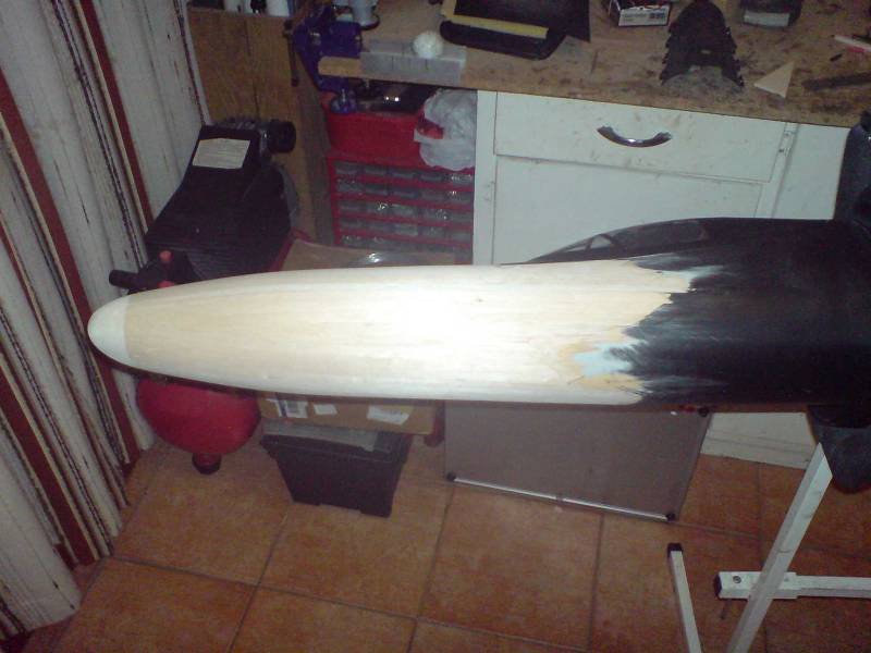

Great looking bird, maybe you could post some pics of your gear/pogos or other details. I always like to learn how others approach building. I think I read the fullsize could only turn at 15 degrees, called it the 'coffin corner', I believe. Imagine a big model will pretty much follow the same parameters. The turbine would be the perfect solution, they've come so far along. I had an old JPX 260P I thought about but it was too big with the fuel tank to try and 'shoehorn' in. John: I'm trying a 4 1/2" fan with a 700kv motor and 100A ESC I got from HobbyCity in Hong Kong. Of course, a Neu or comp would be the best. They have a lot of fans, quite cheap and a pretty big selection of motors, and have some good data on different configurations they've tried. I modified one of the motors with cooling holes, ceramic bearings and JB Weld'ed the windings. I've only run it in a test stand on 33v and easily got 5 1/2 lbs with my 3 little batteries. I just don't have the bucks to put in the eTurbax rig. I have a Turbax/Rossi .81 combo, but hate the sound of those, and think the fans are comparable.

I'd like to see more from both Sean and I-nav about their flap systems. I-nav's pics look like they have 5 or 6 hinge points - just by the shadow in the hinge gap. Are they slotted flaps or plain?
The plane I bought had the wings skinned by the previous owner. I need to get them on a long flat table, but I don't think they have any washout. I do know they were built with scale airfoils, which is unfortunate. I may build new wings just to make sure everything is as it should be. I couldn't find a data sheet with washout data, but photos on the web look like there's 3-5 deg of washout there.

My wing has zero washout, flies well. I put a couple of degrees of reflex in the ailerons. Flaps are plain flaps with the Robart large hinge points set at 45 degrees ___/\_______ so they have a fowler effect. I'm using one 8611 servo but it really could use two for extra stiffness. The each flap is nearly 3 feet span so if the flap isn't stiff you need more servos. Like I said, the airplane gets a little unstabile in pitch when I lower the flaps so I'm going to add nose weight and elevator flap mixing on the next flight. Gear is a Robart 630 in front and an old Spring Air unit in the rear.
