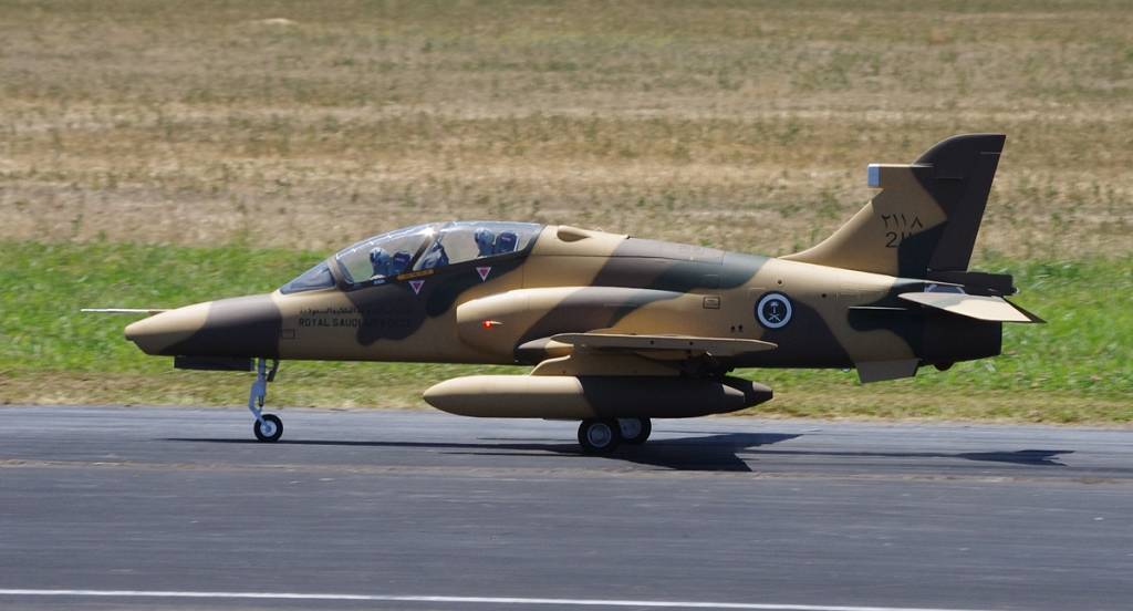

Today I weighed my airplane in different configurations:
Skymaster Hawk 100 Saudi Scheme
The equipment I used is as follows:
Power Box Royal SRS
8x Jr 8911 servos
5x Jetronic valves
DreamWorks sequencer
Detail for scale lights
2x Duralite 5200 mah batts
1x Duralite 2500 mah bat for lights and smoke
2x 16oz fortitude tanks for smoke system
Jet Central smoke pump and solenoid
Jet Central Rhino
BVM pipe for SkyMaster Hawk
And the normal airlines and fittings
Servo Extensions are all made to length
SkyMaster 1/5 scale pilots no legs
Duralite 3800mah bat for ECU
The weights were as follows:
1. RTF full of fuel and fully armored with:
Wing drop tanks
Center tank
2x Missiles
=51.9 Lbs.
2. RTF no wing tanks no belly tank and no smoke tanks
= 50.5 Lbs.
3. RTF no wing tanks no belly tank only fuel in UAT and Hopper tank
= 43.8 Lbs.
4 Same as #3 but full of fuel
= 49.3 Lbs.
This being my first Jet build, I have no Idea if these weights are with in range for this model and power configuration, I would appreciate some input ref. power to weight ratio on this model and If I am close to other builds similar to mine.
Thanks in Advance
J.C. Alvarez
Old 07-25-2013 | 09:07 PM
  #484
dubd's Avatar
Joined: Aug 2007
Posts: 4,313
From: Bay Area, CA
Default RE: Large Skymaster Hawk build
Never weighed mine and my set-up is similar. Low to mid 40s is what I expected it to weigh.
Some pics from last Sat.
ID:	1903984   Click image for larger version

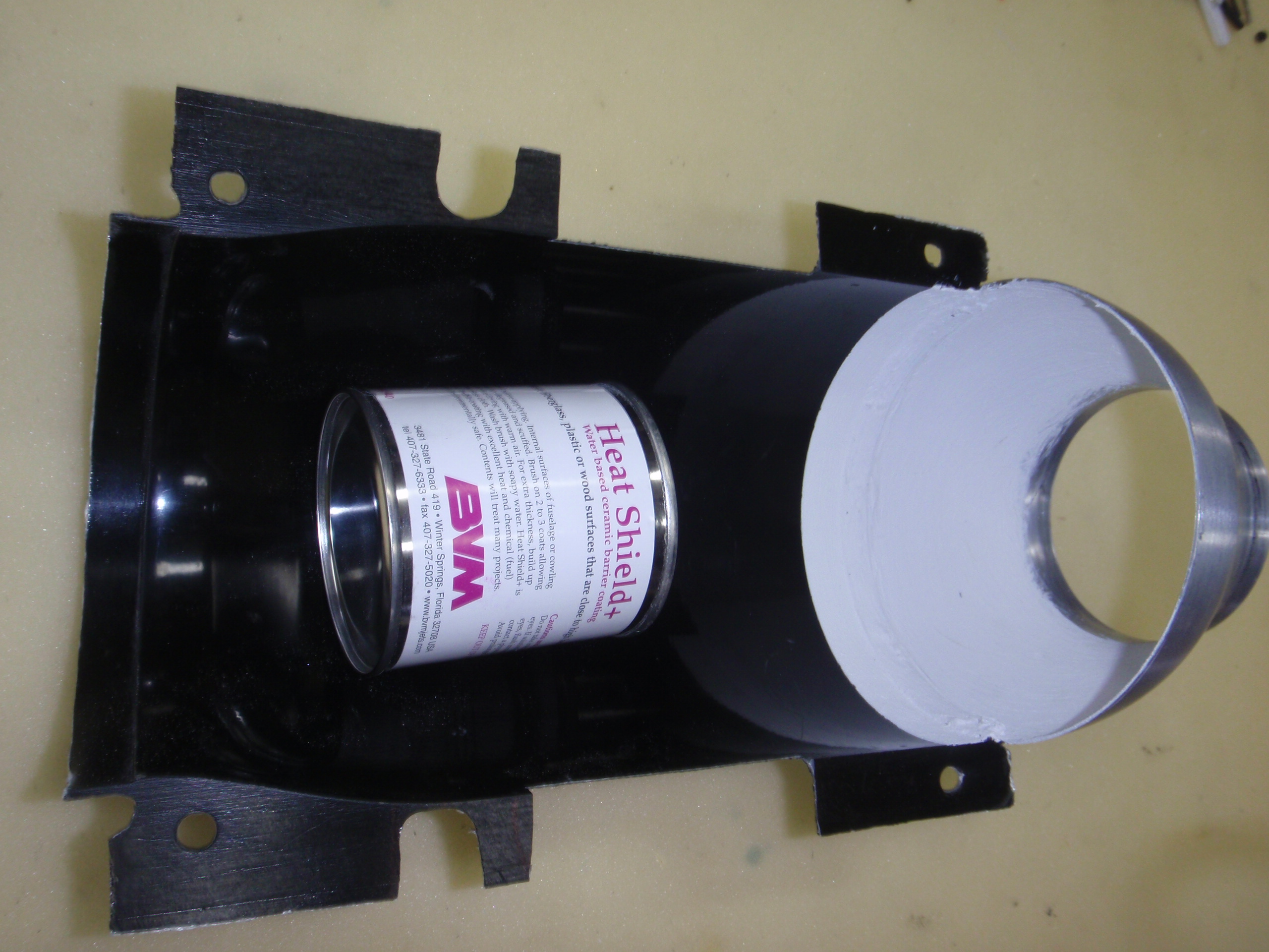

Can you guys post a picture of your bypass and bell mouth installations?
I did mine like my raptor which had the bypass ending at the tailcone with a 0.75" gap to the bell mouth.
Unfortunately the BV upgrade book covers the usual bypass install and my hawk came with the bell mouth.
I have 11 flights on it now, no issues so far.
thanks
dave

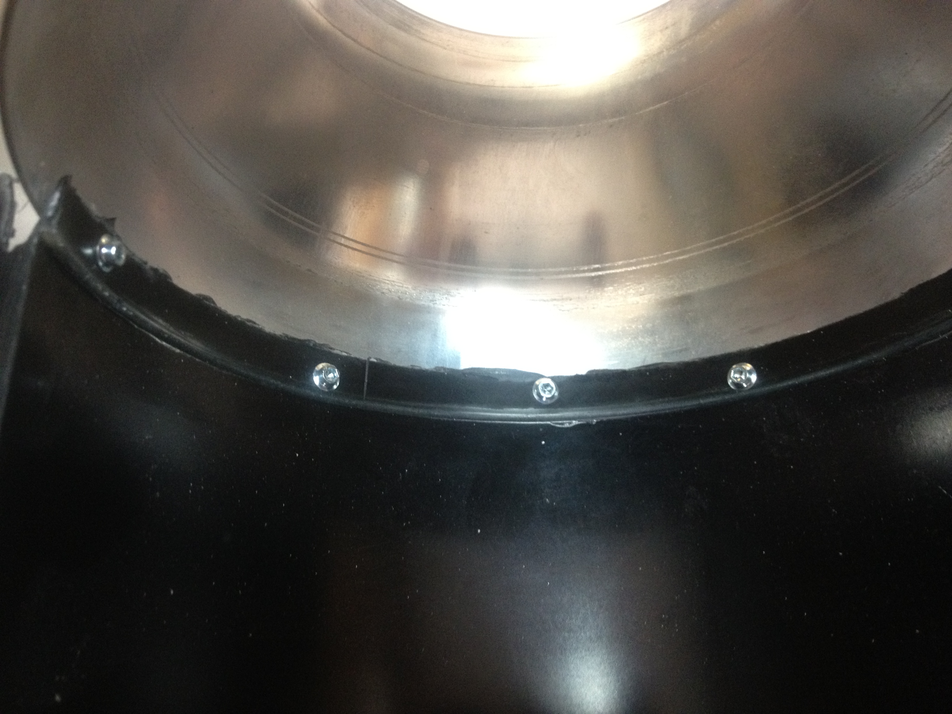

Old 08-12-2013 | 05:09 PM
  #493
Joined: Dec 2008
Posts: 249
From: CORAL GABLES, FL
I don't know if this is what you are looking for Dave, this is how I did my bypass to tail cone
J.C.

Old 08-12-2013 | 06:40 PM
  #494
My Feedback: (15)
Joined: May 2003
Posts: 2,488
From: rochester, MN
thanks for taking the time to post. How warm does the fuse get with this setup at the end of the flight?
Mine is different. I have a fully bypassed inlet until the turbine tailcone, then a space for 0.75" to the open bell mouth. This was the way my F22 worked and it ran well. Nobody has spelled out the bypass and bell mouth instructions for this jet since they switched to the bell mouth so I went as I described. Runs fine but I could probably use a little more air through the fuse for cooling aside from the gear doors and the airbrake. I opened the vents in the aft hatch (fore and aft) too - seems to help a bit.
Dave
