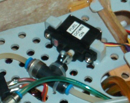

Me & my friends put them after the pump. What we do is make them servo driven as Oz rules require
a manual & radio operated (independent of the engine electronics) shut off, we hook them up to the failsafe.
With this setup you can use just one valve. - John.
