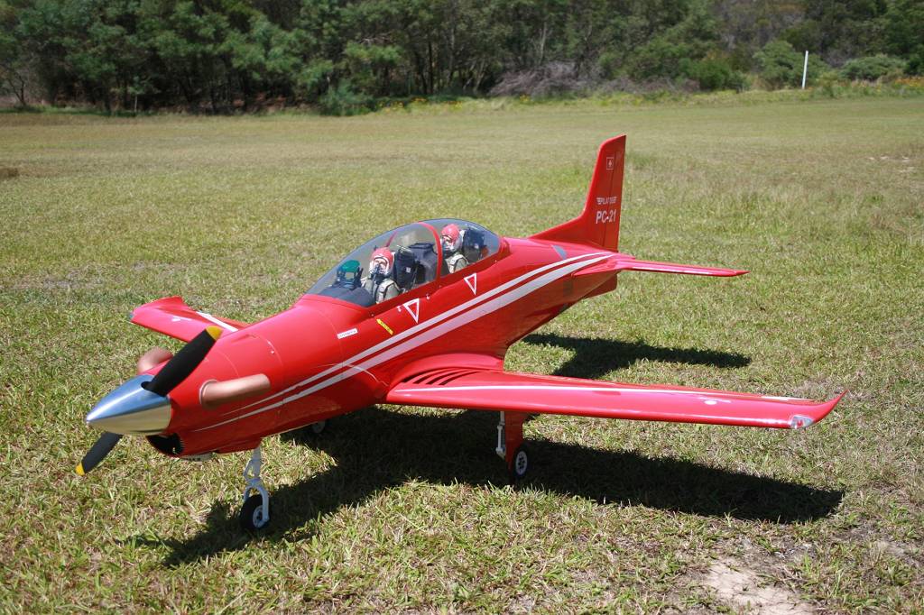

What better than a scale jet trainer.....
Just finishing this one myself for sport flying, its a 1/5 scale KMP ARF PC-21 scale jet trainer, AUW will be approx 16 lb. I have made a few hardware and linkage upgrades over the stock version as I wanted to power it with a larger Moki 2.1 for some serious "jet like" performance. The recommended power is actually 1.50- 1.80 four strokes. I reckon the KMP PC-21 may prove to be an ideal stepping stone for many coming into jets looking to get some stick time on a prop model that finally offers some real fast jet similarities...
http://www.kmp.ca/product_info.php?c...4bf7396b848898
Heres a cool video of the PC-21 with a performance electric power setup. The potential as a serious "prop" jet trainer is well demonstrated...
[youtube]http://www.youtube.com/watch?v=cjRPe_8NNjA[/youtube]
Cheers- Marty

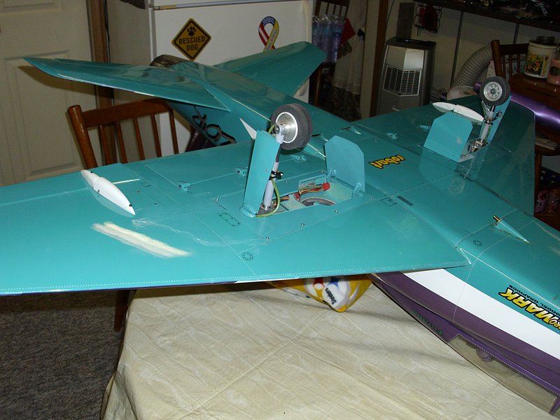

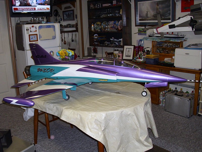

So I got the jet and its well mostly junk, definitely not anywhere near RTFand carrying a turbine! It in fact would be DANGEROUSto me and spectators to do so.Ghetto mods galore, I was fooled by the pretty paint and pictures strategically not showing damage and shoddy work, this is gonna take a lot of time and money to fix to make worthy to carry a turbine. The previous owner who never flew it is saying I'm crazy and a bad guy, no wonder he never put a turbine into this thing and flew it after owning it for over a year. He's crying I didn't call him before posting him a poor rating, I didn't want to call him after fuming over it as I went deeper and deeper over it.
You should see how many types of bolts are holding on the landing gear break away panels, a socket head here, and flat there and cracked thing there. amazing he called it, RTF. The rear tail feather is cracked and please tell me you see this as holding up during one flight, even after a fix, it is very structurally damaged and suspect under hard flying which I 100% intend to do. It's a joke man, Looks like it was built beautiful and then gotten a hold of by a yahoo and fubared and then rebuilt to their 'gold standard' omg, what a joke.
Pictures are in the next post, you make your decision on how you would feel of this 'beautiful' jet and plunking down $1500 for it, then being told its 'ready to fly'. Lol, how would u feel about putting your $2K+turbine in this thing!I expected to do some minor work, but what the heck, I have foamies that I'd rather put my turbine on than this.

Hmm, looks like a junk drawer extravaganza
Sweet, I could see this tail feather flying off in flight.
Check out that quality work right there, WOW
Cool, non-matching wheels, I thought only Honda rice burners had that style!
There is more, but I didn't feel like uploading them all, this was enough to get me nice and fed up. I wouldn't of have had to post this if the seller would've just manned up and taken his poor rating like he deserved without bashing me like I don't know what I'm talking about. Get lost buddy, enjoy that new turbine of yours!

The crack sucks, but it seems to me that brass tube soldered to the strut like that is how it came from CAI, I think my old Razor and my Raptor are like that. As for the differences in bolts, change them, use the carbon flex plates or make new ones out of 1/4" plywood, the plastic CAI ones suck to begin with. Before i sold my Razor I made some gear plates for the new owner out of 1/4 ply with carbon laminated to one surface. They'll hold up better than the plastic ones.
As for the hatches and such, both my razor and raptor have hatches that over the years have bulged, gear doors don't fit anymore, it's not the builders fault, the stupid parts just warp over time, how that happens when they're fiberglass I don't know, although all the servo covers are plastic, go figure.
It looks like your Razor must have been the Sport version with the balsa/foam wing and tail, mine was the all composite version which is much stronger, but also heavier. I don't know how heavy yours is, but it seems to me the razor with engine was around 23 or 24lbs RTF. It's not a light airplane to start with.
I sold mine for $2000 with an AMT Mercury!
Of course you've only posted a few pictures of yours, but from what I see, it doesn't look unusable, maybe a little slapped back together, but like I say, I think the struts were done like that from CAI, and the glennis wheels, well, they look like crap on my Raptor and on my old Razor too. I was never a fan of those wheels.
As for gear flex plates, if you want new carbon fiber ones, Dan at Details for Scale I believe has them.

I looked at my Raptor today and the gear are the same. The seller said in his ad that it was new struts so they've obviously soldered the brass tube on themselves, but honestly, they look better than my original CAI ones, the only difference is when they came from CAI they were painted so they look prettier.
As for whatever other damage is on your plane, well, no comments can be made without seeing pictures but mismatched bolts don't make it a piece of crap, it's just bolts. I'd be interested to see other pictures of it.
