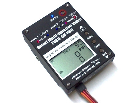

I have a Airpower EV5D-5U-PRO-ST that not showing pressure in the display.
The valve works perfect in manual mode, but since the pressure show 0 PSI the failsafe steps inn so I can’t use it with my transmitter.
The breaks works perfect with my transmitter, even with pressure showing 0 PSI
Look at picture; that is what my display shows with pressure in my air tanks.
Is there any fault with my valve? Or am I missing something?

The pressure sensor is bad. It needs to be sent in for a replacement.

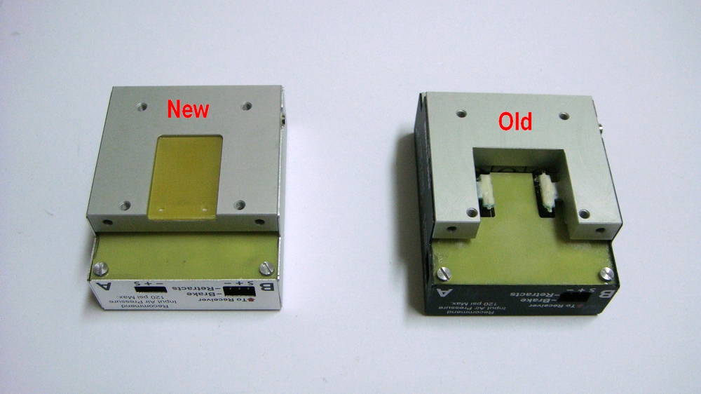

The old version digital pressure sensor on the EV5 series valves have shown more failures than we where comfortable with. Airpower has changed manufacturers of this device and the new supplier has proven to produce a much more reliable piece. Unfortunately, when the digital sensor has failed, the only option is to return the valve for a replacement. This is not something the end user, nor Dreamworks can repair. If your sensor has failed, please contact your supplier for a replacement valve.
Current valve Version 4.0 contains this new hardware in addition to the ability to now view on board battery voltage. The new hardware is easily identified by looking at the bottom of the EV5U-PRO Valve. See image below for clarification.
Todd
