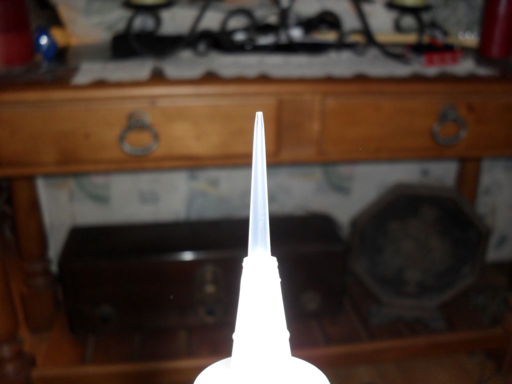

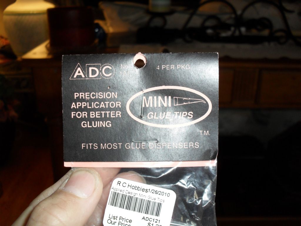

I use oderless zap and make spot tacks all around the canopy. Then I use Formula 560 with a modified tip from ADC and fill in the rest all the way around.
