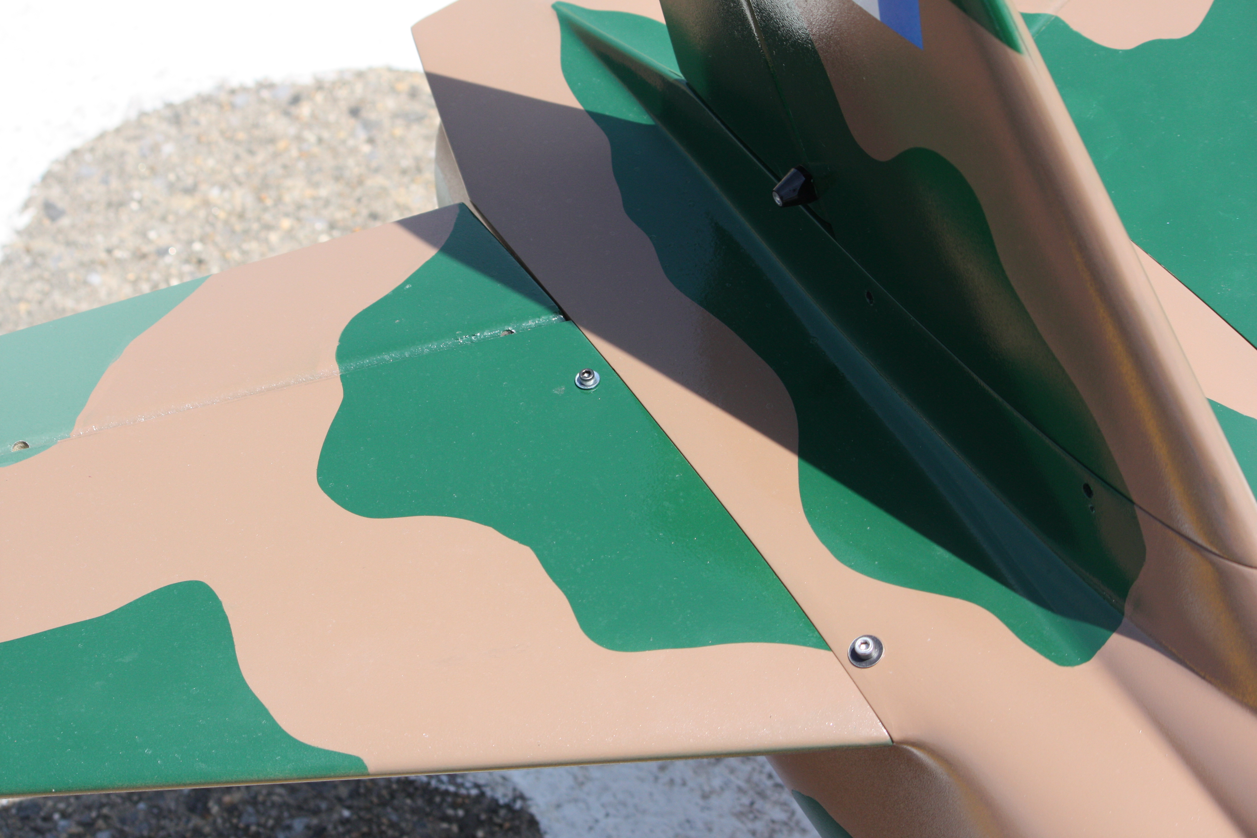

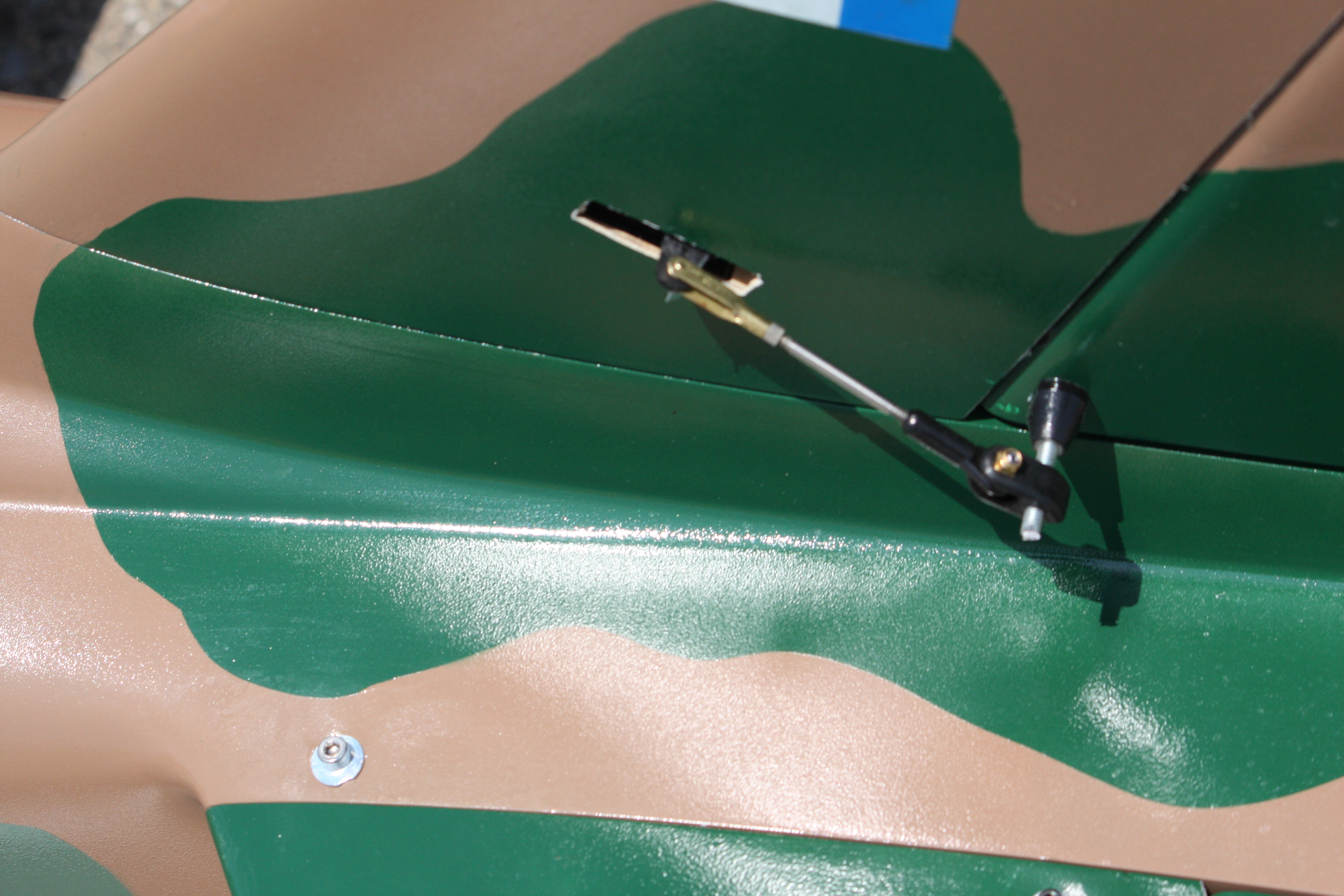

this is what you need......67 flights and more to come

Ruizmilton, what is FRP? Is that what came with the Dragon kit? If so, are you saying that the horns that came with it are inadequate?
Jetsflying, I assume that you have a block of wood in the bottom of the rudder otherwise your setup would crush the rudder when you tighten it, right?

yes but the wood was there...........

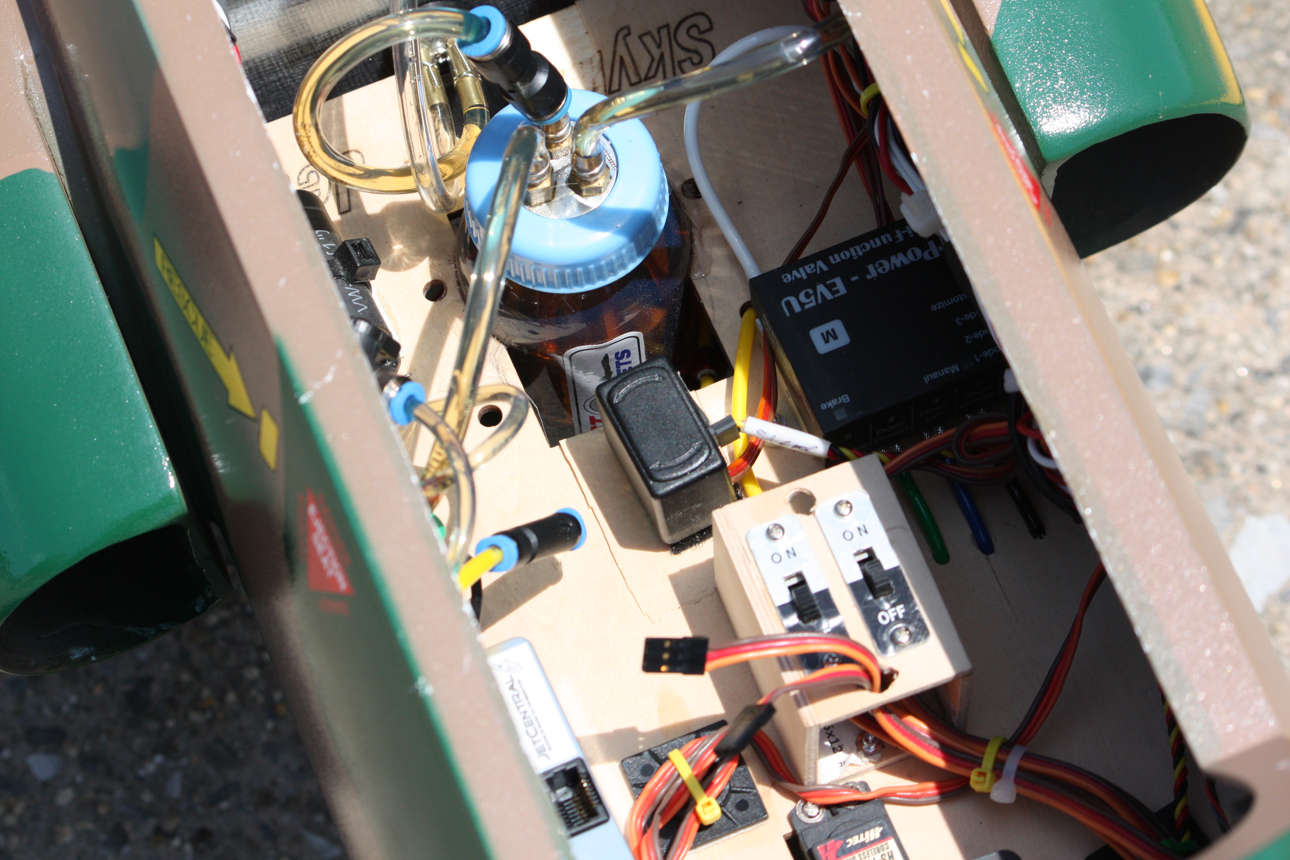

Can anyone post pictures of the dragon's inside. Where is everyone mounting the batteries to balance with a p160, rhino etc. ?

you need alot of weight up front so get hevy bat.......im using 2 3600 mha nicads
