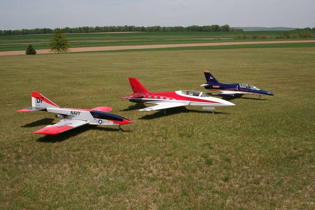

Some more pictures from yesterday, what a nice day for flying it was !
Doane's FB L-39 / K-80
My dad's Reaction 54 / p-60
Dragon / p-160

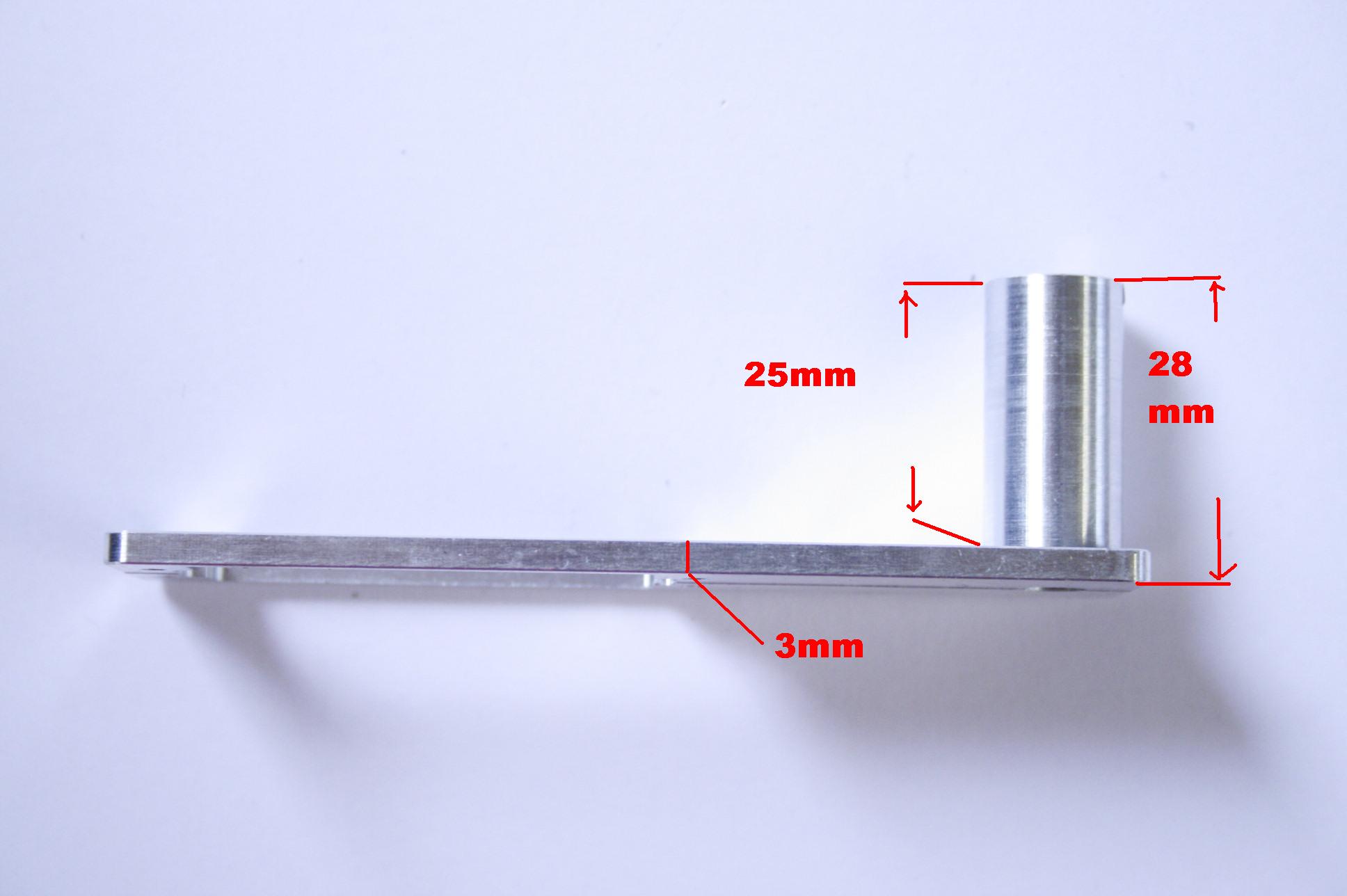

we made also a version to suit all AIrpower 210-212 series that have 1/2 inch pickup

Hello Digitech:
You can put a scale draw of this piece for see if is suitable for another landing gears ?
Or which is the diameter of that "strut".
Many thanks in advance.
Carlos.

here you go
