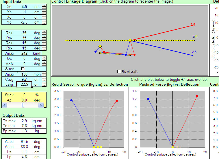

Oc -22.5 (this says the flap will be half down when the servo is at centre, this is the crucial bit that was missing before, a value of 0 says flap is horizontal when servo is at centre, so flap will travel up and down from horizontal, whereas we want up and down from half-way down!)
And now the diagram is exactly what we expect to see.
Harry

It's astonishing what values are calculated, for example it says that at 150mph the ailerons on my F-86 need a servo torque of, wait for it, 0.7kgcm !!
Could you post the sheet here ?
#29
Oh I see: extremely small flight control angular deflection ( 7 degrees ) with extremely big control horn ( 3,3 cm or nearly 1/2 of the control chord )
Then it makes sense.

You're right Harry. This sentence is extremely badly written/confusing. What I was meaning is that on such a setup, the servo slop becomes significant to the control travel. That is not because of the control link geometry but because of the aero dynamical configuration/ ATV.
7 degrees of deflection is very small plus the servo is only used at +-35 ° of deflection ( 60% ATV ? ). So the slop will be more significant compared to the total servo angular deflection used.
However, maximizing the mechanical advantage WILL minimize the influence of the servo slop, which is what you have done in this case ( de-amplify the servo slop at the control tip ).
I am still surprised as well to see such a small torque value required. I guess that on this servo power segment, the critical factor to choose it would be the servo reliability...
Did you manage to find a servo arm that gives you 0,7 cm of leverage ?

I find those very low values hard to believe. So I started by doing the same sums with a formula published in the Multiplex catalogue which calculates the torque exerted by the control surface, the figure for Tc in the spreadsheet. It comes out with different numbers but close enough, and and slightly lower than the spreadsheet so the spreadsheet doesn't seem to be undercalculating Tc. Multiplex says Tc = length in cm * chord in cm^2 * Vm/s ^2 * degrees deflection/2000000, and this is the same calculation done in column AE of the spreadsheet other than it using a different approximation factor hence the slight difference in results. Not enough difference to bother about.
But if we carry on with the spreadsheet it generates some odd numbers that I can't explain. Take the example of the aileron in my post above. Tc is max 5.9kgcm, which it operates on the pushrod at a radius of 3cm, so the force applied to the pushrod by the aileron is 5.9/3 = 1.9kg, yet the spreadsheet says Fp max is 0.8kg. It then says that the pushrod is connected to the servo at a radius of 0.8cm, so the servo torque required will be 0.8*0.8 = 0.64kgcm, yet the spreadsheet reports Ts max as 1.4kgcm. Using my calculation, if Tc max is 5.9kgcm which I will accept as being good enough, then on a pushrod at radius 3cm from C and 0.8cm from S, pushrod force is 1.9kg and servo torque is 1.5kg. This is very close to the spreadsheet's Ts max of 1.4kg, but arrived at via a very different mid point, the pushrod force.
The rudder value is most odd. It shows Fp as 1.3kgcm, which at a servo radius of 1.1cm requires torque of 1.3*1.1 = 1.43 yet the spreadsheet says Ts is 2.9. Since it reports Tc as 7.6kgcm, at a horn radius of 2.5cm I would expect Fp should be 3kg, not the mere 1.3kg it reports. 3kg force on the servo radius of 1.1cm requires torque of 3.3kgcm, the spreadsheet result is 2.9kgcm.
I can see that if the pushrod is not at 90 degrees to the control surface horn then the force on the pushrod will be less than torque/radius but the difference in the above examples will be small and nowhere near enough to account for the difference the spreadsheet shows. Can anyone explain why the Tc values don't compute directly to the Fp values, and the Fp values don't compute to the Ts values?
Harry
Harry

I've been thinking about the above, and might have the answer.
The pushrod is not at 90 degrees to the control horn when it matters. Take the example of the aileron above, the pushod may be at 90 degrees to the horn when the control surface is at neutral, but at that time the control is not generating any torque. The control generates max torque when at max deflection, at which time due to rotation of the horn the pushrod is no longer at 90 degrees to the horn. Because it is no longer aligned with the force vector generated by the torque, the force applied to the pushrod will be in the order of cosine of the angle off from the tangent to the horn, so the force on the pushrod will drop as the angle changes away from 90 degrees. Similarly the force applied at the servo arm to convert into torque applied at the servo will be reduced by its angle off the tangent to the radius of the arm, I can't be bothered to work out if sine or cosine but either way it will be well reduced since as you can see the servo arm rotates in the region of 40 degrees. But that works in reverse too, so the servo will need much more torque to be able to generate the same force on the pushrod when it is rotated away from 90 degrees to the pushrod, compared to when it is at 90 degrees
If you are struggling to imagine all that, imagine taking things to the limit. Imagine the control surface deflects 90 degrees, then so does its control horn. At that point no matter how much torque the control exerts on the horn, it has no fore or aft movement so it can't exert a gnat's wotsit of fore and aft force on the pushrod. When the control is only partially rotated, the force the horn can apply to the pushrod is somewhere between full force and that zero force. The same applies when it reaches the servo arm, if the servo had rotated as far as 90 degrees then you could apply all the force in the world but it won't make the servo rotate and the servo will need zero power to resist it - you would need a strong mounting and servo case, but you couldn't make it turn! With servo typically rotating 40 degrees or more, the translation of pushrod force into torque to try to turn the servo is hugely reduced, and that reverses in that the servo needs extra torque to apply a force since its max force is at 90 degrees to the arm and has reduced force at other angles.
That would explain why the spreadsheet gets lower values for Fp than my simple calculation that ignored the angles, and why the low Fp converted into a much higher servo torque requirement.
H
H

#48
OK Orlando,
I've loaded the worksheet with your data.
Everything pretty much depends on what kind of servo travel you are using.
With a +- 30 degrees travel you need a servo arm of 5 cm and the maximum torque required is 190 oz-in:
With a +- 40 degrees travel you need a servo arm of 3,7 cm and the maximum torque required is 133 oz-in:

#50
As you can see on the example above, it is very important to use as much of the servo travel as possible. Increasing the travel by 10 degrees here drops the torque requirements by 60 oz-in.
Also note that the simulation was done at 60 mph. Increasing the extension speed will dramatically increase the load on the control surface.
Finally I have edited the link to the imperial units file ( the .xls extension was missing in the link ).
