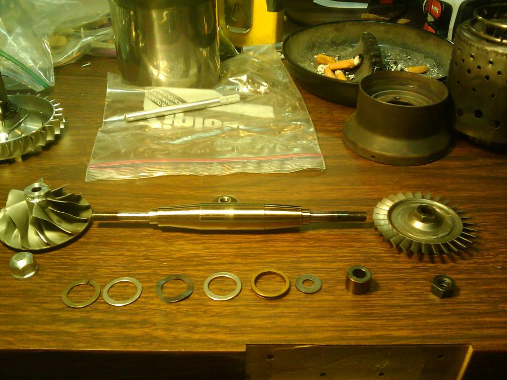

Old 04-05-2010 | 08:52 PM
sKrUb_69's Avatar
Joined: Nov 2005
Posts: 100
From: Conroe, TX
Default RE: AMT 180 PROBLEMS
ok here is a pic of all the parts minus the bearings.... going to order them in a few weeks...
Old 04-05-2010 | 09:20 PM
Ruizmilton's Avatar
My Feedback: (29)
Joined: Dec 2004
Posts: 819
Received 10 Likes on 10 Posts
From: Carolina, PUERTO RICO (USA)
Chris:
You have parts I'm not familiar with, suggest you post your request on the turbine clinic,
1.you have a spacer that's the size of the external diameter of a bearing, wouldn't be able to tell if it goes front or rear
2. What is the part behind the axle?
3. which side of the axle is the rear? I assume the right side since it shows signs of being exposed to high heat.
4. I do not know what is the small washer used for.
5. Which is the compressor spacer?

Chris:
I just recalled that the spacer the diameter of a bearing is the lubrication ring, it goes at the front, but to be honest, I do not recall if it goes before or after the spacer washers; does the small washer have a step on the inside diameter? if it does, it is the compressor spacer, it goes in after the front bearing, before the compressor...If you do not get any help, let me know, I could disassemble my 280 over the weekend. For balancing you can go to an auto turbocharger shop, if they have a dynamic balancer they can do it for you, but you need to specify exactly where they can remove material from at the compressor and turbine wheels, and that the assembly needs to be balanced to less than one gram after it is assembled(complete turbine core minus external cover/compressor cover), if they won't do it this way it won't work...

Old 04-07-2010 | 12:28 AM
My Feedback: (26)
Joined: Mar 2005
Posts: 22
From: Millstone, NJ
So do you no how to put the AMT 180 back togeather? I just did mine you have to have that turbine wheel balanced wright I had it done then I put the rest back togeather. you have to go threw the front of the defuser with the two washers then the tampered washer then the lubrication ring then the bearing and the small washer in back of the compresser wheel.
