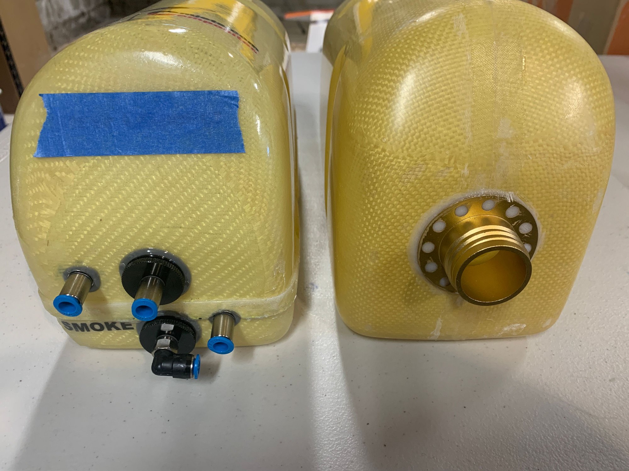

This is the tank the jet comes with. If you remember, there used to be a Sullivan tank that was available as an option from Boomerang. It did not come with the jet but it was an optional part, and it fit perfectly. I used it in a Sprint and it worked well. This tank is so much better, again another improvement Larry has included as part of this new version. That said, I am not going to be using it as I opted to install a smoke system.

Like any accessory, there are many options out there. For this jet I decided to reach out to Carlos at CMJets. I had a very positive experience dealing with him before, he is a good guy. I installed a set of his tanks in a Pirotti Rebel. There is a separate thread for that jet where I show them installed. That jet has two tanks, one for fuel and one for smoke oil. For the Elan I wanted a combo tank. I saw that CM had a nice setup where both the fuel and smoke tanks are built into a single combo tank.
I sent Carlos a quick drawing asking if he could adjust some of the fittings based on my setup and he was very accommodating. I would not hesitate to recommend using CMJets.
I know - pretty crude drawing. I could have been more specific with my measurements. But I knew what I needed and the tolerances I am dealing with. Carlos made it perfectly.
Note: before someone comments about the fuel vent not going to work, there is internal tubing that properly places the end of the vent up-high in the tank. I am a little apprehensive about this approach, but I figured I would give it a try. If it works well, it should prove to be a nice clean setup. Plus, I can always add a fitting up higher on the tank if I run into a problem.

This is a side by side view of the boomerang tank and the CMjet tank. They are pretty close in size, I am going to have to sand the sides a bit, specifically the kevlar band that is wrapped around the tank. I don't want any pressure on the fiberglass inlets of the jet, an easy fix will be to sand it down a bit. I will seal it with clear resin or an epoxy mix.
Note: I pay for all of my parts, so any recommendation or opinion I share with the community is sincere and unbiased, based on first-hand/personal experience.

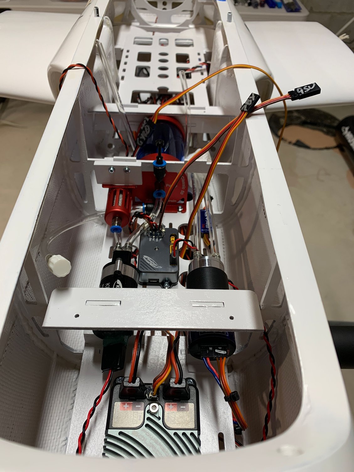

The fuse is slow-moving. I did not secure the pumps before so I pulled them back out. Most of the runs will come up through the main (large) opening in the lower board. In order to keep things clean as I go, I decided to secure the 1e, light controller and the batt-backer instead. They are in!
Note: I had planned to cover all of the wiring in the jet with black snake-skin. I bought it and started covering some of the wires but ultimately decided not to use it. I remembered I ran into a problem with my Rebel. I had to replace the motor for the nose gear (Electron retract) and all of the wires are buried in snake-skin covering. It was a major PITA to perform that service on the jet. I may use it again in the future, but I left it out of this jet.

I was able to get a little work in this evening
I reinstalled the pumps. Secured, safety-wired and connected.
I also installed the UAT. I am now running a leak test. There are three fittings which all can leak and of course a manufacturer defect of the unit. I don't rule anything out, so I test as I go. I made the mount for the filter but was not able to install it as I painted it, will need to wait for it to dry.
I let this setup sit for 30-mins to an hour.
I keep an eye on the air bubble, If it gets any bigger it is an indication of a problem. I obviously also check for wetness and smell.

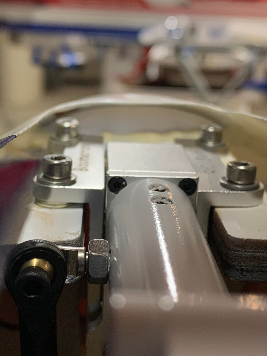

Completed the nose retract today. Programmed the 1e, installed the steering servo per my usual settings, installed the retract itself and ran all the wires.
Nose current setup: LD= steering trim, RD= 1e gain
note: added logic so that the 1e is only active when the gear is down and in flight mode 1 or 2. It will automatically deactivate if switched into flight mode 0 or gear is up.
You see anything wrong with this picture? Unfortunately the rails are not installed correctly and the retract is off by about ~10-15 degrees.
I added a couple washers to correct the problem. Simple fix.

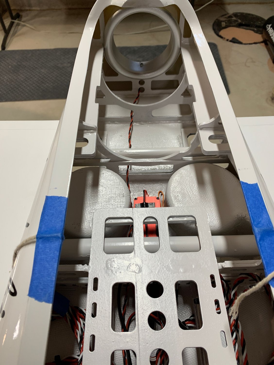

I also made additional progress to the fuse. I'm getting closer to being able to drop the main board in. I cleaned up wires and plumbing for the fuel and smoke system. I tested the smoke pump, ensured the program in the radio worked as desired. I still have a few more steps, I'm missing two male/male servo leads - bummer. Work Stopage!
Front view
Top view
top view too
rear view
Front view
Top view
top view too
rear view

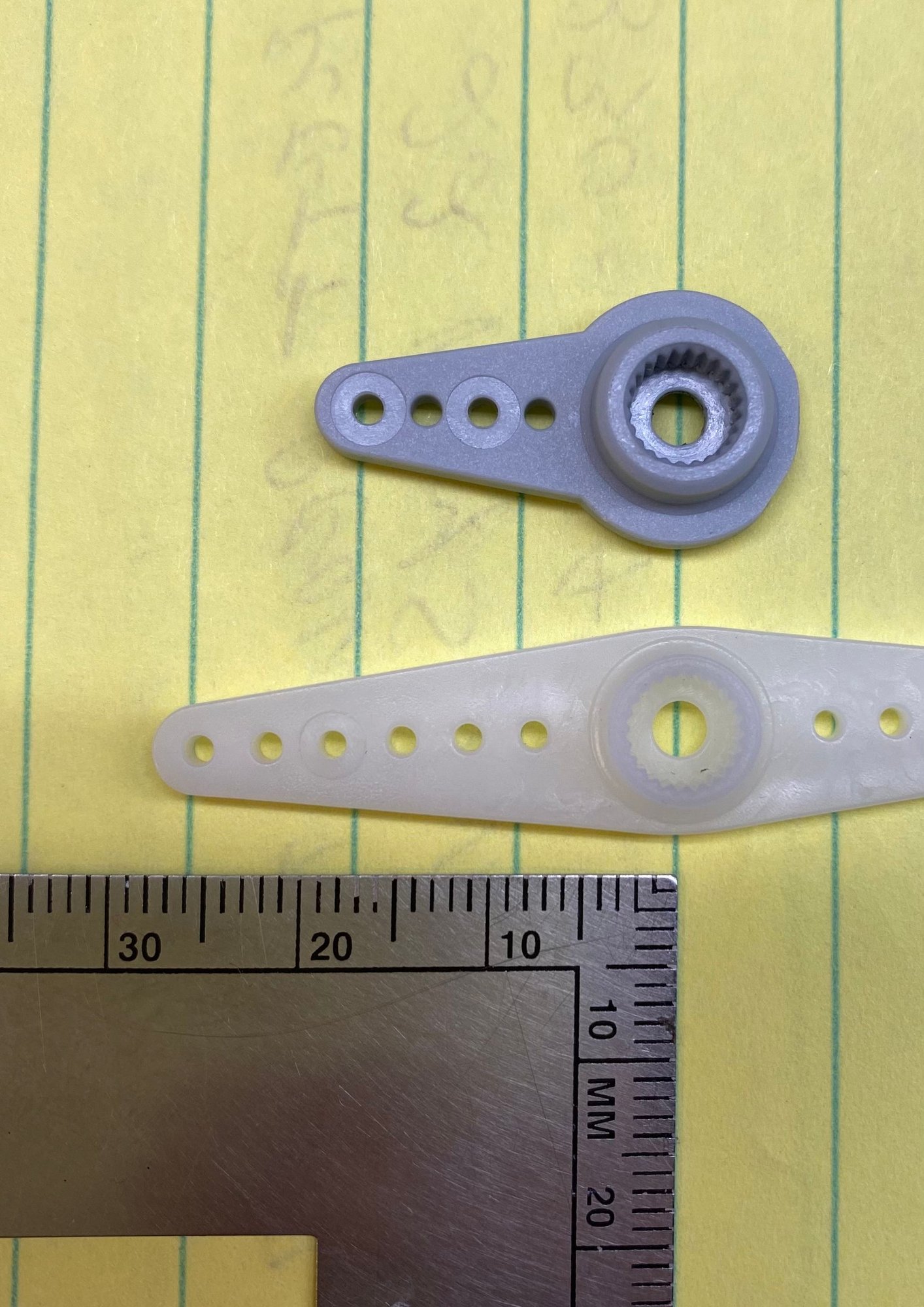

Actually, I have a couple questions for ya, I hope you don't mind. What length servo arms did you use? I'm trying to use the smallest that will give me full/recommended throws.
Did you run into any problems with the installation of the control horns? I have already cut mine to the correct depth and have them fitted for all surfaces. I just need to dedicate two days for all of the epoxy work and curing times. But when going through the process, I noticed some do not sit straight at 90 degrees. I obviously intend to install a ball-link with a bolt through the horns when I epoxy them to the surface, but were yours angled inwards like some of mine? I am thinking the two red lines should never intersect. I think the slots in the base-plate are cut too close, but curious if you or others have run into this. Thanks in advance.
Did you run into any problems with the installation of the control horns? I have already cut mine to the correct depth and have them fitted for all surfaces. I just need to dedicate two days for all of the epoxy work and curing times. But when going through the process, I noticed some do not sit straight at 90 degrees. I obviously I intend to install a ball-link with a bolt through the horns when I epoxy them to the surface, but were yours angled inwards like some of mine? I am thinking the two red lines should never intersect. I think the slots in the base-plate are cut too close, but curious if you or others have run into this. Thanks in advance.
