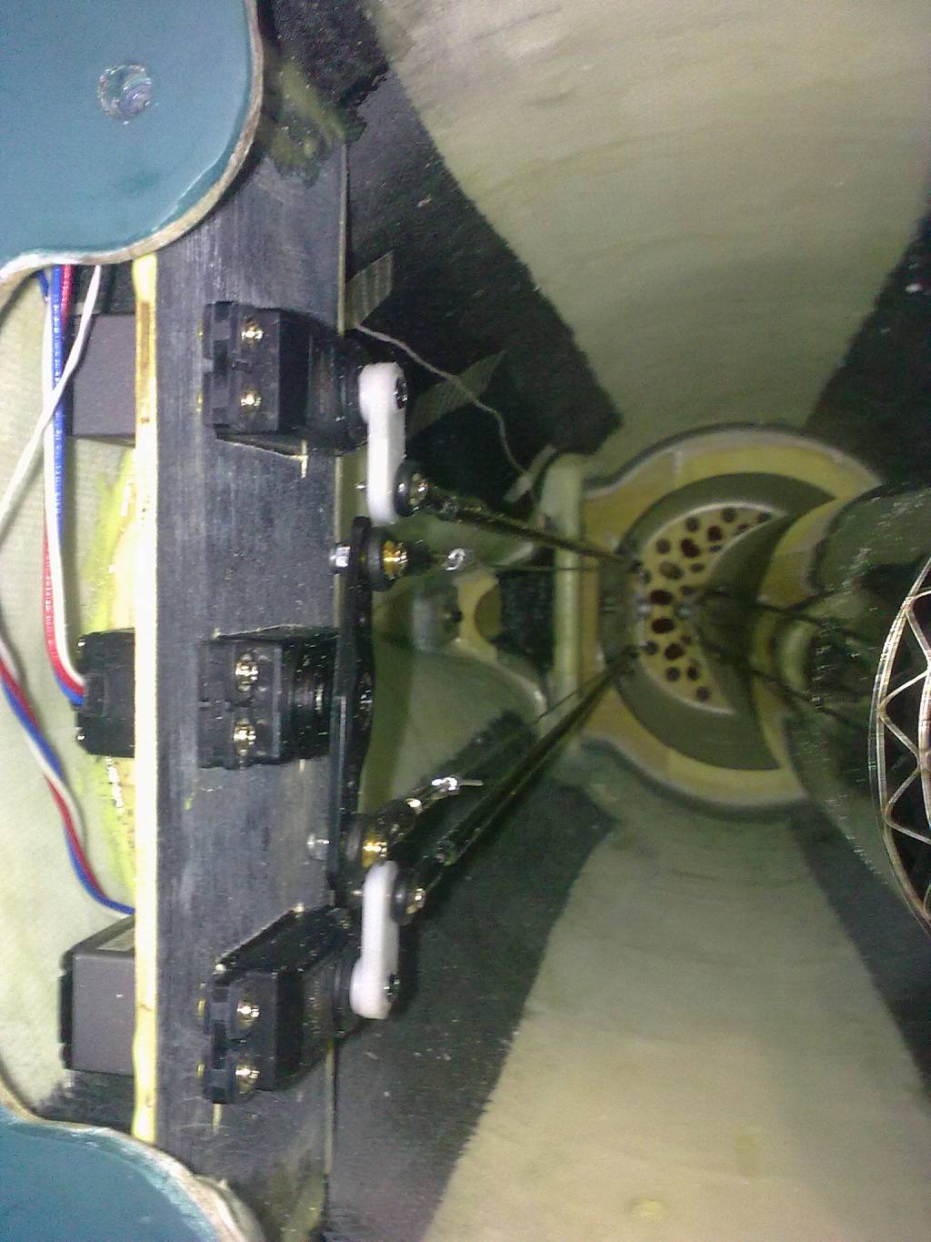

Hi all.
I have transferred servo and have cleaned 150 grams from a back part of a fuselage.

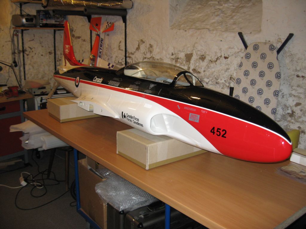

Hi all,
three weeks ago I got my SM T-33 and as soon as I get my servos I'll start assembling.
Now my question ! Is it possible to reach the CG without lead in the nose ?
It would be great if somebody can pose some pics from installation.
Jens

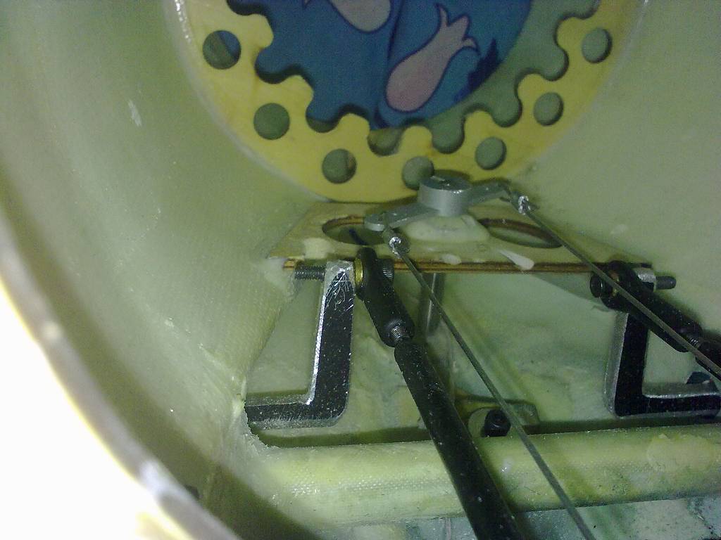

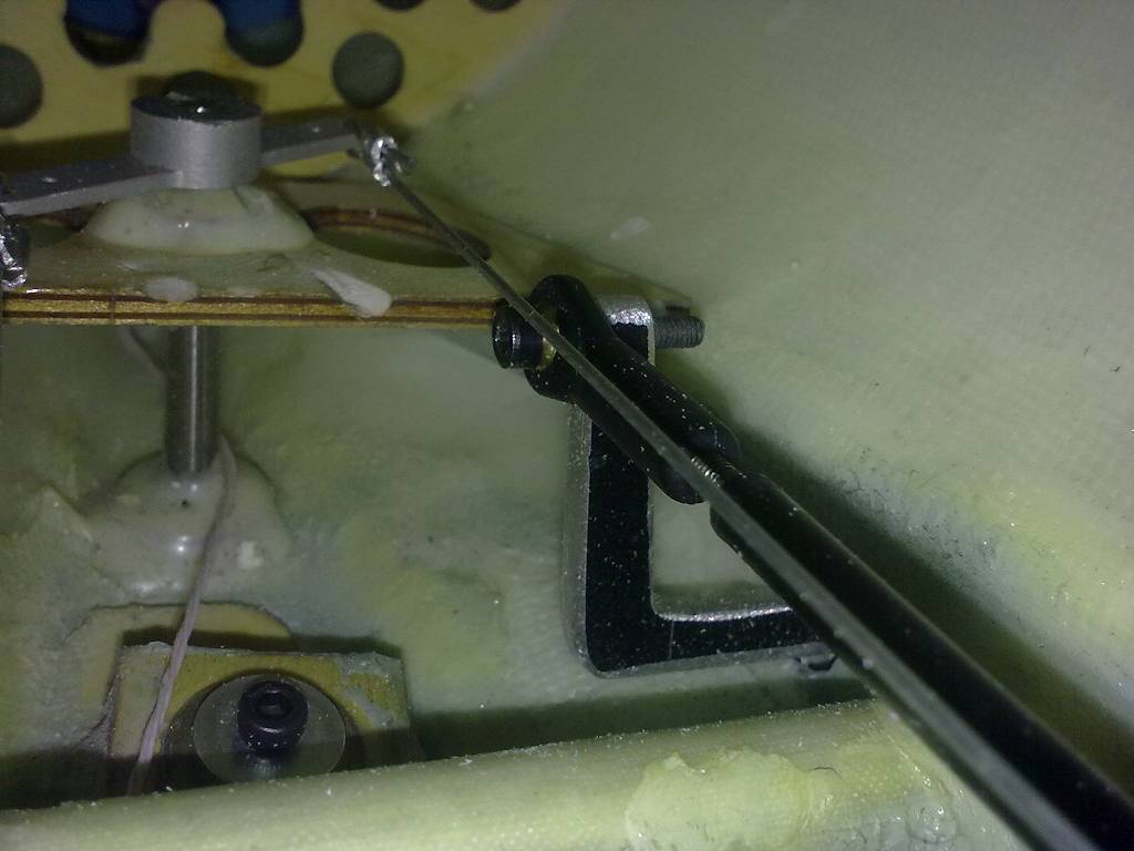

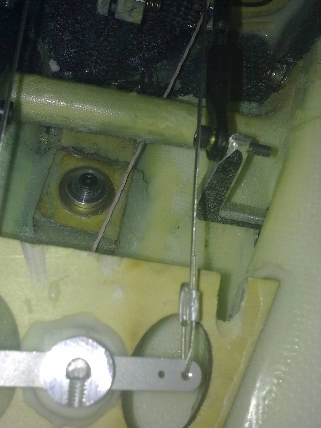

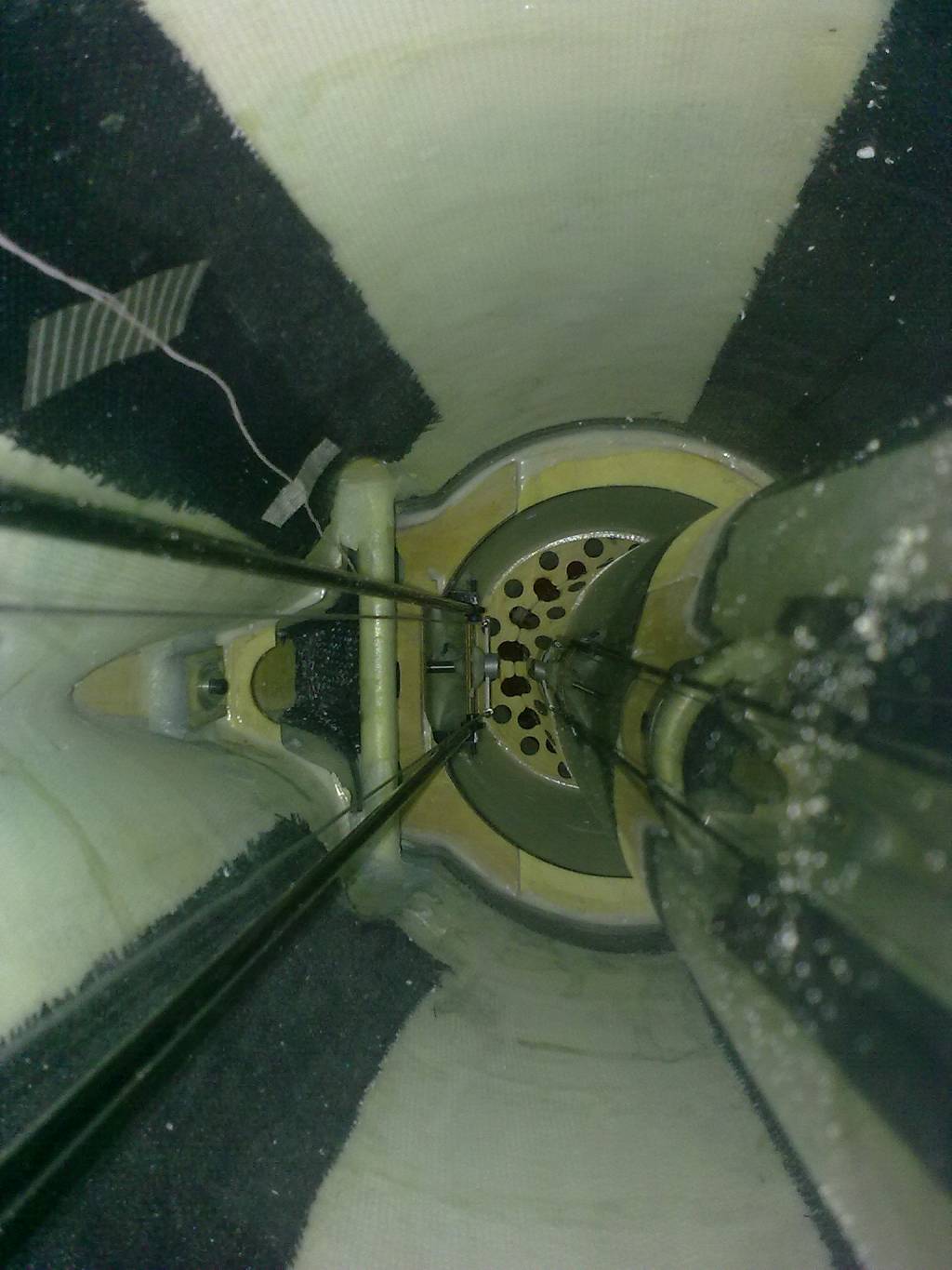

Thus I have provided management of an elevator.
Alexander.

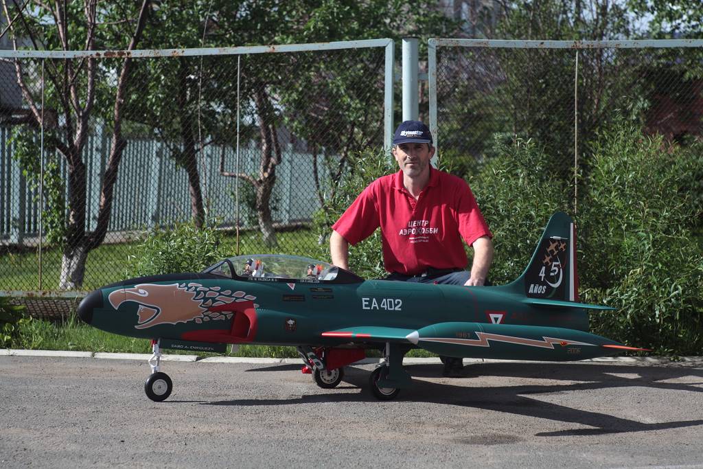

Greetings to all. At last that I have collected the plane.
I prepare the plane for flight.

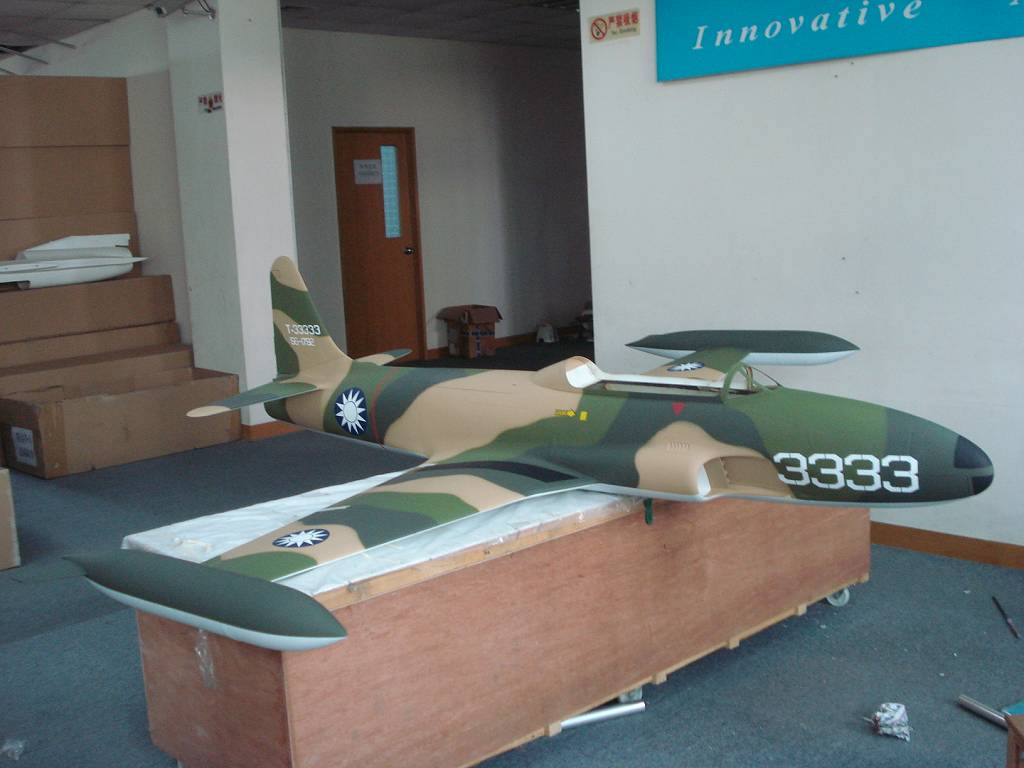

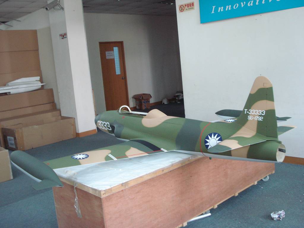

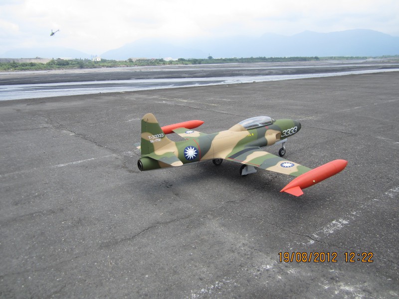

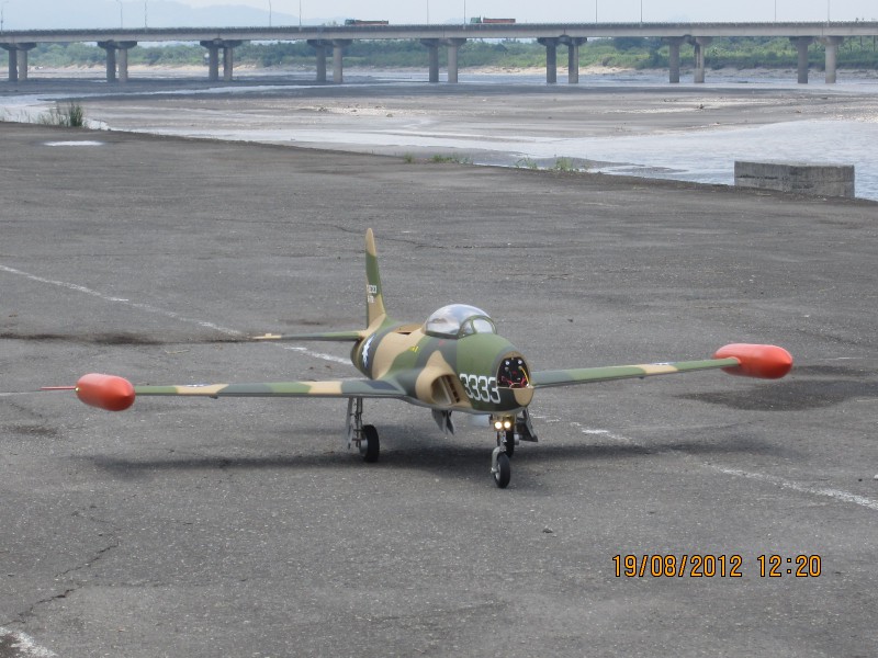

this is new finished very old color scheme for A/T-33 of Taiwan airforce,.. and i like this color scheme too,
Best regards
Anton

Sorry for the late post but i just saw the wire setup.Not nice idea at all.
For start the way the wire is been looped is wrong. This way if it doesn't fail by slipping out it will get loose and cause flatter..
I attach a draw of the correct way to make this loop ,coming out from my hundreds hours experience on +150cc aerobatic models .Plus the lines should be X crossed and not parallel II since this is a flex link=pull/pull and not a solit link =push/pull.
Now for jet use i do NOT recoment any flex/wire links because you will get flatter .
Also the carbon links are too long not to have a support in between.
IMHO mount the servos where they suppose to be and try to place the engine further forward to help the C.G.
sorry for the poor english. Better a few grams in the nose that an elevator fail .

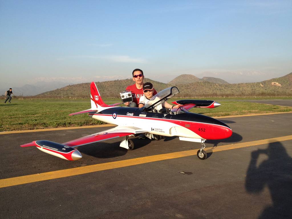

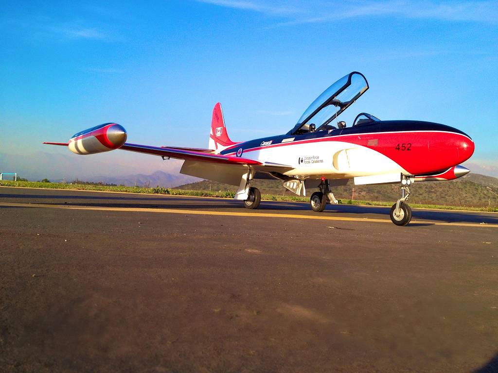

I was finally able to maiden my plane yesterday. What a beautiful plane....... great work of Skymaster.
Maiden flight was done by Michel from www.jetsrc.com Just a few clicks and the airplane was flying straight. Actually, it seemed like the airplanes was flying on rails. Couple of rolls, inverted flying and everything went OK. When applying full flaps, only a very small nose down tendency. When trying stall speeds, the airplane doesn't drop a wing but it starts sinking fast. That happened to Michel in his first landing approach. Second approach was perfect but as soon as the plane was on the ground, the wings started rocking.
http://www.youtube.com/watch?v=ZYaMQ...ature=youtu.be
For the second flight I took the controls and I was amazed to see that this planes is so fast. Just half throttle and the plane is really moving. Full throttle.... and the verticals are huge. For normal flying, the plane behaves like a trainer, plus is so easy to see in the air because of those big tanks.....
I was really amazed to see how light the plane is. Haven't weighted it yet, but it is lighter tan my MB-339 and Viper Jet.
Just thinking if a Giro can help with the wing rocking issue during the landing. In the meanwhile, I'm going to install some fiber carbon tips under the tanks in order not to scratch them
Besides the wing rocking at landing, the plane has no bad tendencies. When turning, it doesn't drop the nose like my MB-339 so keeping it at the same flight level is really easy.
In general...... very happy with the plane. Plus is great to see something that is not the typical modern fighting jet.
I equipped mine with a Jetcentral Rhino, JR 8711 servos, Power Box Royal, Futaba receivers and a Airpower 5 EVO air valve. Everything worked great.
CG was at 190 mm and very little lead was needed in the nose. I will try to take some more detailed pictures next week.

Gonzalo38,
I think the wing walking that you are referring to is only on the ground - correct? If so, I believe the problem is under carriage and /or wheel alignment related. First, if the oleo pressures are too low then the plane will rock side-to-side like that when direction changes take place. Second, if the nose wheel is under load, like with heavy braking or when the plane has a negative AOA on the ground, you can induce that kind of wing walking with nose wheel direction changes. Finally, and this is what I suspect, your wheels are aligned slightly toe-out, perhaps more so when the under carriage is under load, which translates into an occilation from side to side as first one wheel and then the other let's go from tracking outwards. May I suggest you try two things before you try to 'fix' the problem with a gyro of sorts;
- give the main wheels a bit of toe-in.
- get the nose to stand a little higher.
If that still don't help, increase the oleo pressures in all the oleos.
Hope you find a solution mate.

Thanks for your comments. You are right..... this only happens when slowing down in landing.
I will check the plane and make sure that I have a little bit of toe in. The nose is already standing higher so that is not the reason for the problem.
This plane has long wings and the big tanks on the tips are maybe the cause for the plane wanting to rock (plus the very narrow landing gear).
