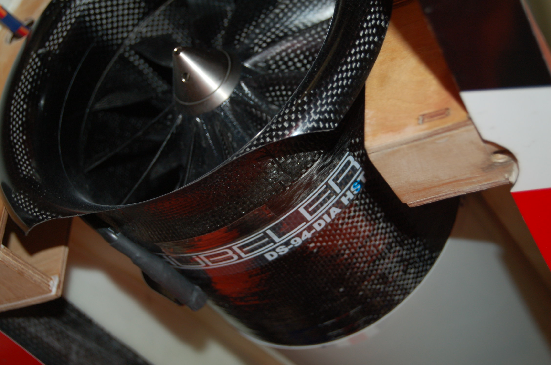

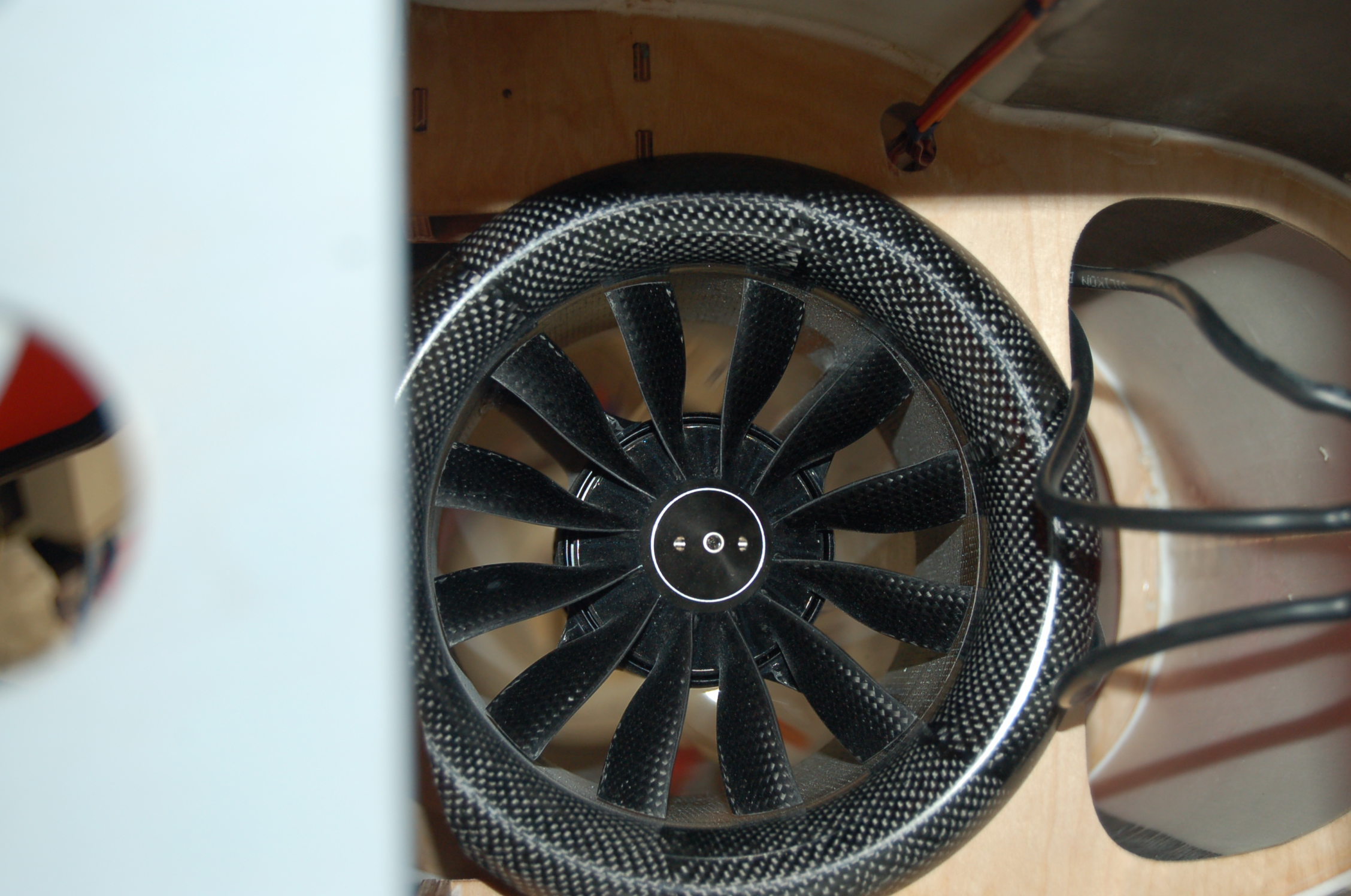

Dave Wilshere 01-25-2015 03:16 PM
Hoping to do some more work on the EDF Hawk this coming week, Ready to install the thrust tube rolled from mylar sheet. managed to open the rear of the fuselage to the largest possible opening as we don't want high velocity air (minimal compression on the fan swept area)

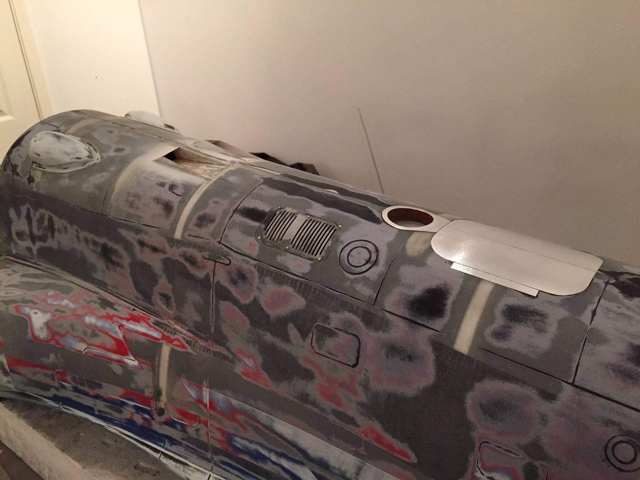

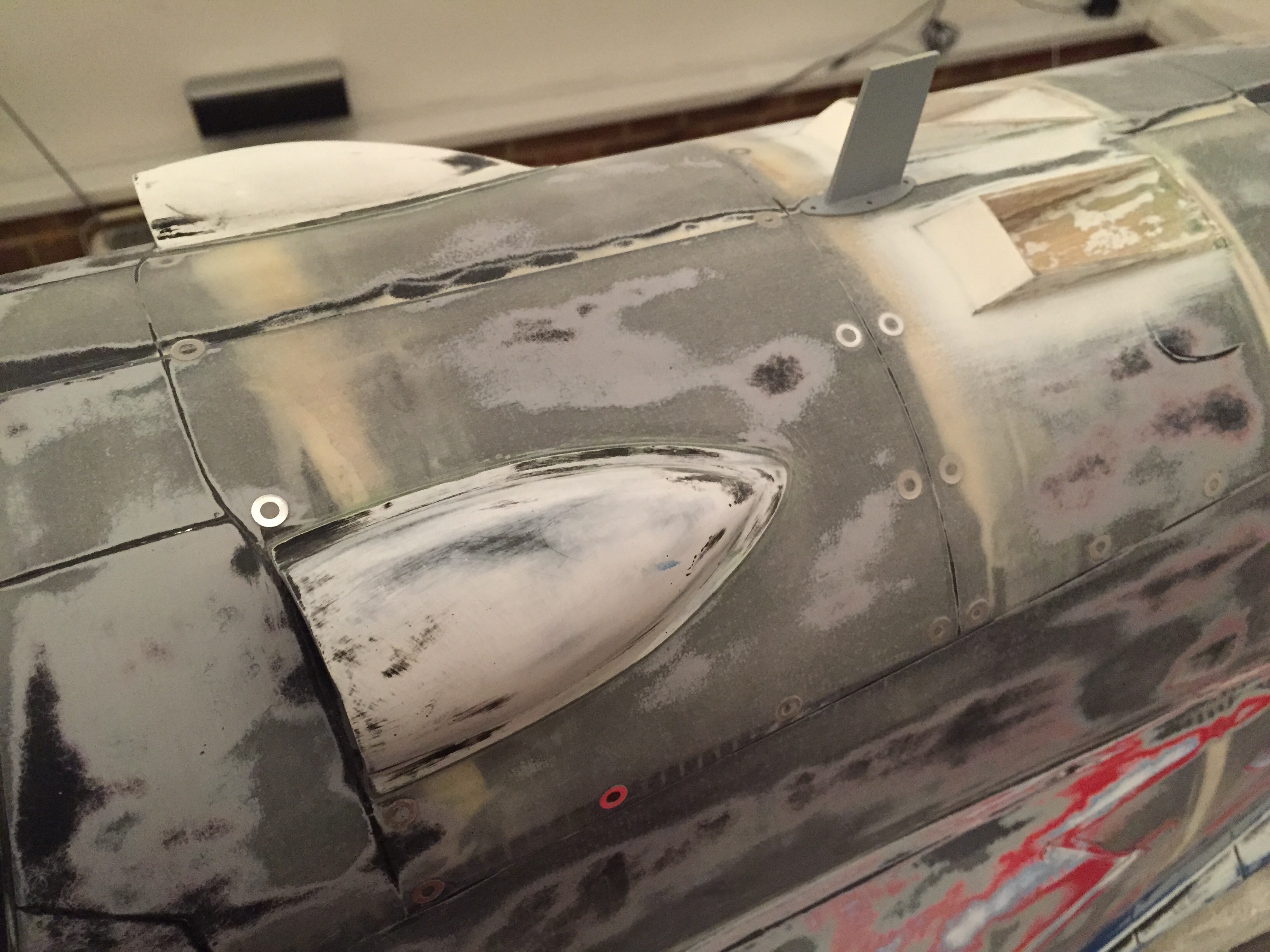

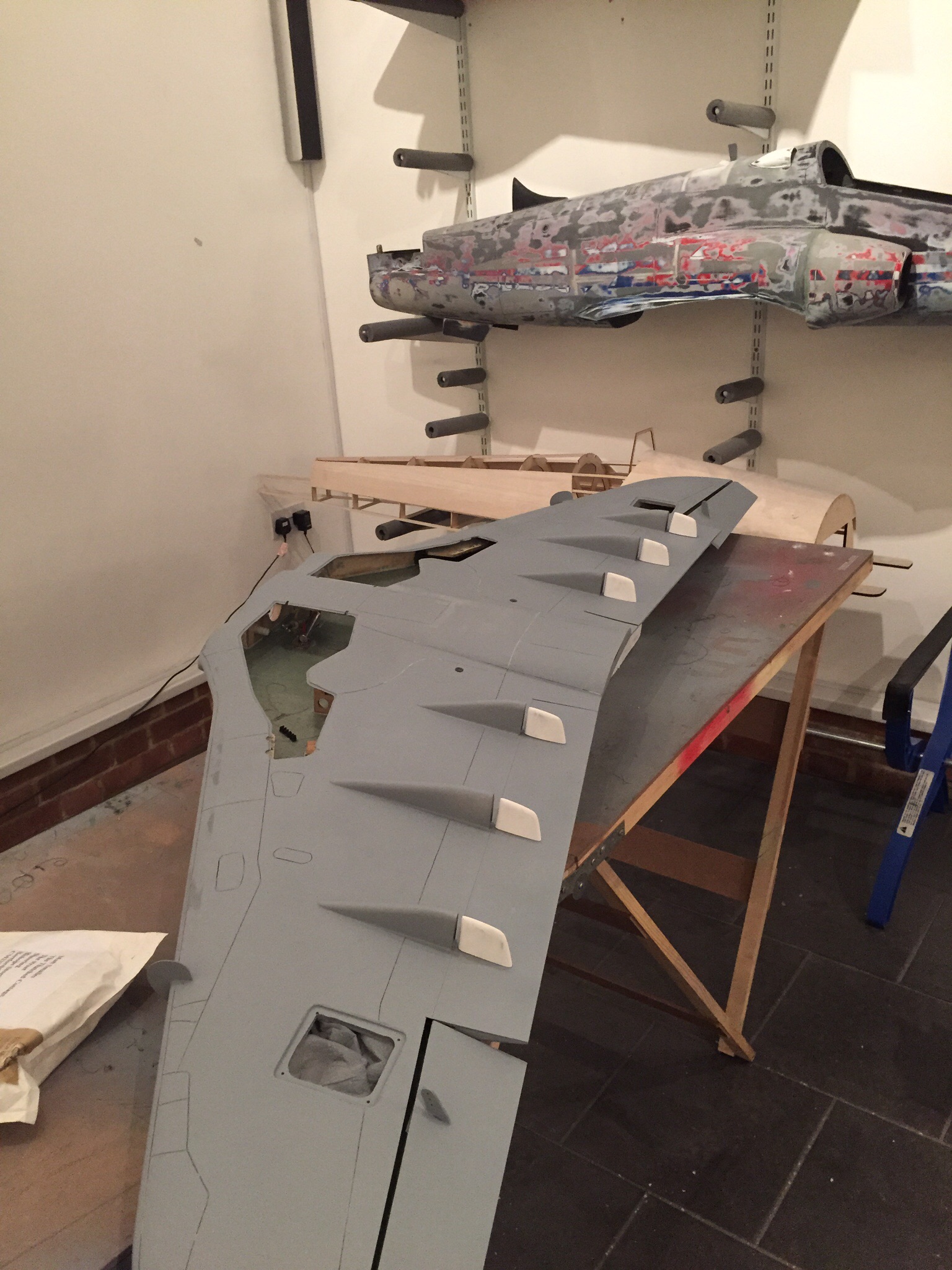

Matt Smailes 02-23-2015 03:14 AM
1 Attachment(s)
Hi everyone,
I'm currently refurbishing my Hawk, whilst I'm waiting for the paint masks I thought I'd add some rivets but can't find any 3 views that show the kind of detail I'm after... Can any one help ?
Here re are some photos of what's been going on in my workshop (-: http://www.rcuniverse.com/forum/atta...mentid=2075602
Matt Smailes 02-23-2015 03:19 AM
2 Attachment(s)
http://www.rcuniverse.com/forum/atta...mentid=2075603http://www.rcuniverse.com/forum/atta...mentid=2075604
Matt Smailes 02-23-2015 03:53 AM
1 Attachment(s)
http://www.rcuniverse.com/forum/atta...mentid=2075605
Dave Wilshere 02-23-2015 04:56 AM
http://www.modelflying.co.uk/sites/3...200/397891.jpg
ticketec 02-23-2015 06:17 AM
10 Attachment(s)
Originally Posted by Matt Smailes (Post 11988898)
Hi everyone,
Looking great there mate! Nice to see some extra details on the model.
I spent quite a long time searching high and low on the net looking for 3 view drawings that showed panel lines and rivet details on the hawk and came up empty handed, when I was detailing my Flyfly foamie Hawk.
These are a the best I found, together with plastic models of the Hawk. It wasn't good enough to burn rivets in but at least with the foamies smaller size the tail cone raised rivets and panel lines was enough.
I'm working on my Skymaster hawk at the moment and needed some more details about certain parts of the hawk. Just realised that the biggest airshow in Oz is on this weekend so I'm flying down to Melbourne in a few days time with a modelling buddy of mine because the RAAF will have at least one of their Hawks there so hope to get one or two pic's of it.
All the best
Dave
JSF-TC 02-23-2015 07:35 AM
Dave,
Are the dummy underwing flap fairings still available? Looking for a set to add to my SM X-treme Hawk.
Paul

Dave Wilshere 02-23-2015 10:10 AM
Originally Posted by JSF-TC (Post 11989030)
Dave,
Paul
Paul
Not at this time, mould was never meant for series production and we have done 30 sets now. New moulds are in the process though..hey Matt ;-)

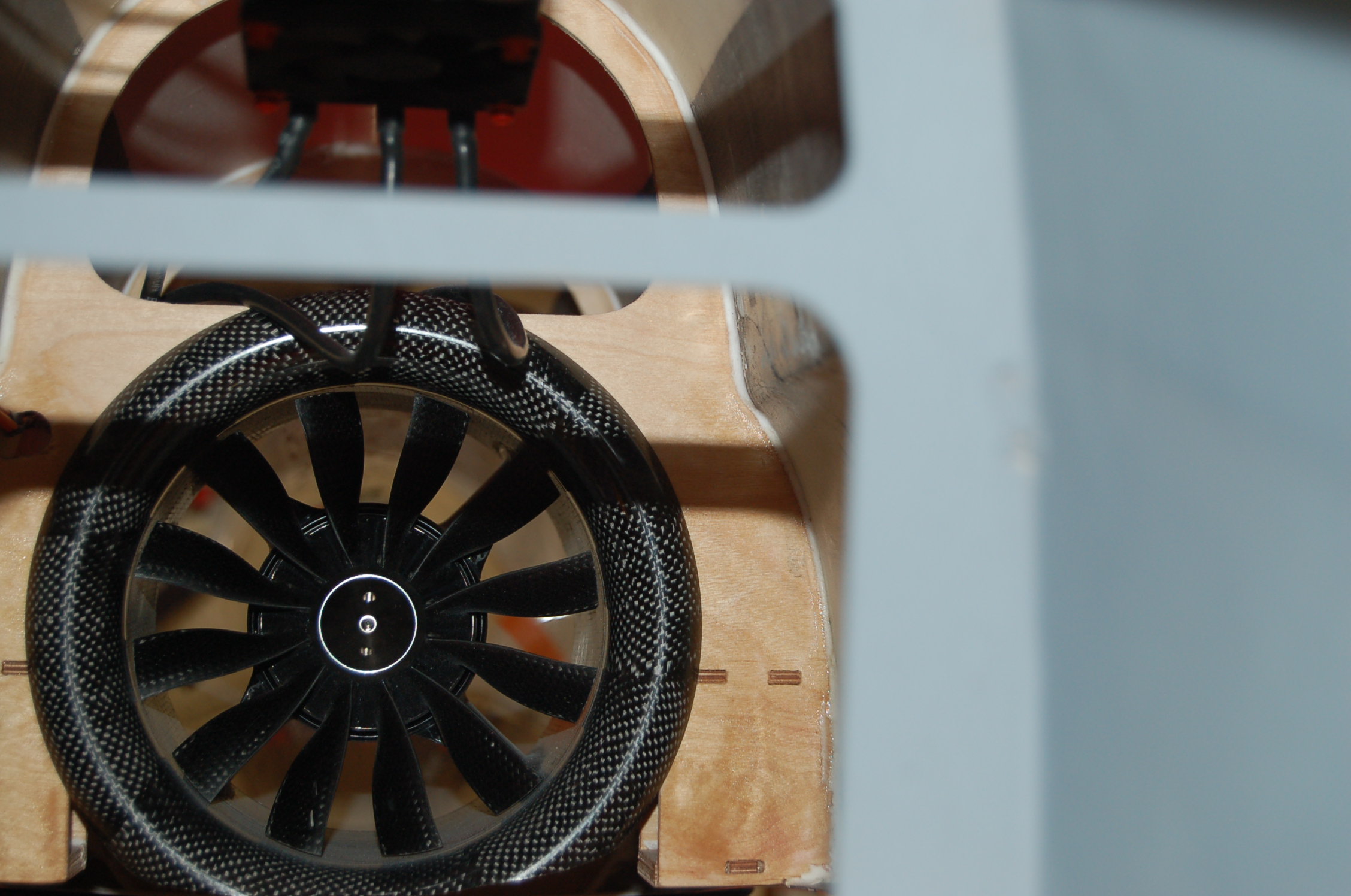

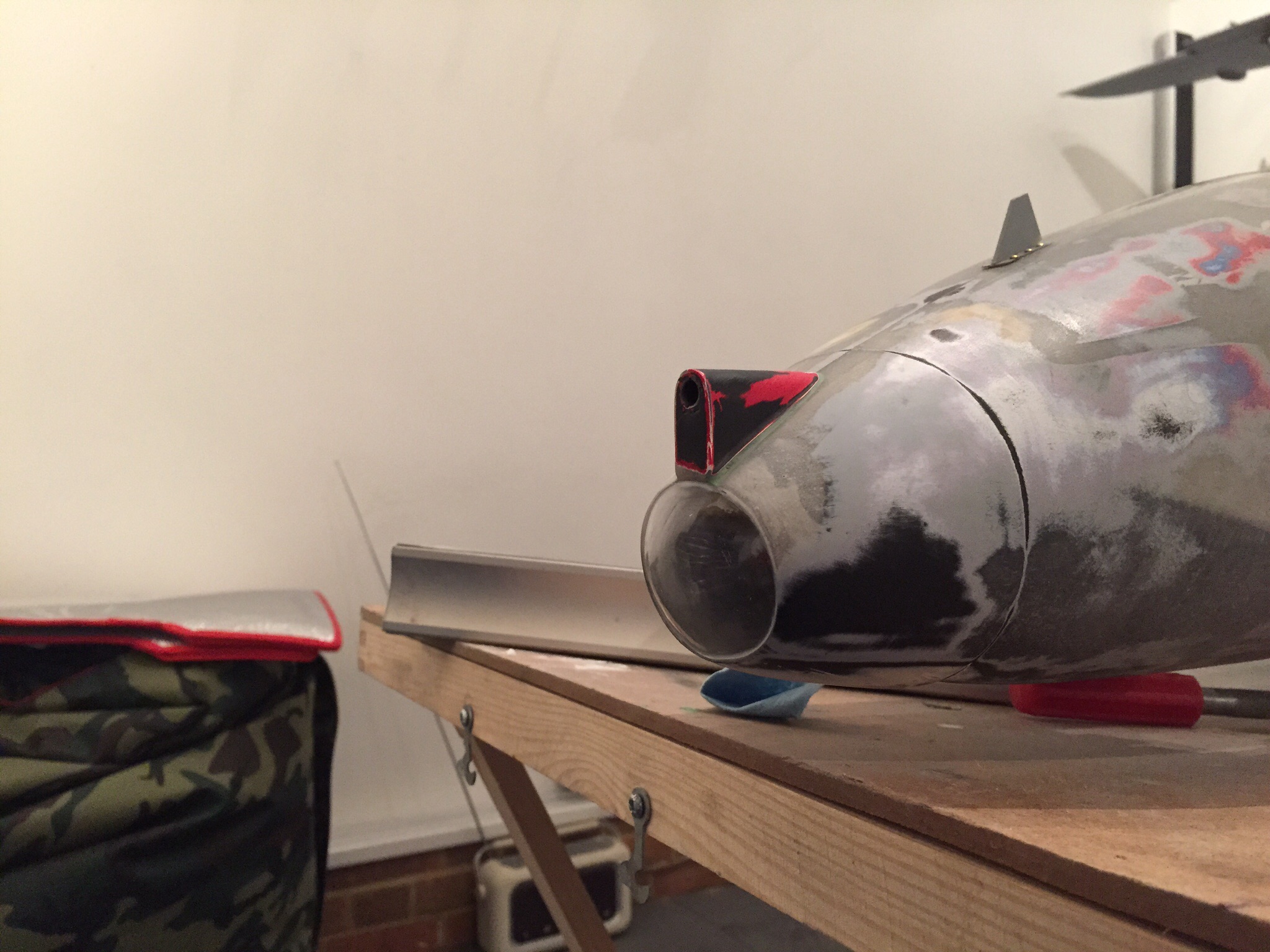

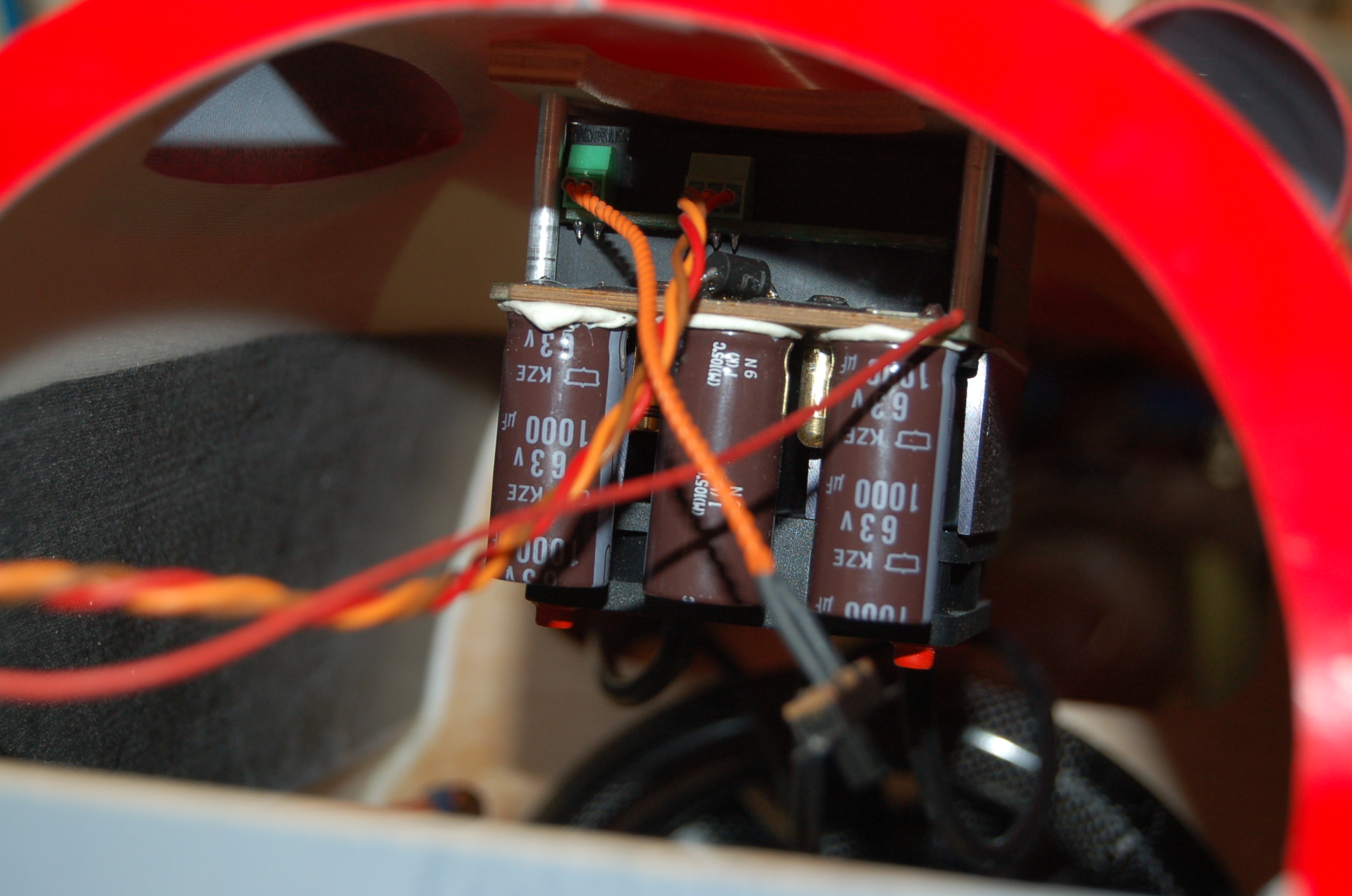

4 Attachment(s)
Finally cleared some other jobs so looking at the EDF Hawk again. Tail tube is now in and that allows me to work forward.

Dave Wilshere 02-24-2015 11:29 AM
Just been too busy with other things, I'm having a big push to find time on this and the Habu 32x, so I'm clear for some new incoming boxes!
Wanted to use a UP3 valve as I love them, but two JetTronic valves are much lighter, so going the same way as my original RA Hawk that has not had many air issues since built in 2009.
Having decided all these things I can crack on.
