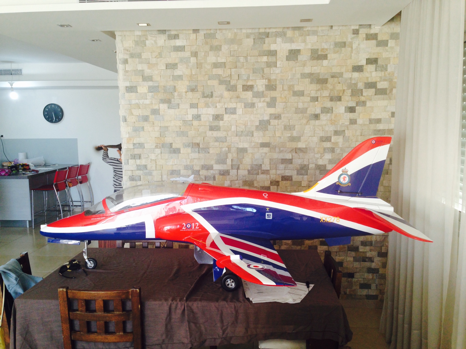

izzy 05-04-2015 05:38 PM
1 Attachment(s)
speaking of CG , I have mine ready for maiden hopefully this week
to get the cg to 205 , need to add aprox 500-600 grams of weight in the nose
does this seem right ?
have note done a cockpit yet , and install was basically trying to copy DW
I also hope the thrust line will be ok, as I mounted mine on the original rails
http://www.rcuniverse.com/forum/atta...mentid=2093950
Gary Arthur 05-04-2015 07:36 PM
See post 1834.
We are flying ours with a CG of 198 and it flies great. Plus it lands like a putty tat.
I had my nose weight fall out on take off (long story) and with a CG of 198 and the nose weight falling out it still flew and landed but was pitchy and floaty on landing. I can only image where the CG was with 1 1/4 lbs falling out.
If you are starting at 205 it is conservative. you may find it will land a little slower with the CG up at 198.
izzy 05-04-2015 08:23 PM
Mine will weigh In at Aprox 28 pounds dry with the ballast up front.
So from what I read some planes being 29 pounds I adsu
e that's ok ?
thx

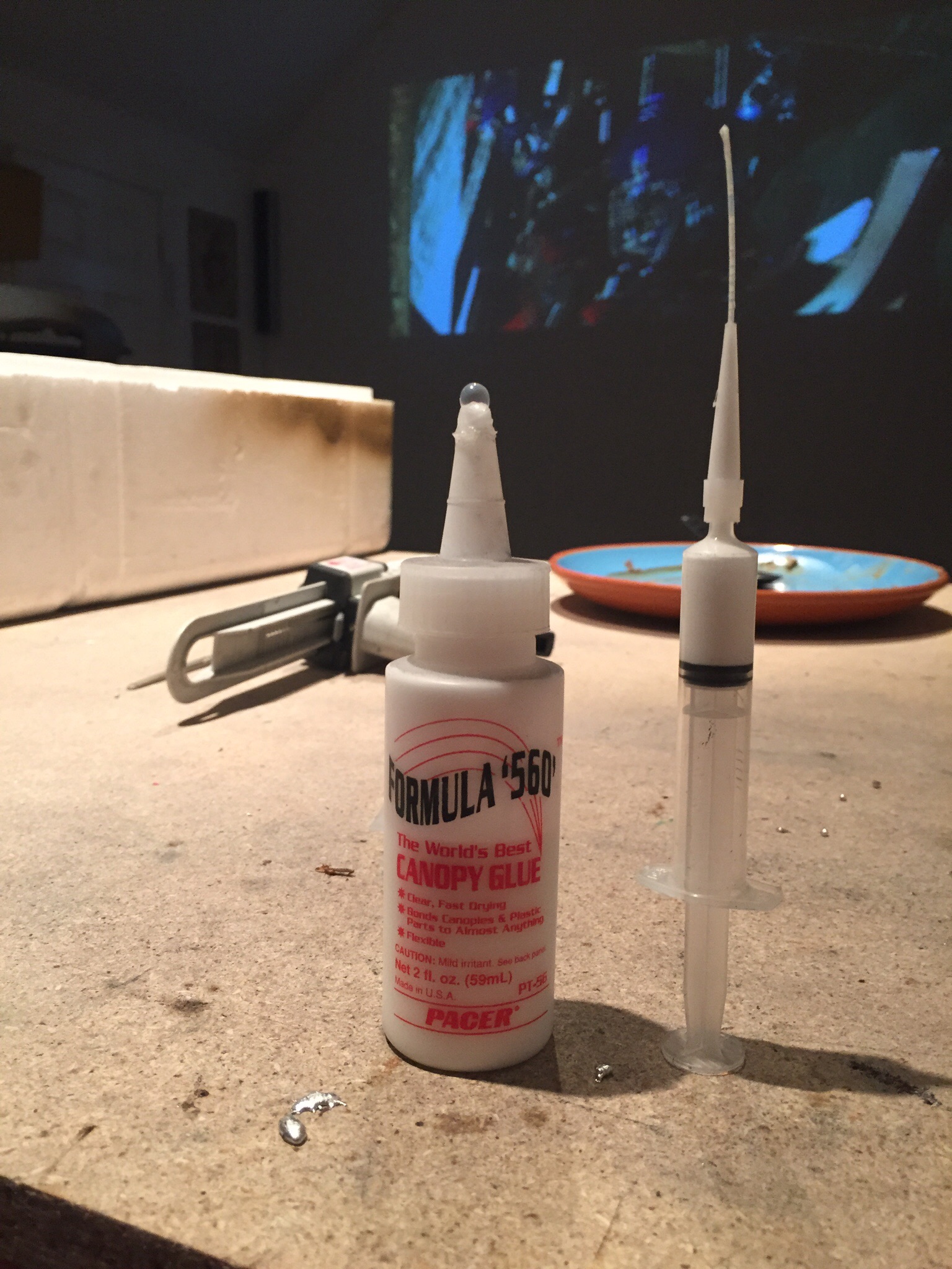

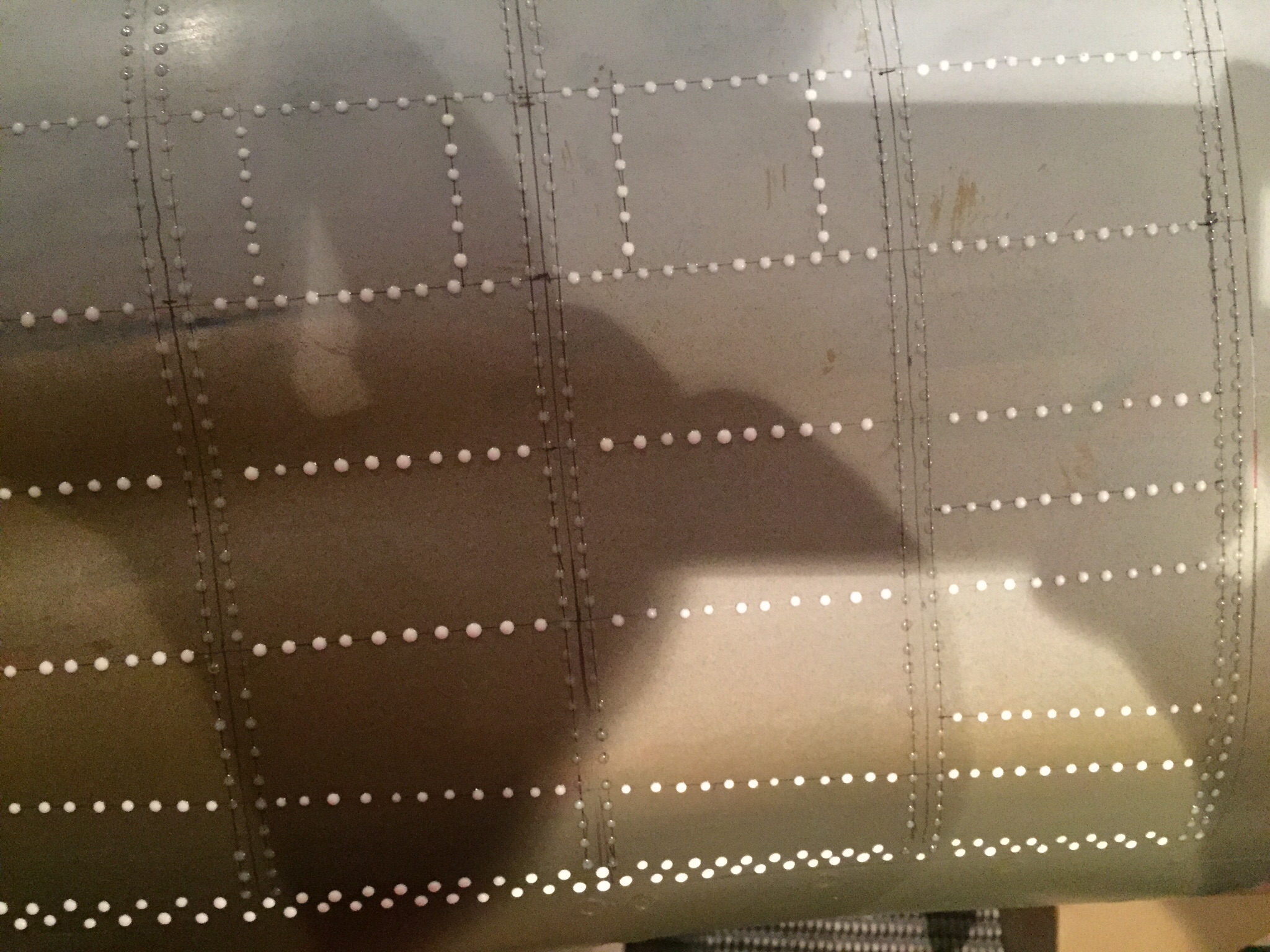

Matt Smailes 05-06-2015 03:48 AM
3 Attachment(s)
Thanks for the complement, after trying all sorts of glues and applicators Dave suggested canopy glue one day at his shop. Here are some photos that explain how it all happened.http://www.rcuniverse.com/forum/atta...mentid=2094270http://www.rcuniverse.com/forum/atta...mentid=2094271http://www.rcuniverse.com/forum/atta...mentid=2094272
jjantti 05-06-2015 04:27 AM
Thanks for the pictures Matt. So they were droplets of glue! Not sure if I have the patience to match yours but I definitely will give a try. Now I know the best glue also :)
/Jyri

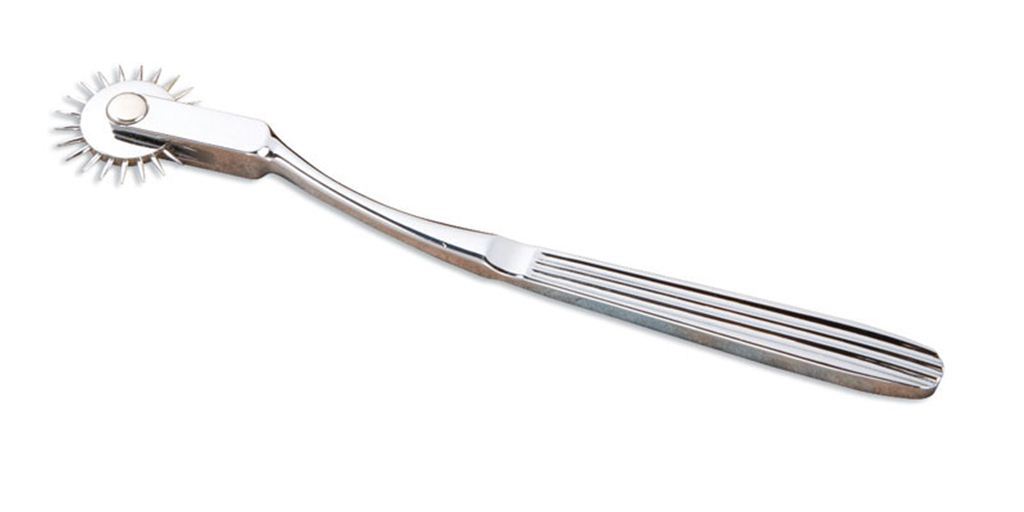

Dave Wilshere 05-06-2015 09:37 AM
1 Attachment(s)
The way we do it with a pin wheel. Different types, but grind the points off, make a stand off straight edge and put the ZAP 560 in a thin tray, Roll the wheel to collect a blob of glue. Place and roll.
Takes a little practice, but works well and V quick. If you mess up you can wipe off with a damp cloth and carry on.
Dave
http://www.rcuniverse.com/forum/atta...mentid=2094331
jjantti 05-06-2015 12:18 PM
Thanks Dave, I'll give a try. That would help keeping rivets uniform in diameter and specially in spacing. Diameter and height was my first fear with my set of nerves combined with syringes.

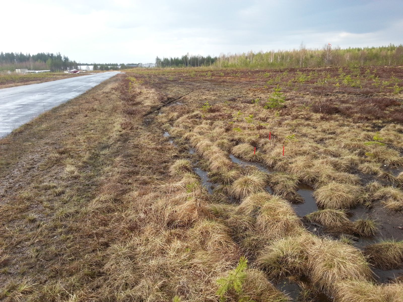

jjantti 05-09-2015 05:50 AM
It is an aeroplane!
1 Attachment(s)
It has flown. It needs small repair. It will fly again. I'd call that succesful maiden :)
My first landing maybe was not the best and gear doors took some hit. Full landing run in 40cm! Atleast gear is sturdy! Why is it that you'll always hit to the worst possible spot... red lines are the skid marks. Well that is just glue and few hours. The left middle main gear door was lost must have fluttered into woods or something. Now it will do without the doors. Still full of mud :)
http://www.rcuniverse.com/forum/atta...mentid=2094849
For some reason I had to calibrate my stereo vision for first three landings. They all went on the same side of tarmac. But from fourth and so on that seemed to be ok too.
https://www.youtube.com/watch?v=WYA4TRpeB6A
https://www.youtube.com/watch?v=Y_a0kvKZtJ4
/Jyri
