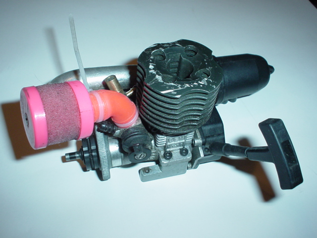

Joined: Aug 2003
Posts: 384
From: chester, NY
Default RE: mt2 compression problem
I never really thought about it till this post.
I have the engine-full exh-complete clutch- and a brand new CEN performace chutch shoes.- plus 2 air cleaners=new muffler mount.
make me an offer. all parts new cost 212.00 is half fair?
http://mivasecure.abac.com/toyhaus/m...vc?Screen=BASK
it has like new pinch, never been apart, and AR oil used (most of the time)
Oh you can have the motor mounts and bolts too.

Old 01-26-2004 | 06:09 AM
378's Avatar
378
Joined: Jan 2004
Posts: 2,862
From: Lebanon, TN
ORIGINAL: auto2
that looks familar i have that dynamite filter too my old boot broke because someone insisted that zip ties($2.50 for 500) were too pricey and i had to use a metal clamp which cut the boot engine still runs u seem to have more cyl head scratches than i do all my rolls were in grass with no body the body on rolls were on pavement(lol)
