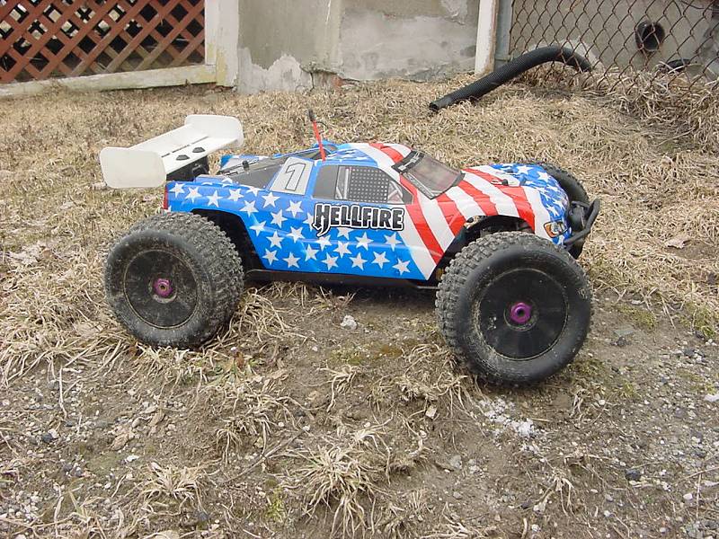

Quickster asked me, in the SavageX forum, about what parts I used to put together the wing on my Hellfire. I thought some of you might be interested.
They are Mugen Seiki and OFNA
OFNA makes the wing I used but any 1/8 wing will work
http://www2.towerhobbies.com/cgi-bin...=++&search3=Go
Mugen Wing Stay # E0404
Wing Stay Brace E0405
The UK site shows them in their seperate packages. The US one shows them together. I had to make a "Plate*"for it to attach to but it was no big deal, The 2 top screws of the wing stay go through it, the other 2 wing stay screws go through the Hellfire's shock tower. I think Horizon Hobby has the parts too but they aren't online right now.
http://www.racing-plus.com/mugenshop...grp_14-10.html
http://www.rushrc.com/shop/index.php...ugen+wing+stay
*Next weekend I'll take off the plastic plate I made and give it to my friend who moonlights at another friends machine shop and have him copy it on a metal piece.
OH, it's not crooked, its an opticial coolusziouion because my "plate is" LOL

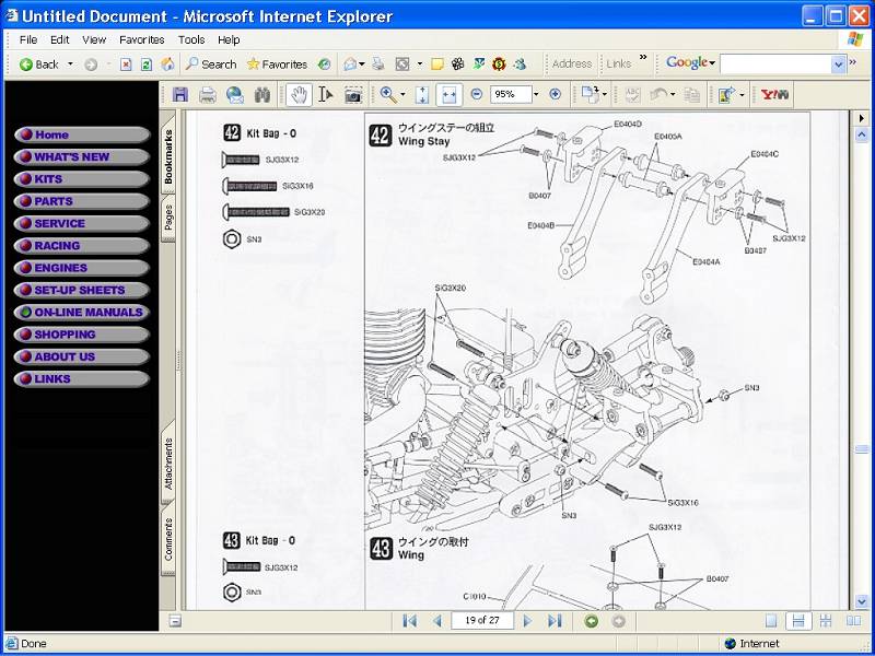

This might make the assembly of the wing stay a little easier, you can go to the site
http://www.mugenracing.com/
and click "online manuals" then "MBX-5" and go to page 19
or mayby this pic will help....I love thar PrtScr/SysRq key

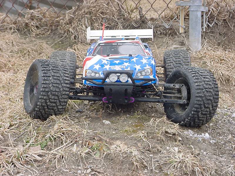

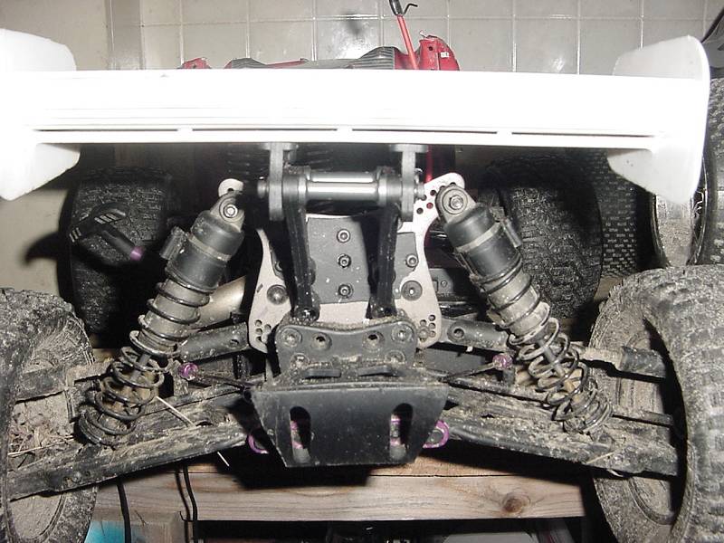

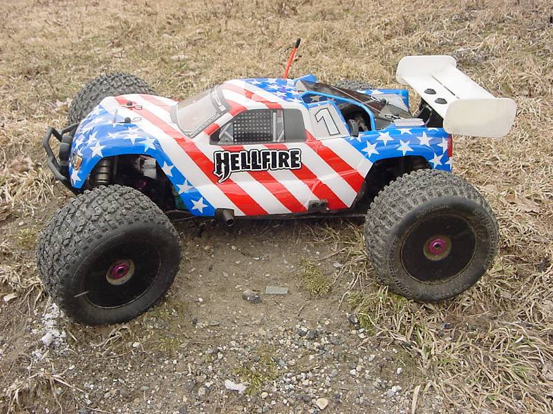

ID:	428887   Click image for larger version
ID:	428888   Click image for larger version
