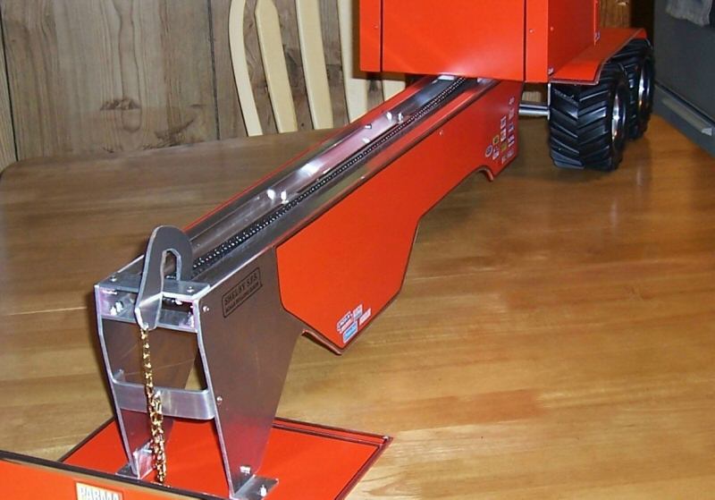

I want one... thing is I dont want to spend a fortune on it.
so I want to build one. but got a few questions.
figure a full size one pulls what? 300 feet? so scale it down to about 30 feet? (it will be for MTs like savage/tmaxx so I figure 1/10th is good enough.)
also what ratio does a full sized one raise the "box" at. ie when does the box hit the front of the sled. half way? 2/3s?
does anyone have one that they can take pics of so I can get details? searching online only gets me a bunch of clubs, not details.

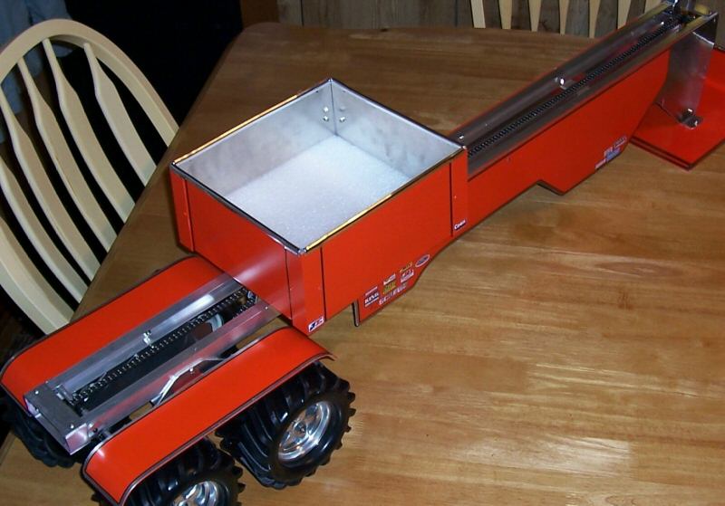

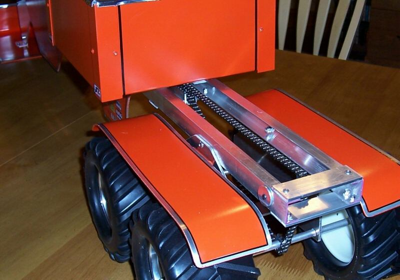

Hi
I hope these pictures help you out, and here is some extra information. It's built entirely from 6061 aluminum has T-Maxx stock tires and wheels for ultimate traction, a movable skid plate & axle walking beams to accommodate slightly uneven ground. It measures a whopping 52" long x 11" wide x 12" high has #25 steel roller chain with steel sprockets.
