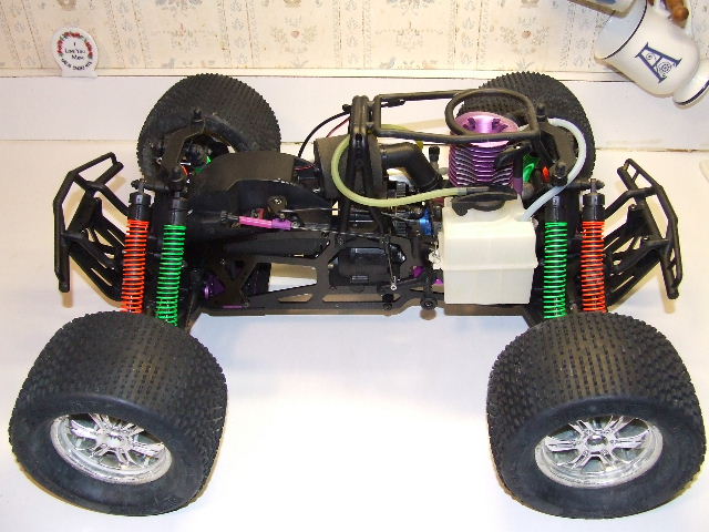

Default RE: Official HPI MT2 Thread
ORIGINAL: rcnz
ORIGINAL: tamagooch
does it pop wheelies
Not on the road, but on grass it will sometimes lift up in the front. Problem, is that the centre of gravity is way too low...the Savage can pop wheelies a lot easier as its centre of gravity is higher.
My Savage is real low center of gravity and I have no problems popping wheelies on the grass. Matter of fact I have it in the HPI LCG chassis. Now on the track it is not near as easy but when racing I do not want to be popping wheelies. But yes I understand what you are saying and totally agree. Now with my TZ when I had the 14/ 52 I could not keep the front wheels of my MT on the ground. I am now geared at 15/47 on my MT and still if I hit it just right it comes up.

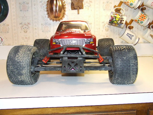

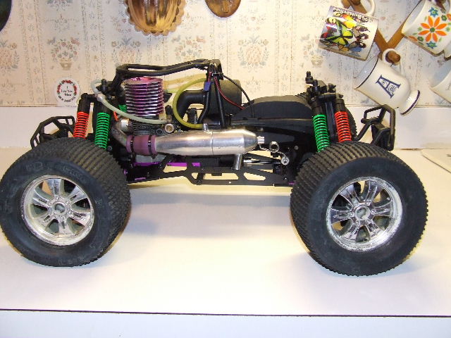

Old 12-23-2006 | 08:12 PM
  #10647
46u's Avatar
46u
Joined: Jan 2005
Posts: 22,095
From: Macon, GA
No it is all Savage and still has the standard 2 speed not a center differential like a truggy. At some tracks we get 4 to 6 feet of air and so far no problem. I only run 25 weight oil in the shocks one red and one green spring each corner. I know there is something wrong in one of these pictures and was changed before ever running. See if you notice it as the pictures where taken right after putting the LCG chassis on.
ID:	582596   Click image for larger version
ID:	582597   Click image for larger version
