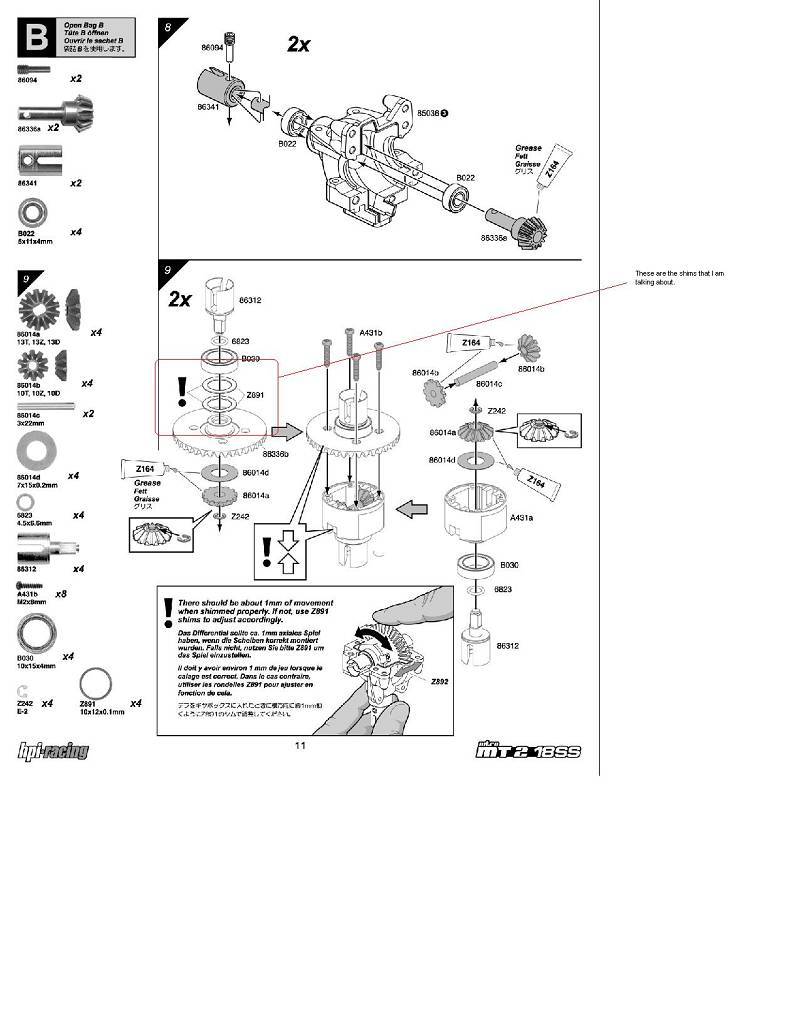

I tried to shim the small gear, but the shims are bigger in diameter than the small gear so I don't see how this could shim the gear.
As for the larger gear within the diff case, I placed a shim according to instructions from djheptic on this forum (as posted above).

I can't really see much detail in that image you've posted, so I've just taken two photos which I'll upload in a minute, give me a few mins...

Okay, so here's the small gear. According to djheptic's diagram, one shim should go where you see it here, so that it sits against the bearing. But, the hard diff gear is different to the pot metal one, so this shim is too wide.
And here's the output gear. I don't know which side the shim should go on - is it this side...(where the red dot is)
(You can also see the pot metal small gear in this image)
Or this side? (where the red dot is marked)...(Will one shim do? Or should I use two?)

arapoda:
Pic #3:
Pull off the big Gear then pull off the e-clip. Disassemble the output shaft and pull the bearing off. Add the washer from pic one to the outside of the diff gear (add 3 -4) then reassemble. The washers go inbetween the bearing and the big gear. If you go to HPIRacing.com that have the 18ss manual online. That is the picture I was trying to include.
Make sense?
What confuses me is that you have the pot metal input gear on the table and also the hardened steel one in your hand? Which one are you installing? The above is for the 18ss hardened steel ones. I hope that is what you are installing.

You need to put the shims on the GEAR SIDE between the bearing and the gear. This will move the gear closer to the pinion gear to get a better gear mesh. Don't over do it though because that will burn out the gear as well. When done correctly you should have a tiny bit of play. You can check this by holding the ring gear (the gear mounted to the diff case) and moving the pinion gear (the smaller shaft gear) back and forth, there should be a very tiny bit of play when it is done right.

The pot gear is on the table in the photo because I'm only just replacing them with the hard diffs. I'm not putting it back in!

Let me just check I'm getting this right, as this is an expensive mistake if not done correctly...
I need to take the black case off, remove the e-clip, take the bearing off etc, and place the shim so that it is sitting on the gear, then put the bearing back on, and everything else, then the black case, and that's it? How many should I use, as there's three shims in one pack.
I think I've gone cross-eyed! What I just said makes no sense as that would move the gear away from the pinion gear, no?
This is confusing everyone. YOU CAN'T TELL SOMEONE HOW MANY SHIMS THEIR DIFF REQUIRES. Every diff is different. That is why they send out shims! If they were the same for every diff then they would tell you how to put it together in the manual! Some will require 2 on one side and 1 one the opposite or the other way around. Some might only need one on each side.
Take out the E-Clip holding the diff shaft on the gear
then mount the gear to the black diff housing using only 2 screws
Now you can pull out the drive cup and remove the bearing to add shims without having to take apart the entire diff assembley
Install the shims and put the bearing back in place
Then slide the diff shaft back in
Now you can place the diff housing in the gear case and check the gear mesh by holding the final gear (the big gear) and move the pinion gear back and forth.
If you need a refrance to all the parts I talked about click below for the manual.
http://hpiracing.com/graphics/instr/10441/10441.pdf
Sorry I cannot explain this any further I have to get back to work.

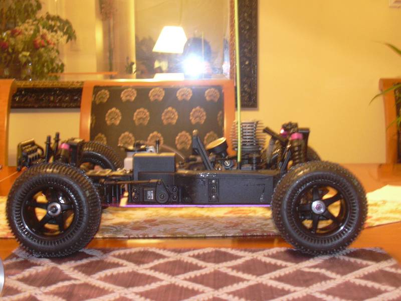

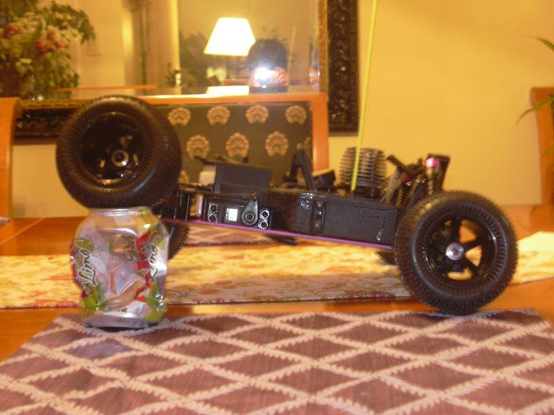

well here are the pictures as i promised u ppl. man i just broke the little throttle thing on the carb o well back to the hobby shop lol
where can you buy them, and i dont see a slipper
