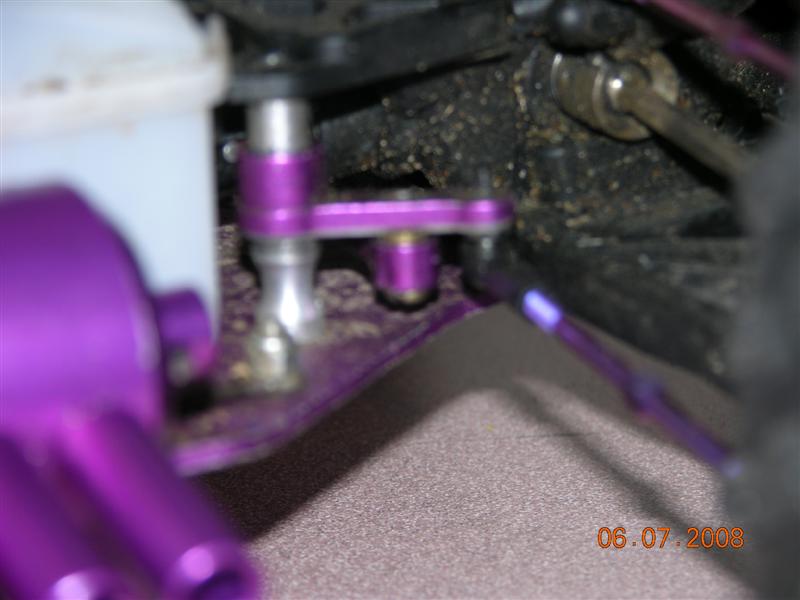

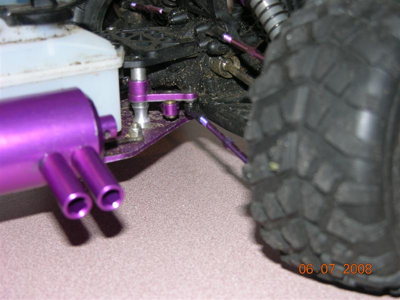

I need some help here. I bought the GPM steering rack and have it installed on my mt2. But the link that goes under the front diff touches the diff. I think I have it in wrong if any of you have any ideas or pictures of installed steering racks I would really appreciate
it. Another thing is the 2 parts that you put the bearings or buchings it will lift up and the bearings come out. I think I have this think right buggered up. I have had so many problems with things not working since I bought these high quality GPM parts [:@]

Give me 5 minutes. Ill take a picture of mine. Im pretty sure you have the bar that goes on the bottom on wrong. I did it too when I put it on till I figured out the problem

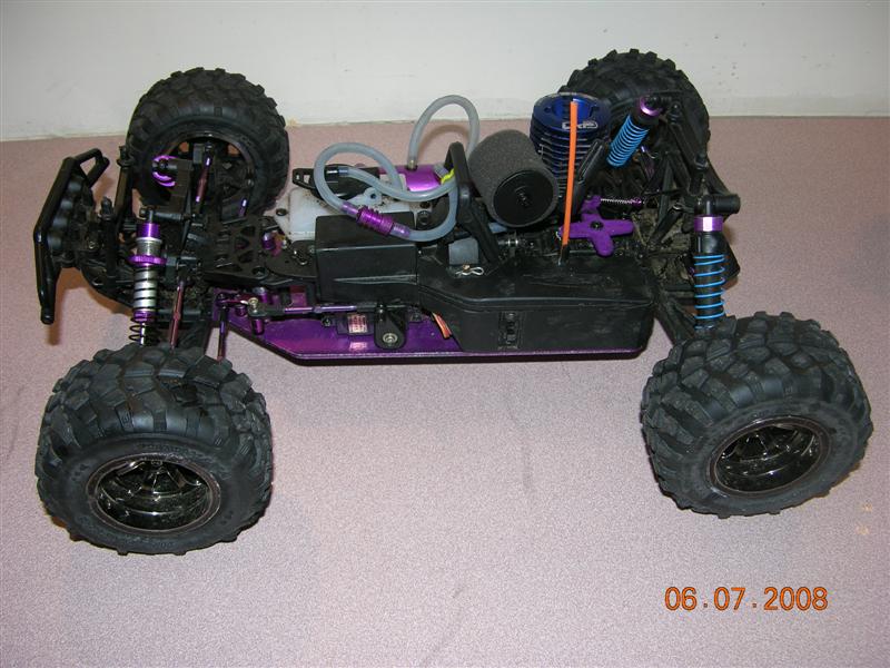

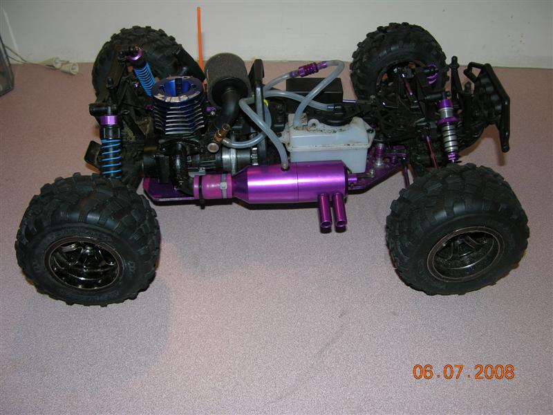

OK hope these help. There are two small spacers that need to go on the bottom side of the steering arms to that the bar clears the drive shaft.

Sorry didnt realize how blurry those 2 pictures were.
Can you see the spacer on top of the bar where the screw is?

oh no something is really wrong here thats how I have the rack intsalled the only thing different is I dont have anything on mine to stop the bearings from coming out. Yours doesnt touch your diff? mine does and the set screw on the diff cup is starting to cut into that link. I guess ill have to make some mods to it.

You could add another spacer between the bar and the rack so the bar sits lower.
Dont you have the silver parts on yours? Thats what the bearings ride on.
