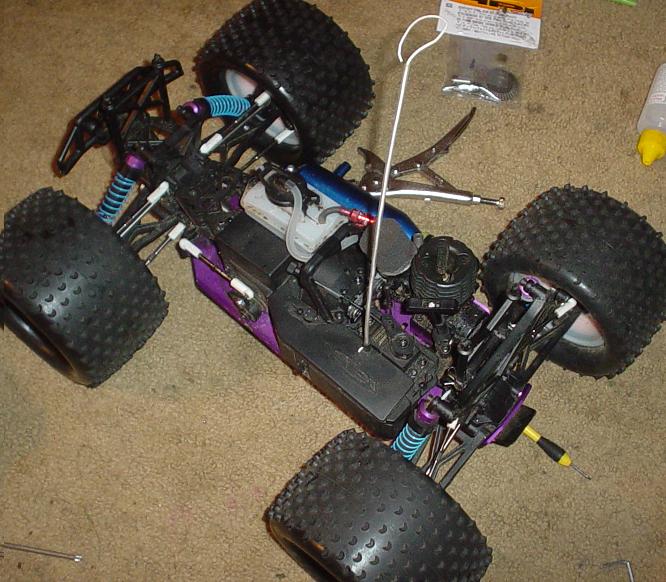

It is, I got it last friday. But I am having heat issues. So I called HPI and they told me to seal it up. Nice RTR...
Anyway while I had it apart, I thought that I would check the pinch, and generally learn the layout of the motor and the ins and outs if you will.
That and I like taking things apart....

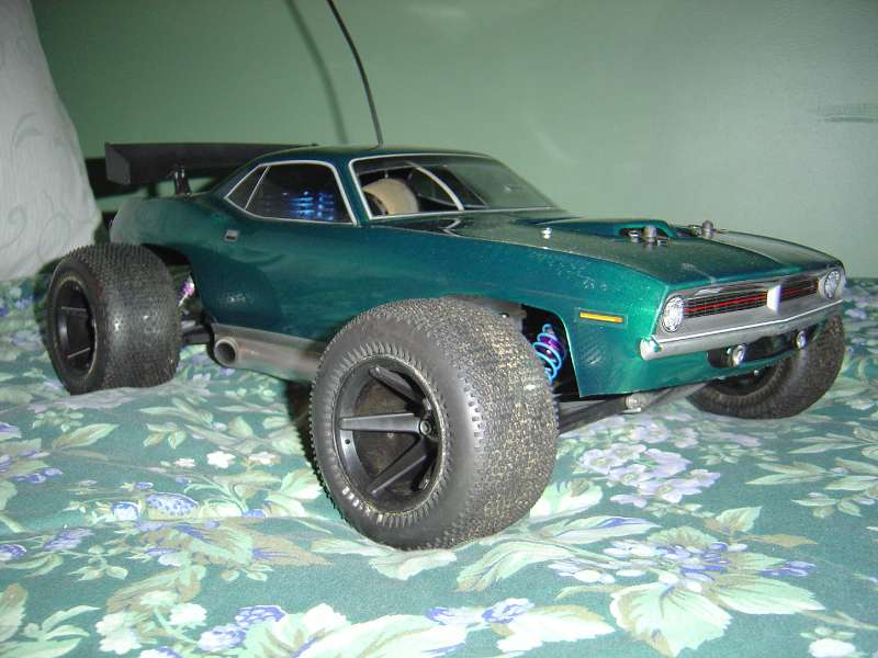

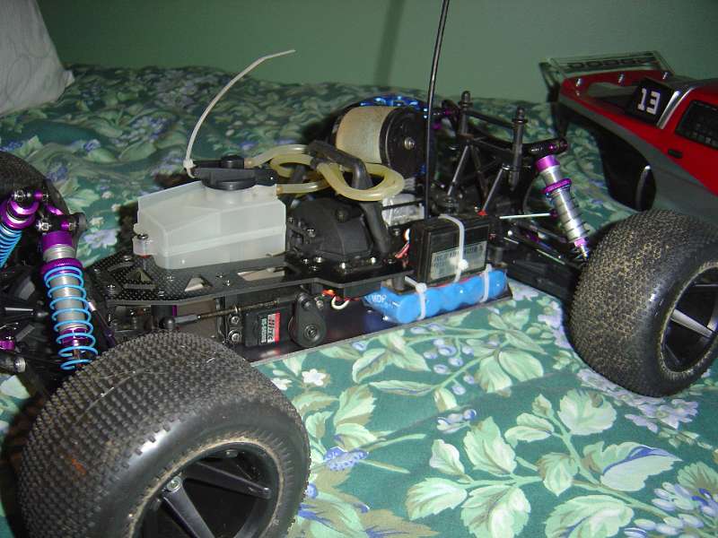

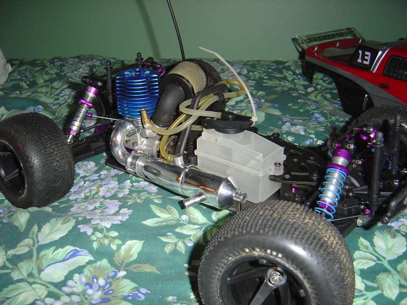

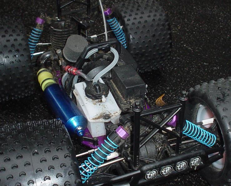

I found the problem
It was the ring gear mesh. The whole diff was allowed to wiggle back and forth 1mm (I would advise checking this), that and gearbox flex made the gears skip and click. It required 6 diff bearing shims and 1 standard axle shim behind the ring pinion to fix the problem. You need to grind the back of the rear cup joint so you can add this shim. I bolted it up and tried to crank one wheel with the rest of the drivetrain seized and it didn't click.
If you are cheap, you could probably use fuel tubing as o-rings, as one of mine broke, and I used a piece.
On my SS, the manifold screws came loose, check those every once and a while. I got confused when I plugged the exhaust and it
kept running.
I use an AE low end pipe on my car and along with the .18 engine it has a great balance, acceleration and speed.
I also now have a metal brake disc from one of my buggies. I had to CA the pad on and drill new holes in the pads, they work great also. Locks them up, I have to dial some brake out.
I have another issue, when accelerating it veers to the left and right when braking, is this the torque steer or can I adjust the springs to counteract it.

Holy S**t those are some big wheels!
I would guess the wheels are contributing to the steering. The Bell Crank on the MT2 is not the best as compared to a RCGT or others. It has quite a bit of slop in it and with the larger wheels this just exagerates the problem. Are you using the stock servo saver? If so I bet it needs to be changed, this will eliminate some of the slop. I was actually in a race and had not realized that the C plastic servo saver had actually worn out - my truck was all over the place - just replaced it and I was fine. I bet those wheels add allot more strain on that little servo saver.

Actually the servo saver has a story to it. The stock one was utter crap, it was weak and had tons of slop. I bought a kimbrough large one and it was too big, the chassis was in the way, so I bought a medium sized one. I used it for a few runs and pulled it aside and noticed on the car it was extremely weak and would not realign the wheels. So I just filled it up with CA to lock it. The inner steering linkage has so much slop and bendyness to it, but more bendyness than slop, it won't harm the steering servo to even rock a solid horn on it. I was amazed at the low speed control, it was almost unreal how it turned. So in the end, just use a horn that came with your servo, it will be more cost efficient and better.
The only slop the linkage has is the should bolted center rod, which you can replace with some turn buckles and ball cups. Though if you get the powerline steering package you should use a servo saver.
If you notice the rear upper links are crooked. I put RPM rustler rear hubs on it and had to mount the studs in the back. Those powerline ones didn't look tough enough.
I broke a C hub while running today, I rammed into a heating oil cap thing in the side of my yard, the wheel busted off it's joints and was flailing all over as the car cartwheeled. I lost a machine bolt and its little spacer, so I used a tamiya standard self tapping screw to fix it. Should I get the C hub aluminum, or the steering block?
