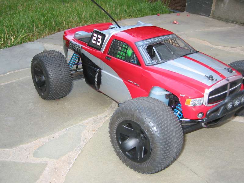

Here are some pics:
ID:	287436   Click image for larger version
ID:	287437   Click image for larger version
ID:	287438   Click image for larger version

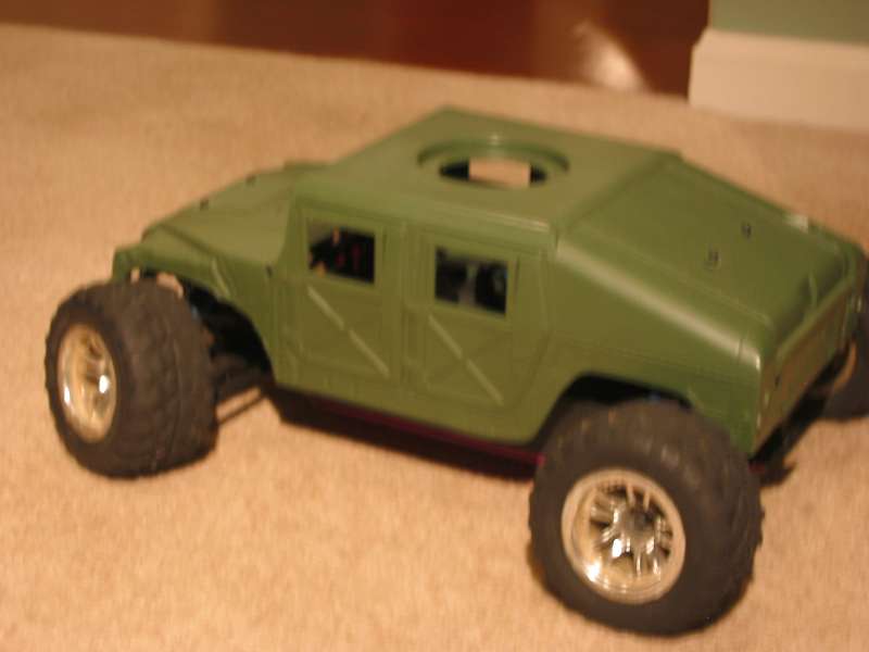

Here are some pics of the humvee body:
This was before the pics i had in the last post.
ID:	287442   Click image for larger version

Thanks whirlydick, here is a list of mods. I starred things i think you need most.
*New Era Models Aluminum Front C Shaped Hubs
*New Era Models Aluminum Front Steering Knuckles
*New Era Models Aluminum Rear Hub
*HPI Aluminum Hex Hub Clamp 12mm
HPI Blue Front Springs
HPI Blue Rear Springs
Proline BowTie M3 Compound Tires
HPI Type F5 Truck Wheel Black
HPI Sway Bar Set
HPI Titanium Turnbuckle Set
HPI Racing Fuel Tank 100cc
Tamiya Humvee Body (Stopped Using)
HPI Dodge Ram Body (Currently Using)
HPI Heavy Duty Clutch Bell 15t (Needs Engine Mounts which i don't have yet)
*Dubro Blue In-Line Fuel Filter
Dubro Blue Fuel Lines
*Dynamite Micro Failsafe
*Dynamite Hi-Flow Air-Filter
Soon To Come:
Tamiya Lock Nut 4mm
HPI Universal Dogbone Front
HPI Universal Dogbone Rear
HPI Engine Mounts 20mm Purple
O.S .18 CV-RX[>:]
THS Racing Tuned Pipe
Proline Sand Paw Tires

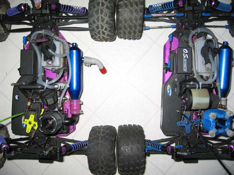

Default RE: Official HPI MT2 Thread
Hi everyone!
Once i was worried about torque of 18ss engine. I still was able to blow my rear diff[:@]
Now my diff is repaired, two teeth was missing. I allso sealed rear diff with silicone and put 5000wt silicone oils in.
Maybe this diff problem was caused by too tight slipper clutch (???) Anyway i adjusted it again, it can't be set any "looser" than it is now. Still it needs quite much pressure when i roll spur gear with my finger to make it slip (tyres allmost slip on the floor before slipper does slip).
Anyway, let's see if my diffs can handle THIS
http://putfile.com/pic.php?pic=6/17512180540.jpg&s=x2
Engine and new tuned pipe (and new tyres) was mounted yesterday. Break in is still in in progress - i have not really leaned it out yet... but what i can allready tell you is this thing really flies!!! 2.1HP and massive torque.... wow.
This (thunder tiger pro .21) engine has "E-start" system (with cordless drill). I broke my 18ss pullstarter (as you can see at the picture i posted), i will not have that kind of problems anymore, heh!
18ss engine will be mounted to my another car someday in the future.
