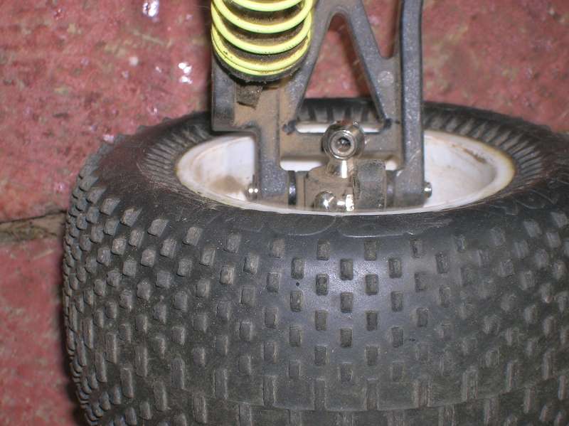

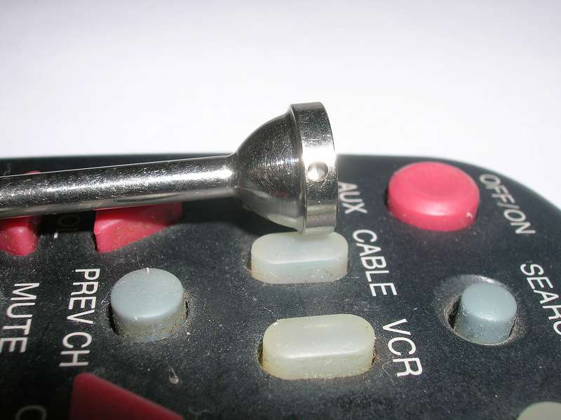

OK this is weird i stall then i start back up and the little pin is missing from the cv shaft the thing that holds it together where it bends....PICS! question is is there someting that can re-place it for the weekend..bc i cant afford 18 dollar shafts...like someting that i can stick in there?

i have used a paper clip on a MGT for a TEMP fix. wouldn't leave it there long though. It takes a little trimming to make sure that everything clears.

Ok, I hope you have a little extra rod on the end of your brake linkage, because the stock linkage rod fits in there PERFECT. I have rebuilt about 5 CV shafts with homemade pins from that linkage rod, and they all worked fine.
It would be a good idea to pick up a stock linkage set to chop up for extra pins. I always carry two precut pins with me wherever I go, just in case I lose one.

ok....or do i tighten that little aleen head screw to make the shaft stay in there?

When you put it back together, use red loctite on the set screw and get it good and tight. Then get some heat shrink tubing and make a boot around the cup to hold the pin in of the set screw backs out any.

Tighten the screw, the original fell out because the screw backed out a little bit.

I know this is not an HPI but on HPI web site what they say is to grind a small flat spot where the allen screw seats on the pin. I know it helps as I was had trouble with the pins falling out of my MPI CV on my HPI MT Racer and I ground a little flat and it works a lot better. Yes and use loctite!

Won't do any good. The pin rotates in the cup as the entire assembly turns, it's parts of the mechanism that lets the CVD work at various angles. The first time you drive it it'll just break the superglue.
