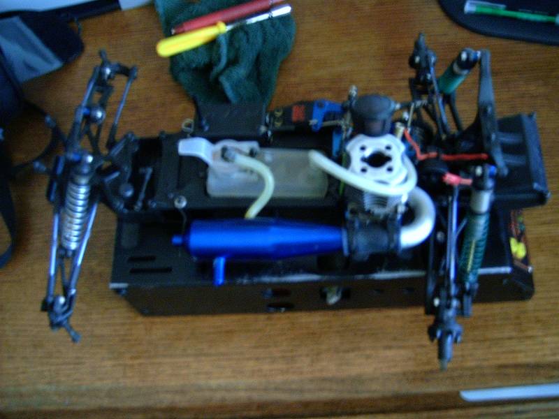

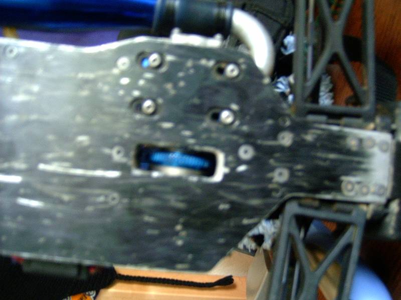

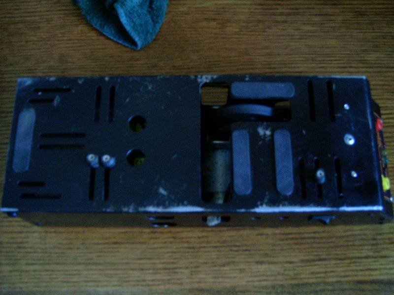

Grind out the slot on your chassis and heat that motor up to over 200. Here are some pictures of mine set up on my box.

I am having the sam problems, too. But I am running the Dynamite .12 and the pinch on that beast is pretty tight as well. The instructions on AE's site are not even close. I am running on one peg up front to keep it straight on the wheel. I might consider cutting the chassis some later, if I have to.

whatever you do, don't try filing down the rubber starter wheel while it's running... it doesn;t work
yeah the chassis slot is way too narrow and the starter box isn't the most powerful either...

We cut the wheel down on the edges while it was going and it worked fine. I am still playing with the mounting however. Its just a bit of pain to get it to work right. Is there anyway to get a smaller wheel like for another starter box. I just dont want to cut my chassis.
