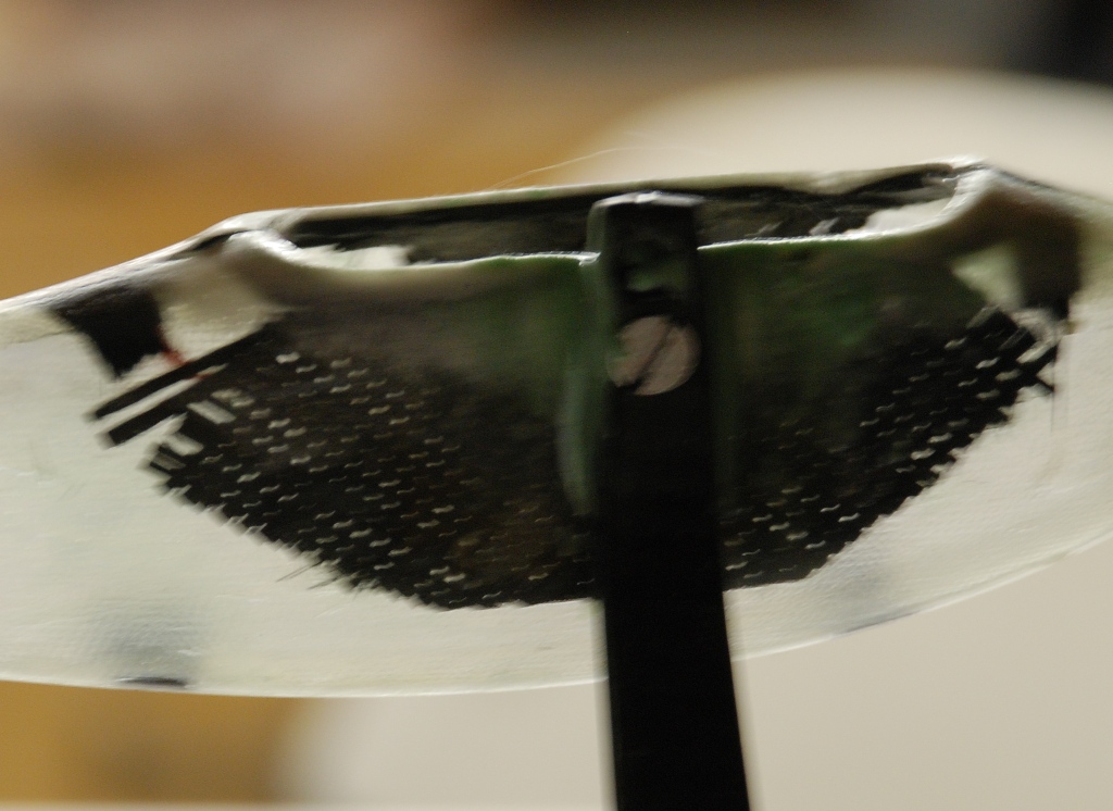

Made some more progress on Delta. Installed the adjusters and lock downs on the wing. It's a big plane, 78 1/2" square,

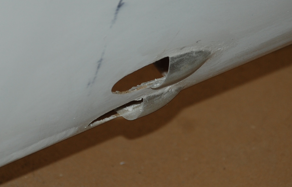

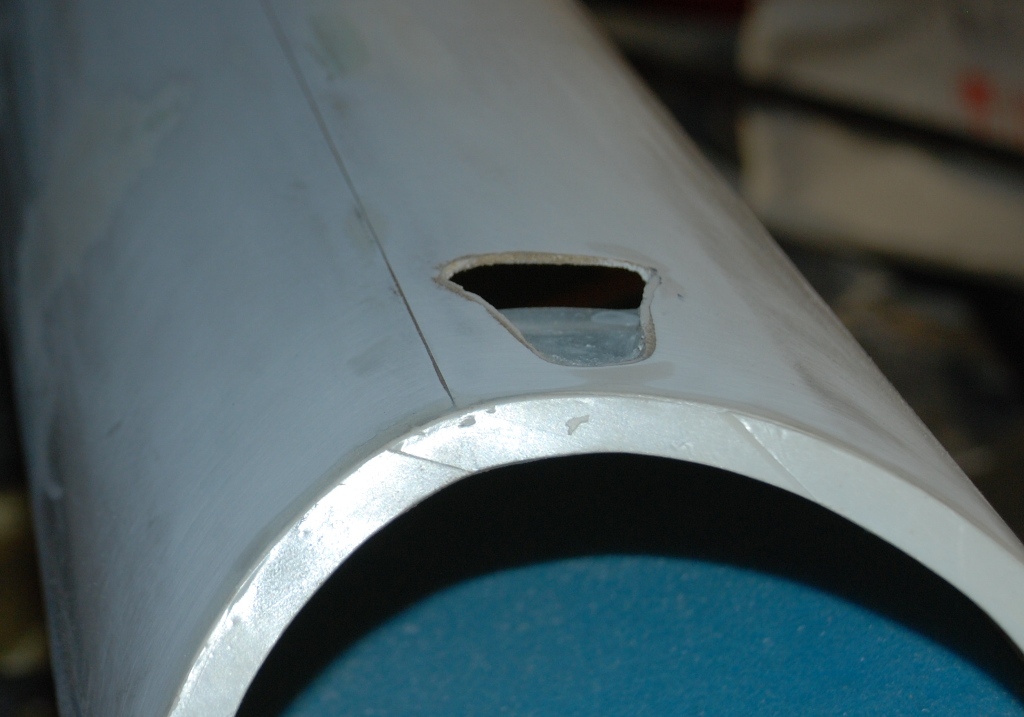

Completed the chin cowl treatment. It now sports a header hood and hot air hoodedexits for better engine cooling
The pipe needs some extra cooling air hence the naca duct to make up some of the air lost out of the chin cowl.
The inside of the cowl was treated a little different by adding some composite reinforcement. The chin cowl will sit on its crutch at this area and in the past it tended to buckle cracking and flaking the paint. It won't happen this time
At the fuse rear additional air exits were installed to vent the pipe

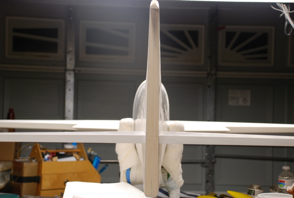

Fully assembled fuse is very large but light....The canopy will also sport a dorsal fin as yet not built. Been preaching the benefits of dorsals /ventralsfor manyyears now. Nat Penton was the first I ever saw that sported these 30 years ago and they are finally being accepted as standard faire since schedules have caught up with the design concept
Wing to fuse fit and stab to fuse fit snaps. This is straight forward to get perfect. I add teflon tape to the fuse for release purposes and then fill the joint accordingly. Teflon tape is sticky on one side which makes this chore really elementary.
The fuse center section treatment is shown in one snap. The honeycomb laminate was made by me, controlling its weight. It's two layers of 1/16" with 3 layers of 1.2 oz glass cloth. Carbon is unnecessary; would have looked great but would have been heavier
