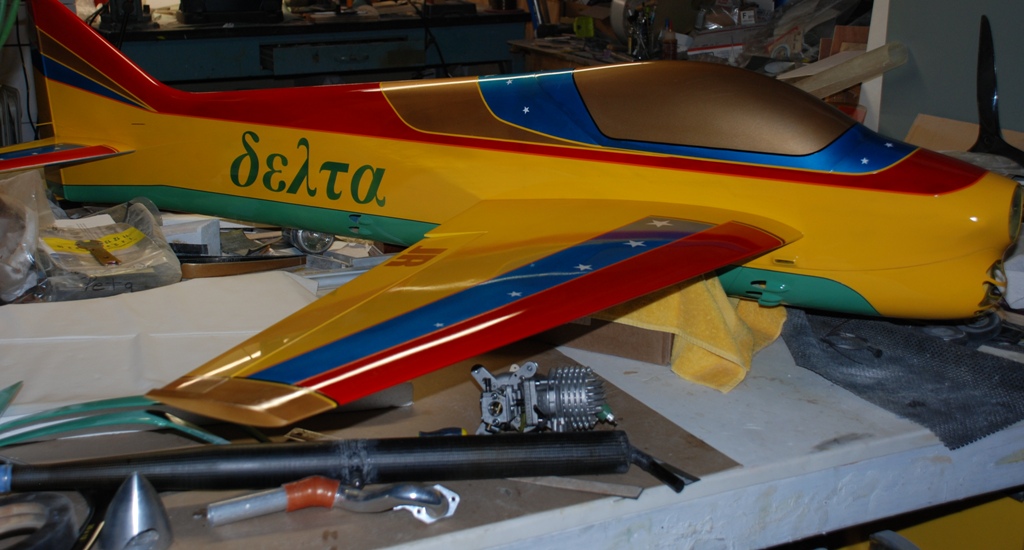

No maiden yet.....Been away on business. Also the constant nagging leg problems are persistent, taking the fun out of it for me. Haven't flown in 6-7 weeks.....
Did manage to start the DLE this afternoon. I love petrol stuff for it's lack of rust and general lack of maintenance requirements. The engine had been on the shelf the better part of 2 years, yet, after a slight amount of coaxing (15 flips maybe) it came back to life. Powerwise, all I gotta say is awmygoshki....It's gonna be fun
Four pounds of powerplant

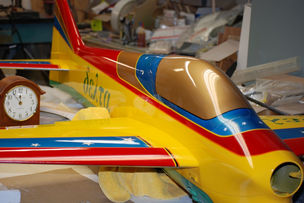

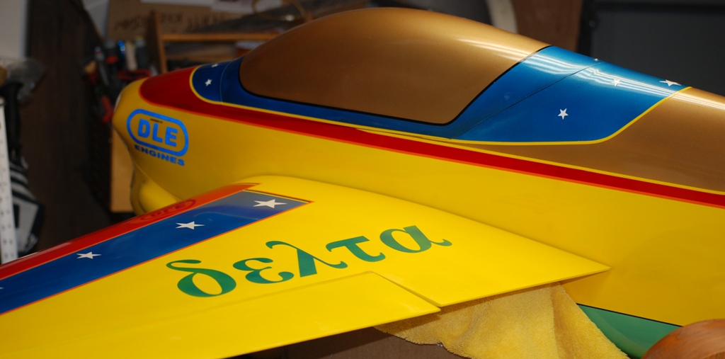

A few Delta snaps. I pay particular attention to fits. Here are the cowl and canopy</p>

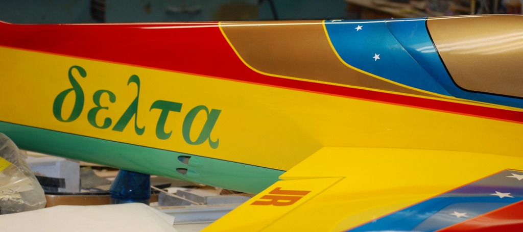

Snaps. Simpler paint job is lighter. I may change some gold areas for white at some point, if I can't see the model

On the paint job, look from 5 feet away. It is very sheer and can just about see through it in spots. But it accomplishes the intended task
Matt, what paint did you use? Colors looks good together!!

Met blue and met greek gold were polyurethane, Omni. The others were Klass Kote epoxy

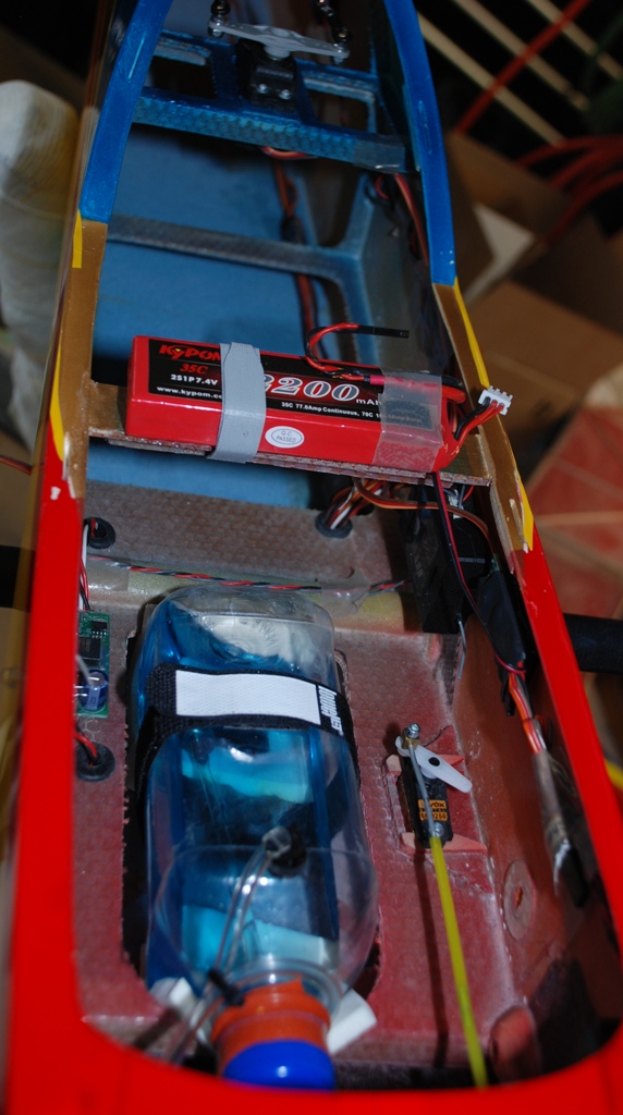

Here are some more snaps of the finished and equipped model. The tank set-up is the typical 2 line set-up that is so simple, even I can do it. The vent is simply wound around the tank's stem and the feed line is tee'd. So many folks flying gas insist on complex solutions for fuel systems........

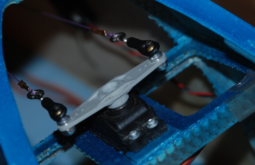

Radio set-up. Neatness counts. The grommets are standard rubber types that do the job of wire protection just great.
The IBEC, VReg and RX are velcro'd in. Come to think of it, so is the tank and battery. I like the battery up top for easy access. I remove the LiPo from the airframe to charge
I've used eye screws to set-up pull pull forever. These are standard McmasterCarr issue

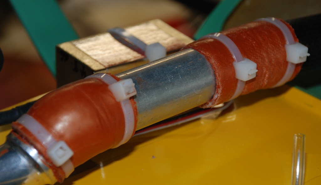

Engine treatment.....
I didn't take any snaps of the rubber iso mount and the nose ring arrangement. I have photos of those set-ups early in the thread
I've discussed the coupler arrangement before. It is molded (shaped to fit) from ceramic and Permatex Ultra Copper. The plastic tie wraps are plenty to hold them in place without melting (spun alumina is a great insulator). Should work well on YS exhaust too
The spark plug wire usually comes with a spring clip that is a total pita to work with. My solution is to toss the spring clip and add a short length of silicone rubber. It holds great but allows simple plug cap removal
