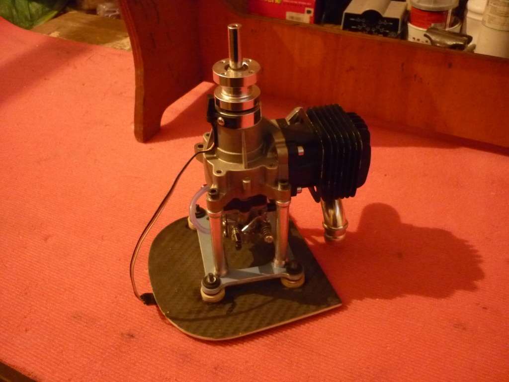

Hello
Find attached pictures of installation engine PTE36R and RCGF32 with 4 silent-blocs without nose ring.
It goes well.
http://shop.hpceurope.com/fr/categor...%C3%A9caniques

Something new,prompted bywork Rob from UKis doingwith his engine mounting, I am looking at bringing the rubber iso mount to the front of the engine thus eliminating the need for a nose ring altogether. The experiment hasn't started yet but the design is sound.Nevertheless, havingthe stand off mounting lugs near the front of the engine and closer to the engine's CG will facilitate that work
