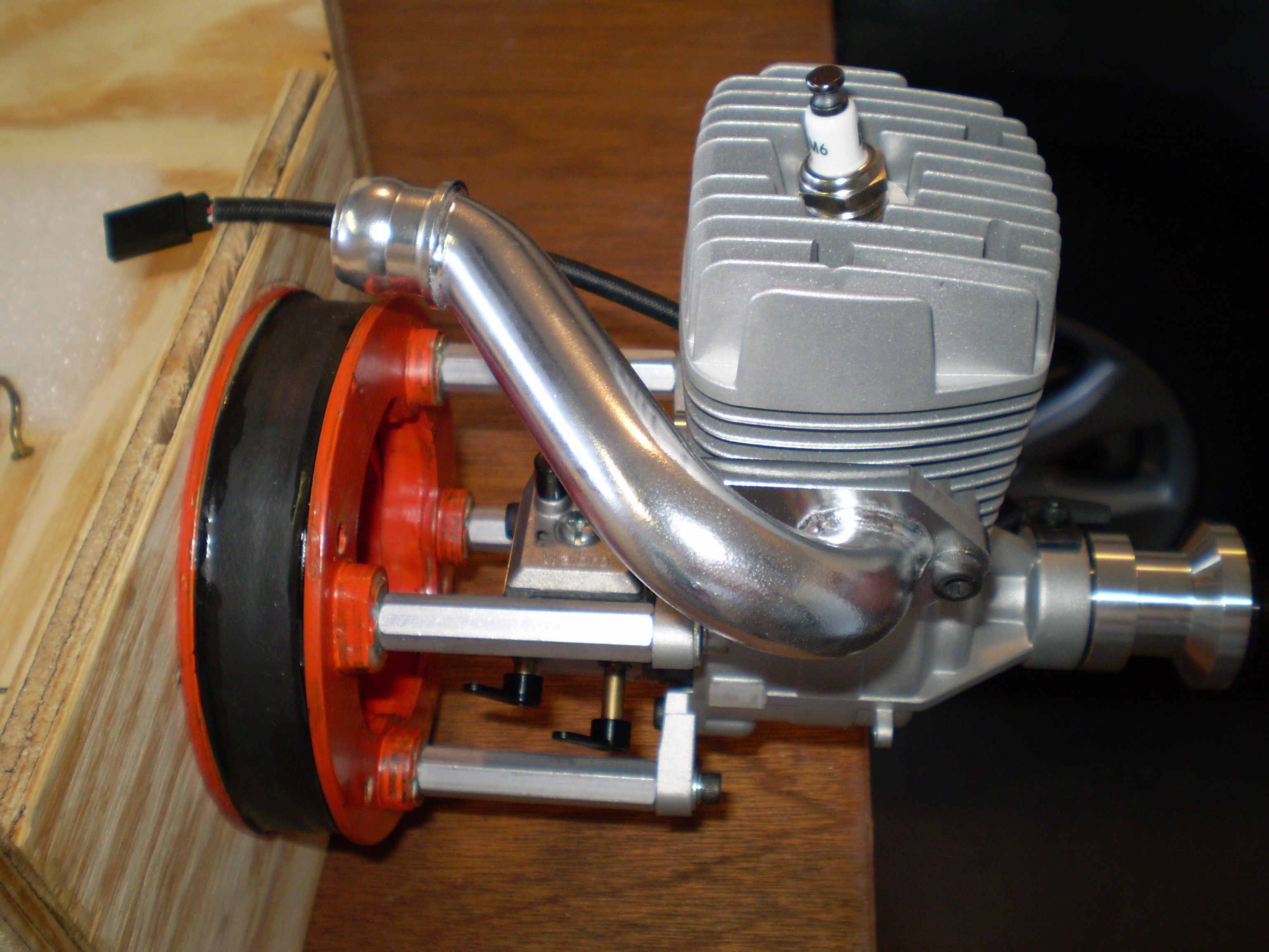

About ready for a test run to see how the mount holds up. Mount weighs 3.5 oz. Seems pretty robust.
Matt, are you still selling those fancy homemade couplers?? If so I'll buy some from you. Until then I'll bench run with some old aerotrend blue couplers I have.
Mike

Hi Mike,
It looks fine. Don't forget the extension. The reflector baffle needs to be 27" from the exhaust flange, following the curve of the header. I'm using about a 3 1/2" extension on my set-ups.
For trouble free operation, don't forget to install a couple small button head screws on straight exhaust tubes. Drill and tap for 4-40 x 1/8", at 3 places around the pipes. The header's bump works fine as is.
Yes I make the couplers available to any one or I can explain how I do it for the do it yourselfer. These cost 10 bucks each plus 5$ S+H. I use ceramic fabric (silica or alumina, good to 2000F+). Chances are good fiberglass or carbon would work great too, but I haven't tried it. Once the sealant is burned off inside, only the fabric is exposed and just works great for years now.. The aerotrend might last 10 runs, enough to figure out where the tune is. Start at 1 1/8 turn on the LS needle and 1 1/2 turns on the HS needle. Suggest you have a Dynatron handy until you learn what the beastie needs. Then, it's usually 1-3 flips.

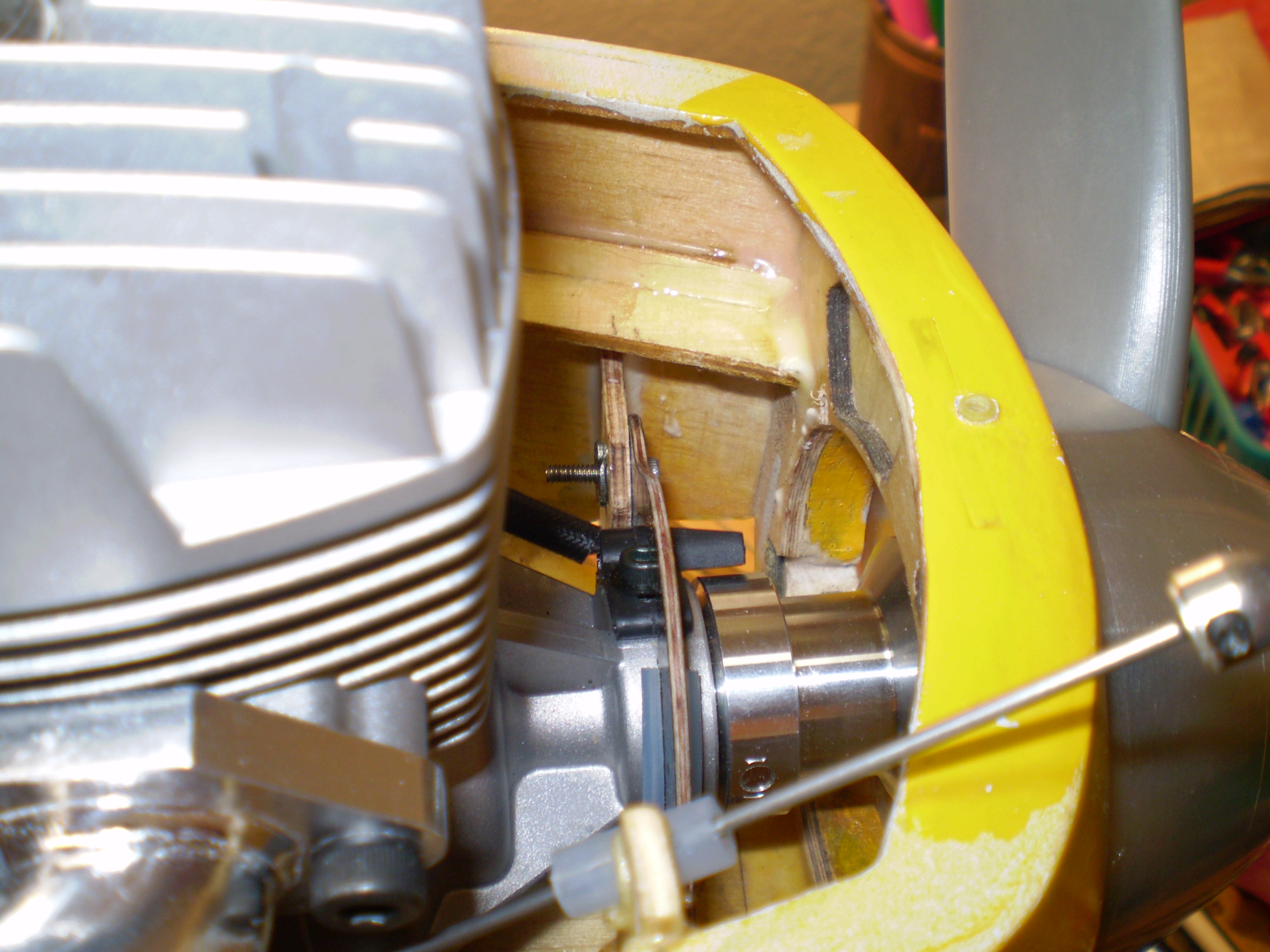

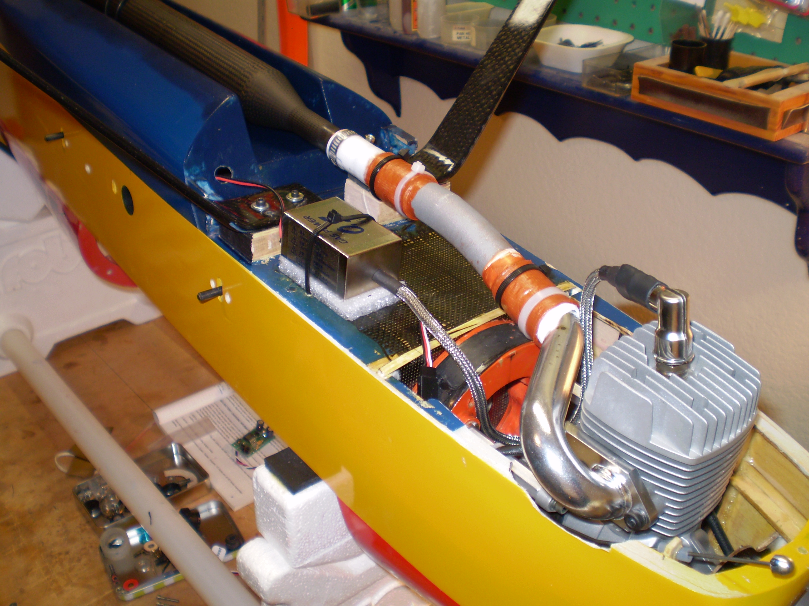

Update: attached pics show we're about ready to go. Waiting on a battery and recommended prop. Installation was not as bad as thought it would be. Just different being gas with the standoffs and linkages. Mount has passed test runs so not worried. I'll update again once flown a few times. Should be cool to compare the gas motor vrs the YS 160 originally installed & flown in the plane.
Mike

Looks like good progress. The 33 puts out about similar power to the YS175. It actually puts out more top end (which we never use) on the same props...but it's the mid range that will surprise you. You simply point the nose and add throttle for effortless verticals.
BTW- The early props I used during break in were 18.5 x 9.5 wide blade (I had one so I used it) and then the 19x11. I quickly (within a couple gallons) switched to the 20x10.5 PN apc and that has been a terrific match. Most recently my hand carved 20 1/4x 12 Narrow blade has been working very similar to the apc. Same noise footprint and similar thrust output per throttle setting. But this wood-carbon composite is only 77 grams, shaving 3 ounces from the nose.

Claude, yes the pipe is a ES Comp 30 CC I used on my YS 160. Set the distance per Matt's recommendation around 27" to the baffle.
