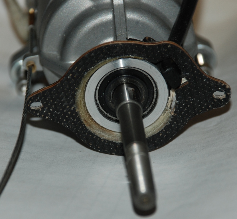

I have no idea how good a pilot you are or what class you fly. It will be as competitive as you are a pilot. Powerwise there is no issue. If you use the muffler instead of a pipe, it will be loud and distracting so I'd suggest against that
Anyway, here is my nose ring set-up. The ring is 2 layers of 1/32" aircraft ply laminated with carbon cloth. The center hole is oversized and note the recess that surrounds the Hall sensor. Then a rubber ring is installed which is a snug fit around the case bearing housing

Some more. Note the tight but adequate clearance in front of the Hall sensor. There is 1/16" clearance there after some careful carving of the Hall sensor housing. That's all that's needed to secure the nose of the engine

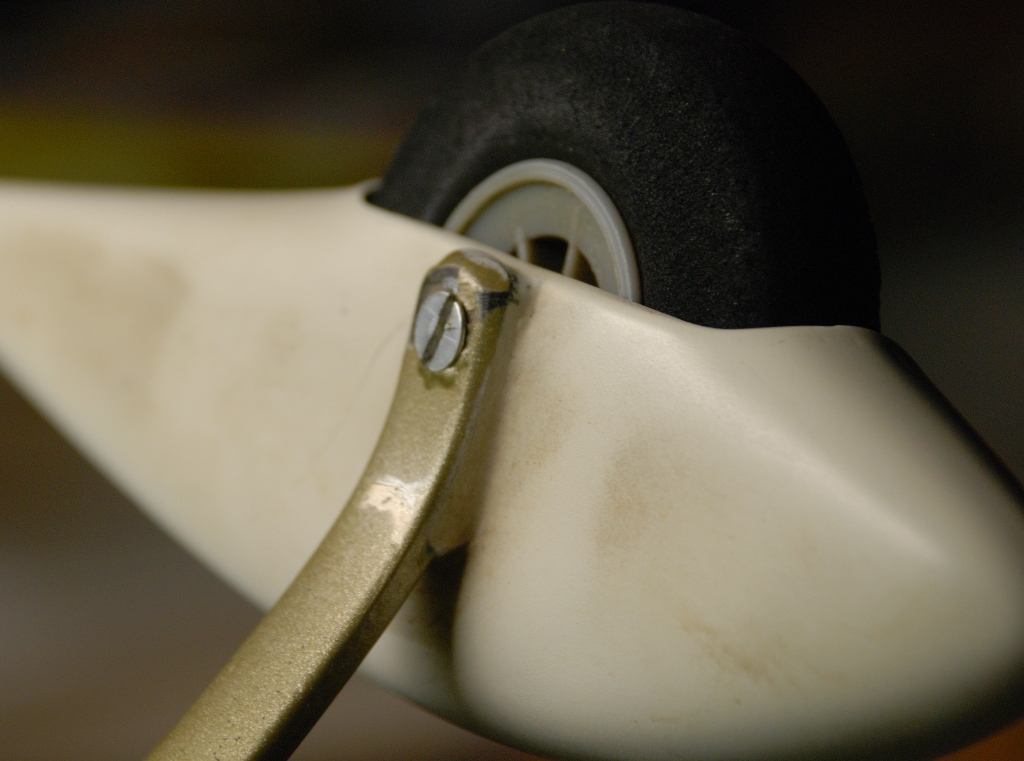

Mike Muller wanted to know how I fasten my pants and axles on the landing gear so here's another short pic-tutorial. Maybe this one needs its own thread but.....
I make the pants and gear struts so customizing is no big deal. The aluminum threaded nut hard points are installed during pants lay-up on top of the carbon cloth reinforcement. Alignment is done in the mold. If anyone wants pants done this way it is straight forward to do on commercial pants too. If you want me to make them, they are not cheap!
I glue the pants onto the struts. Some noob was saying never to do that....well sorry to disappoint but this works better than anything else available and is super light. Been doing it for at least 10 years this way. Anyway, I'll let the pictures talk
EDIT*** note how the spinner is mated to the nose of the plane. I leave clearance here on purpose to allow some cooling ram air. My reasoning is simple: this air in the immediate vicinity of the spinner cone is some of the most disturbed, swirling air on the plane. I let it enter the engine compartment to help carry some of the heat of the crankcase eventho the crankcase is cooler than the cylinder. It helps
#311
The axles are 8-32 aircraft grade aluminum bolts. They work fine on an 11 pounder but remember that my struts are designed to be strong but springy. They take most of the landing abuse so the axles don't have to. Springy struts also transfer lower loads into the airframe.
BTW- in case you're wondring how heavy this whole set-up is, the RTF weight of the whole landing gear is less than 5 ounces. Also, the technique I've devised for mounting thegear is very light adding just about another ounce to the the whole gear set-up in a plane. Look that up in my Derivative thread if interested
#313
ORIGINAL: vatechguy3
what is the tan colored material on the back side of the nose ring, shown in the pic on post #307?
thanks
tony
thanks
tony
#314
MTK, I love what your doing here, I'm all for the idea of finding a gasser with performance/delivery that we're after.
The only thing that causes concern is the nose ring/hal senor problems and it's great to see you're making progress.
Still, the cut out for the sensor and the critical positioning of the nose ring due to the sensor mount still doesn't look like the optimal solution.
Couldn't help thinking that if you have access to a machine shop, why not try doing something like I've illustrated.
A smooth round machined collar thats bolted to the crank case encapturing the sensor/mount and providing a solid base for a traditional, albeit larger nose ring.
The width of the collar allowing plenty of flexibility for engine movement.
Of course I've draw it solid to explain the point... but it could be skeletonised thus saving weight, not to mention making it rather pretty.
And F3A guys love those pretty bits!
Keep up the good work and call me when you've machined a few. I'll have one.

#315
David, thanks, I think....
Actually, the real sensing element is far smaller than the housing. The real sensor can be glued to the crankcase and reduce the footprint substantially. But it's too much fussing and not really necessary......
Yes that was the original device I came up with also and in reality, if it surrounded only the sensor element, would be far smaller. I spoke to Todd Syssa about making a few of them but that never materialized.
I've considered getting a combo lathe set-up but that's not in the cards right now.....I don't have easy access to a machining center so I dropped it for something I could build at home with hand tools. Indeed my sub-ring was "skeletonised". Weight would have been around 7 grams or so, if built from ally. I haven't completely discarded the idea of making a mold for plastic parts. It's on a back burner
BTW- the nose ring design I show is not a prototype. It is a fully functional device that has seen service in several airplanes and 6 different engines in 3 years of flying, (lessee, 2 SAP180's. a DLE55, a Mintor 38, a ZDZ40, the current OS33 and will soon see service on the PTE36) some 30 gallons of gasoline and some 150 hours of service. It works great! Try it......
