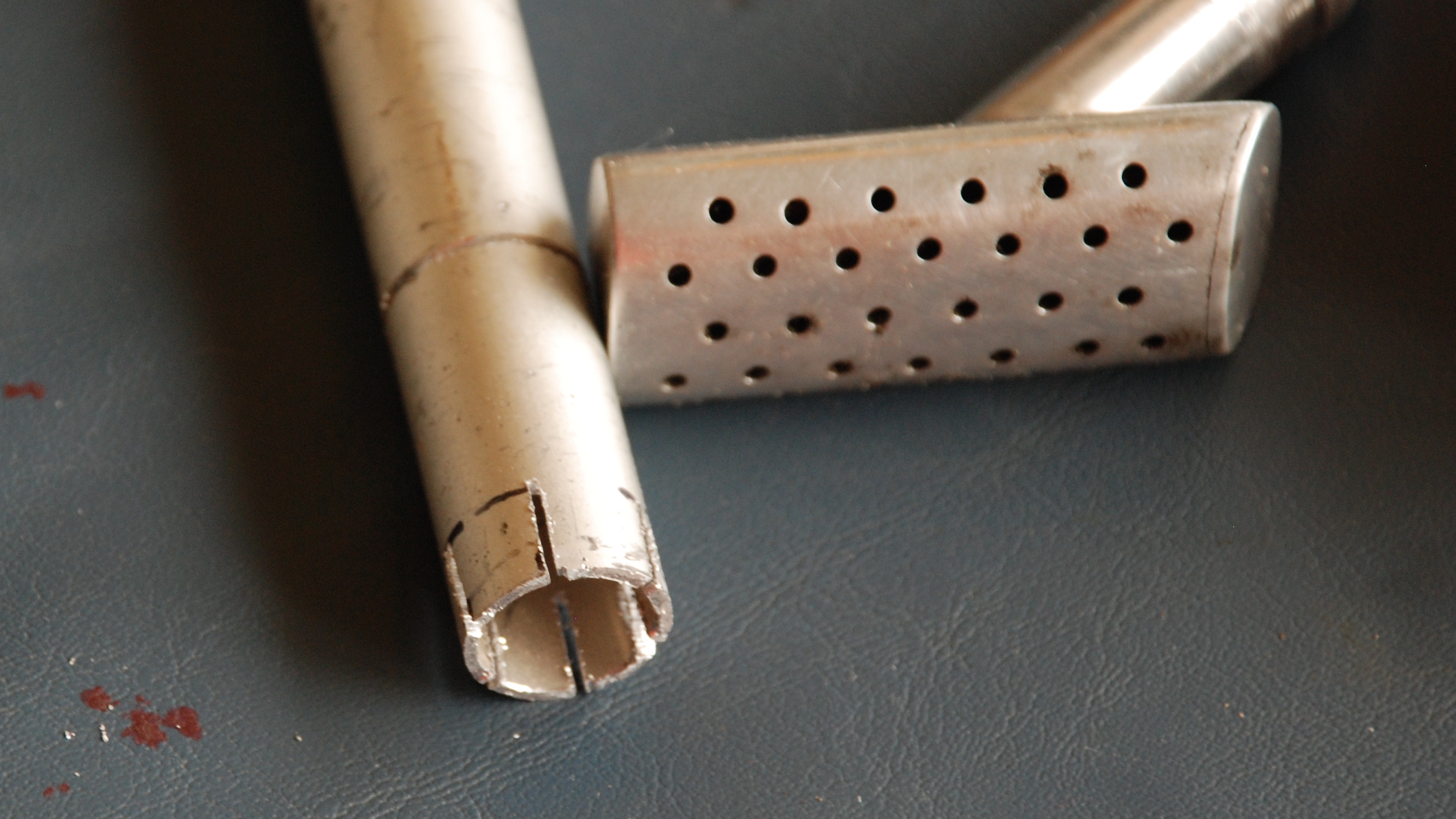

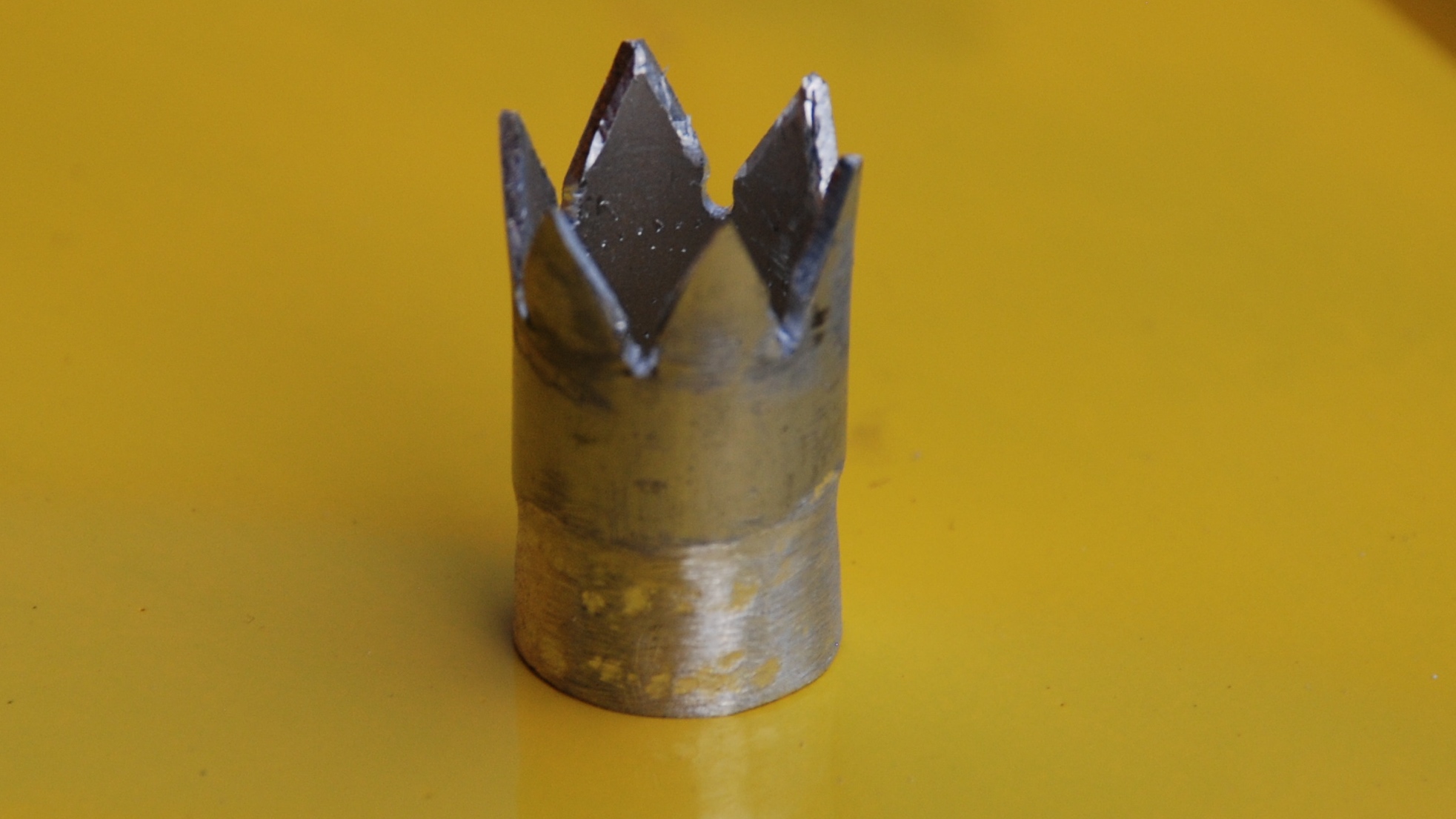

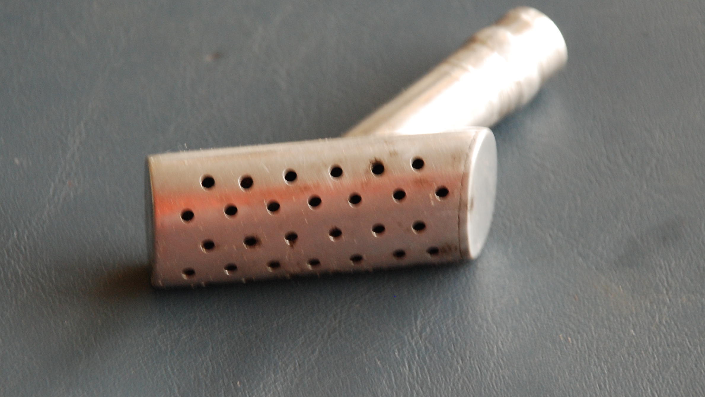

Don't forget that a soft mounted engine drops the dBs a lot. Also, an exhaust disperser produces a mellower sound. The late Karl Mueller made these for the guys. Since they are no longer available, I came up with an alternative that works surprisingly well and is lighter. I'l take some photos and post later.
It's made from a 1" length of aluminum tube, 1/2" diameter. I used typical hand tools for mine but a mill would make small work of this device. One end is cut to produce 6 teeth of about 1/4" in length. Teeth are then bent over coming together at center. There is just enough room remaining forming slits where the teeth come together, which work well to disperse the exhaust and its note.

I'd be interested in seeing your disperser. I'm pretty sure the noise is pretty much exhaust driven as the cannister noise was a lot more tolerable and the level was very acceptable. One guy at a contest thought it was a ys, the land owner of our local club said he thought it was as quiet as the electrics. I'm also thinking a prop with a little more load could help change the exhaust sound. Hard to find a carbon prop to fit the bill. I'd kinda like to stay away from the apc as I don't need the nose weight. PT makes a 21x10 I may give a try.

Hmmmm... My whole mount including the stand offs weighs less than 4 ounces. I've written before what I do with mounts but may be worth repeating.
The stand offs are 5/16" hex with 8-32 threads, 1 1/4" long I think. McMasterCarr off the shelf item. The mount is the rubber iso mount I've discussed many times before. Its weight is around 2 1/2 ounces. I use 8-32s because the soft mount doesn't require any heavier for this small engine. Probably could use 1/4" hex and 6-32 bolts on 30cc class since I use the 8-32 on my 55 and 60 cc soft mounted set-ups too. The typical 10-32 is fine only for hard mounted set-ups; it's considerably heavier and the stand offs are very heavy. My 4 stand offs are about 1 1/2 ounces.

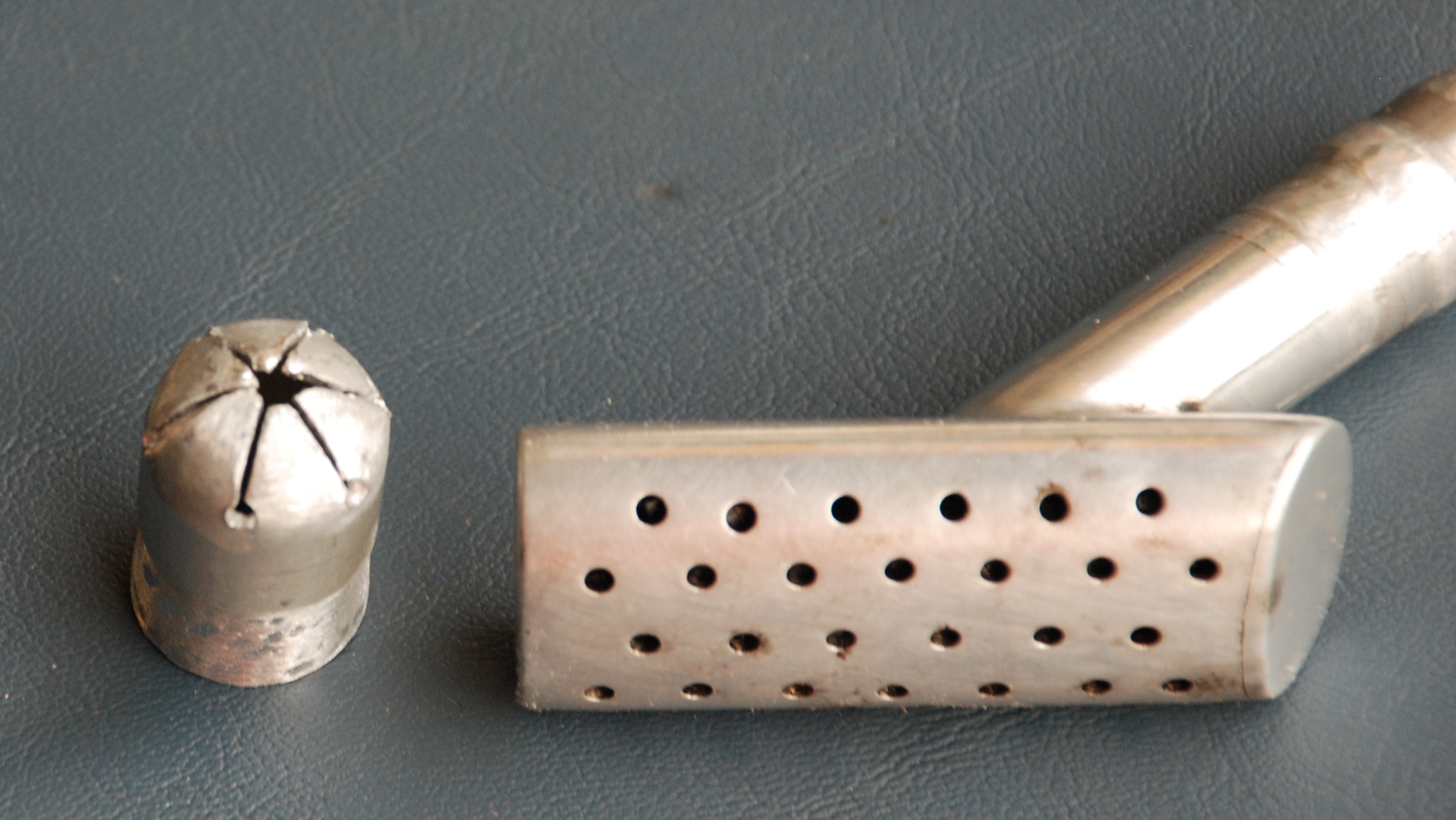

Motor took a dump today 10 minutes into the flight. Just lost power and quit. On the ground no compression and clicking noise. Will prob need a new ring and liner I would imagine. This is the second motor that's had a big problem. 1st one lost the c clip off the piston rod, that didn't go well.
So if I send it out there, they don't have any pistons, if it would need that who knows how long it would take. I suppose if I tear it apart myself to find out what exactly is wrong they'll void the warranty, who knows if they'll warranty it anyways. I've seen others who had this problem and they didn't end up happy. Something about warped liners.
I could just tear it down myself and order the parts straight from japan for half the cost of hobbico and put a bowman ring in it.

Let me see if I can post. It's a new computer and I haven't figured it out yet. The Karl Mueller after muffler is shown for comparison to the ally tube which is 1/2 inch. The tube's end is sawed into sixths and wedges are snipped with cutting pliers

Then with a triangular file which actually works out perfectly in regards to angles, the wedges are shaped to final. Then the wedges are lightly tapped to final shape. The slits are the width of an Xacto 11 blade. The holes are 1/16". The original prototype device is shown on Delta's stinger

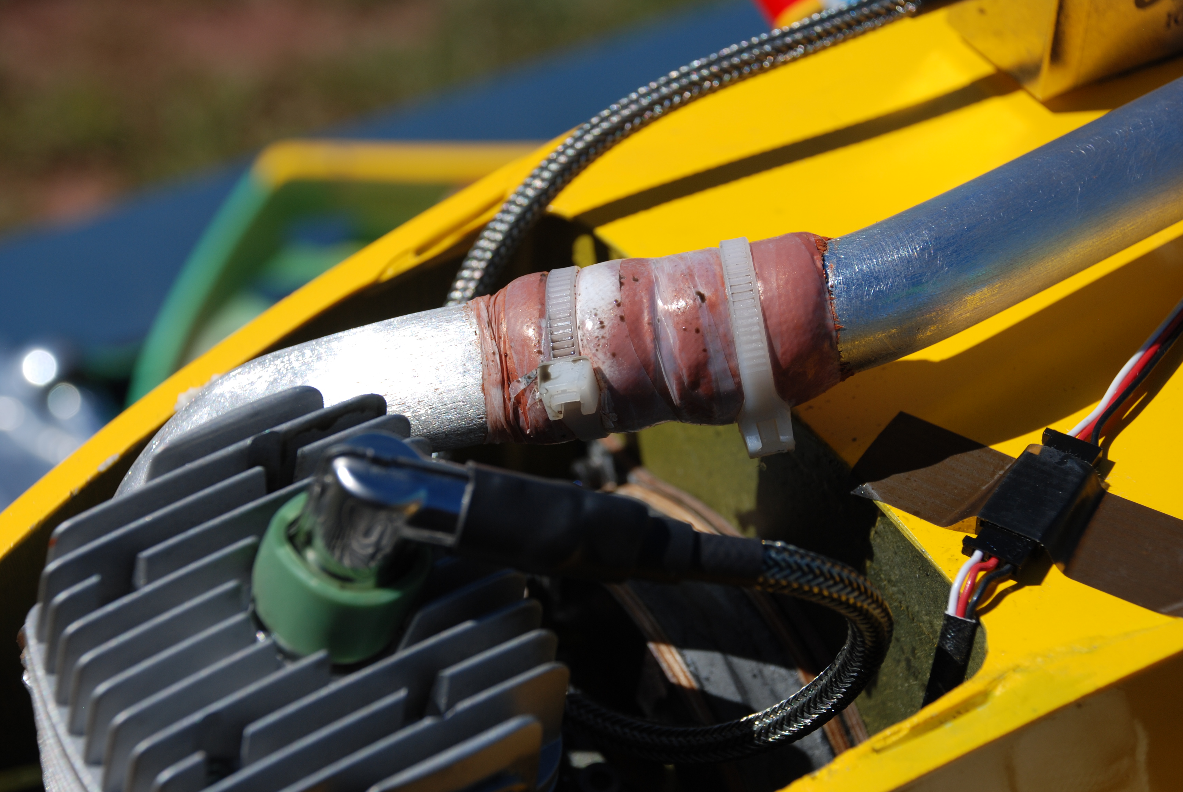

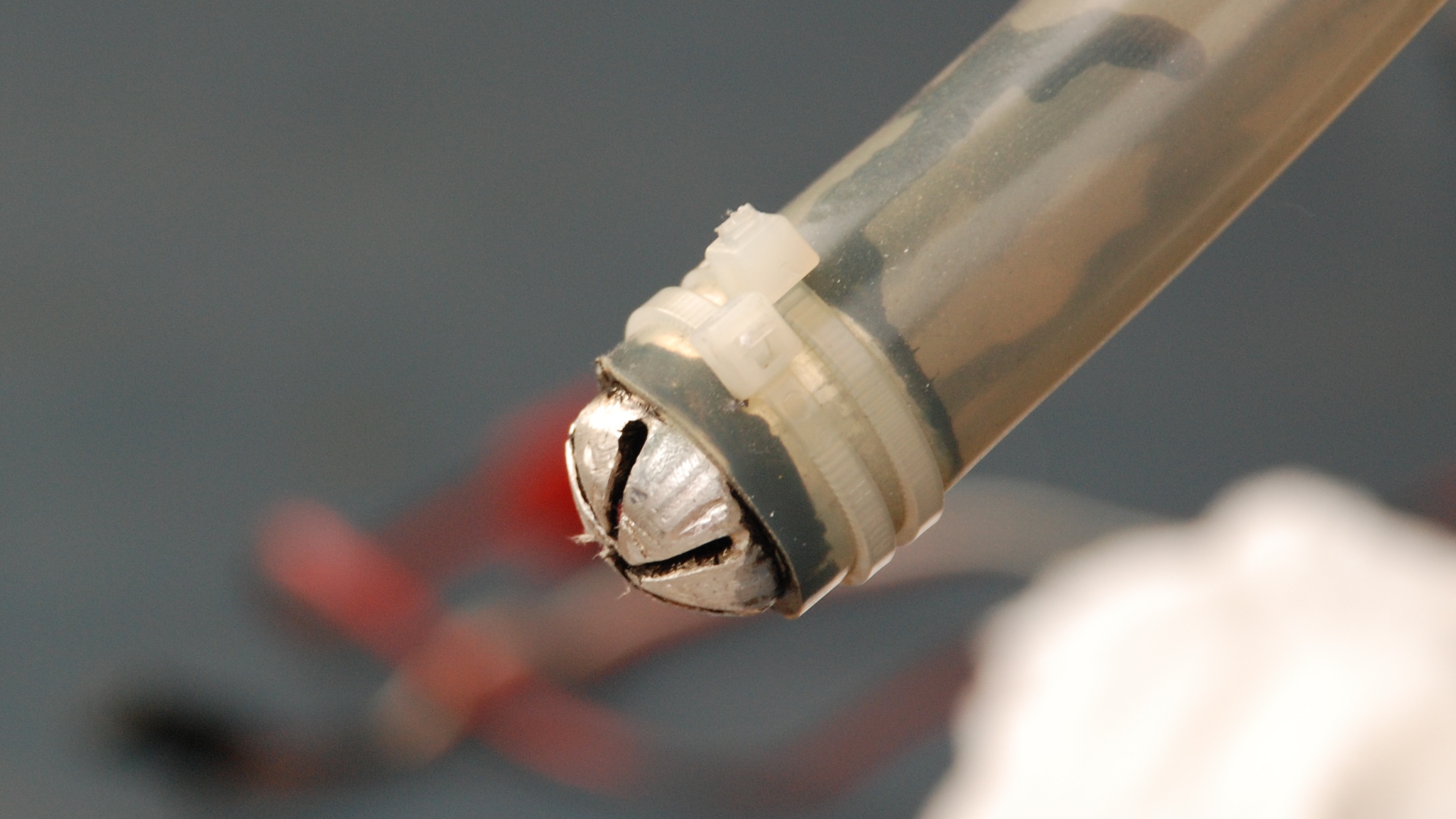

Geez, sorry to hear of your problems. I'm almost embarrassed to say how much flying my number 1 engine has delivered. Still strong in it's 5th season. I don't think I'm doing anything unusual. I use MC1 Racing Synthetic from Bel Ray at 50:1 mixed in avgas. My needles are 1 1/4 LS and 1 5/8, actually a hair less, on HS. It's turning the 20.5 x10 PN at over 7K. Terrific idle.
I've paid lots of attention to cooling both the engine (notice the shrouds that suck air out) and pipe (note the NACA inlet just aft of the chin cowl). Here's a couple pics

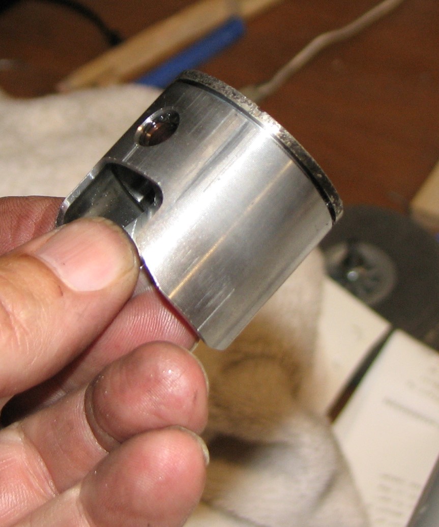

Tore down the motor. Not sure what to think.
Looks like some metal went through it. Top of piston and cylinder head had shrapnel. Side of piston looks scratched as well as liner, piston looks worse than the liner. Ring seems to be intact, though it was stuck. Can't find anything that came apart in the motor. Crankcase was clean and looked good. Bottom of cylinder head where the plug opening looks weird. Is that the way its supposed to look?
Was running HP ultra 50:1
high needle was between 1.5 and 1.75 turns
low needle was at 1.75 turns
Plug looks good.
Included some shots of my baffles. Been running all last summer and this year without heating problems so far.
What da ya think?

Just remembered I still have the cylinder head from my previous engine.
I'm thinking the bottom of the plug hole came apart into the top of the piston.
Old 07-04-2015 | 02:16 AM
  #473
drac1's Avatar
Joined: Jul 2008
Posts: 1,750
Received 10 Likes on 9 Posts
From: Romaine, Tasmania, AUSTRALIA
Plug looks good.
What da ya think?
It does look like metal has gone through the engine.
Yeah, definitely looks strange around the plug thread, I noticed that before I read your post. Does it look like there is metal gone from around the plug thread?
The ring looks deformed as well. Maybe it's been hot??
Old 07-04-2015 | 02:17 AM
  #474
drac1's Avatar
Joined: Jul 2008
Posts: 1,750
I agree. I would say too hot??
