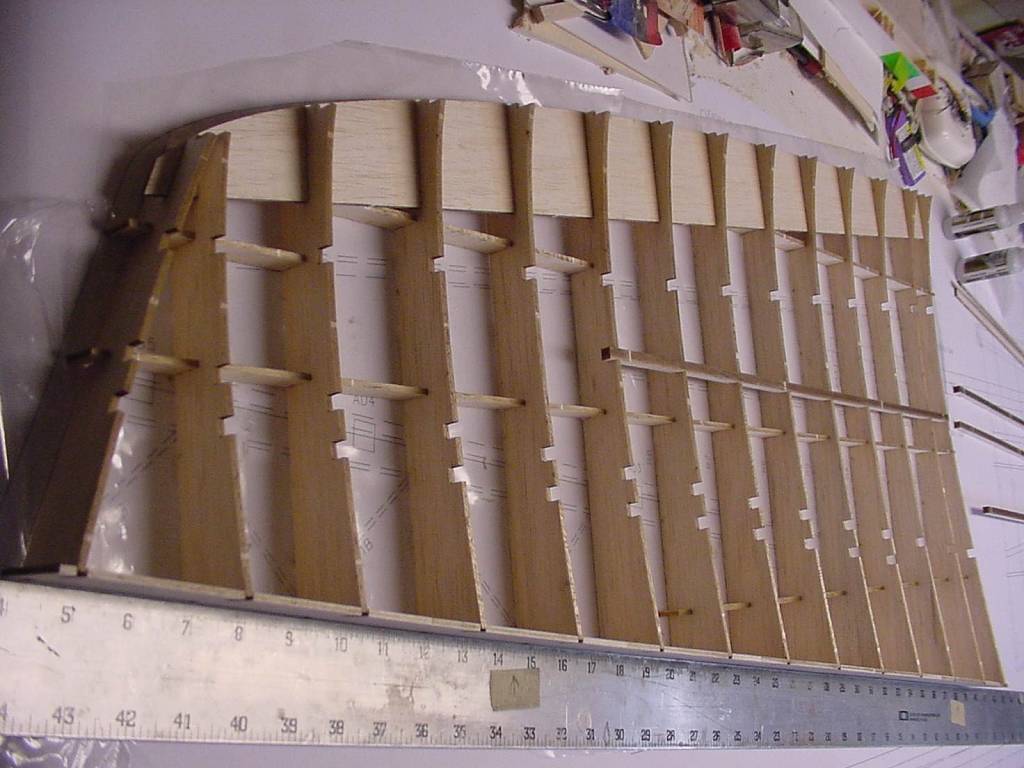

I thought since there is some down time waiting for glue to set I'd show the jig construction for this wing. This jig is slighlty different from past jigs, typically the jigs leading and trailing edge pieces are a solid straight piece from the table to the rib/leading edge. This jig has a horizontal former/spacer, a spine, that aligns the jig ribs to the elliptical leading edge shape, and then has 1/2" tall longerons top and bottom to prevent the jig ribs twisting when everything is pressing. Usually there’s some racking of the jig with the other jigs but this one is very stable and any future jigs may be built this way. The jigs are cut from 1/8" balsa to make them more durable.
Dave

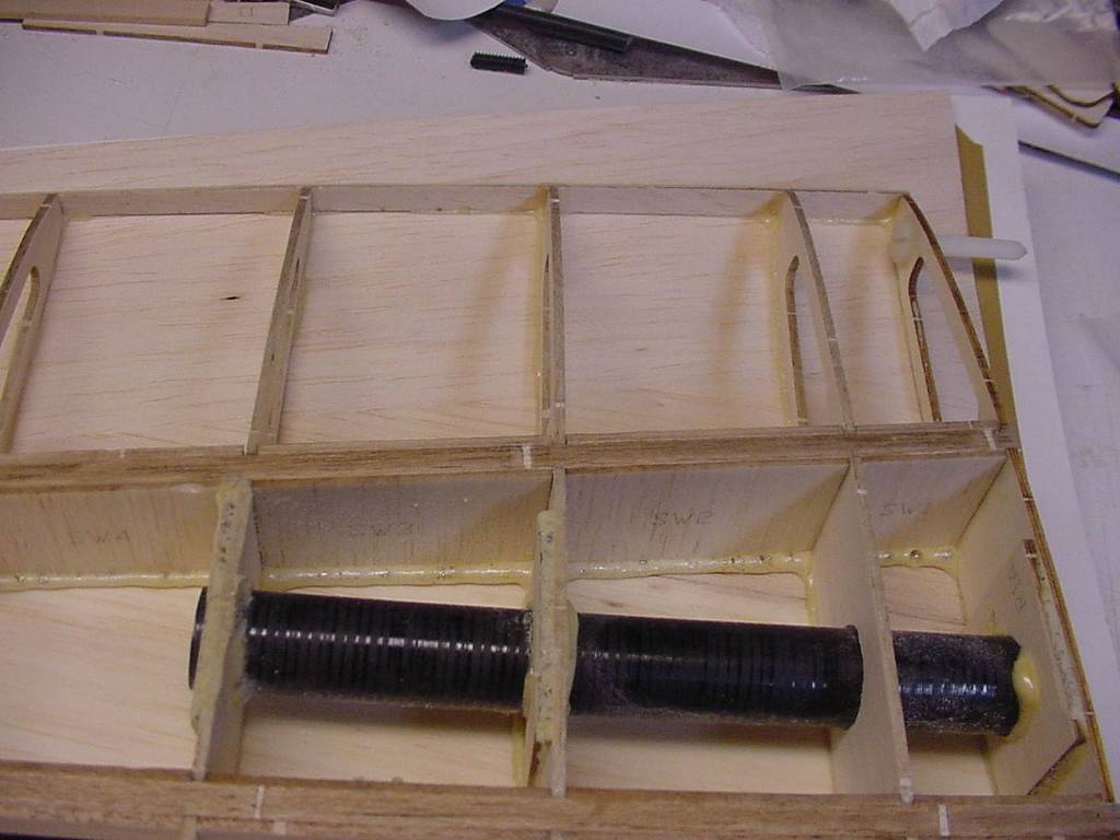

Old 12-11-2011 | 07:14 PM
  #56
Joined: Feb 2011
Posts: 150
From: Palatine, IL
Default RE: Building a built-up pattern stab and wing

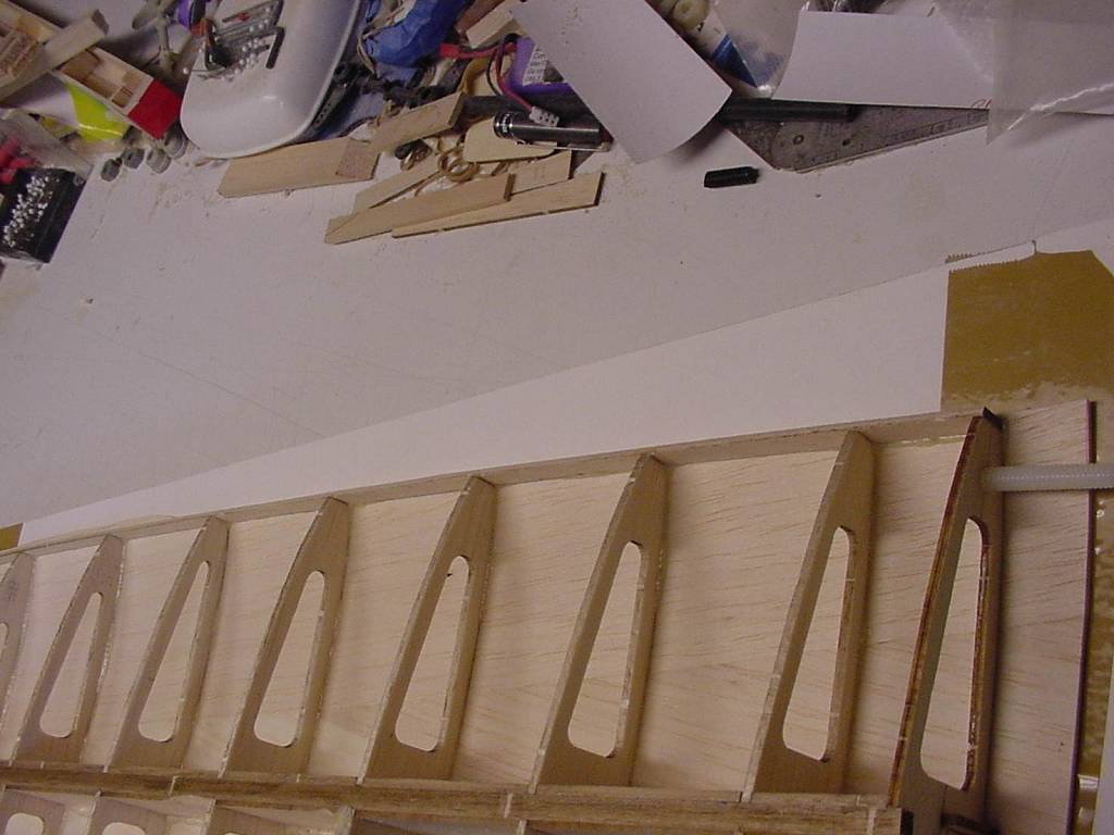

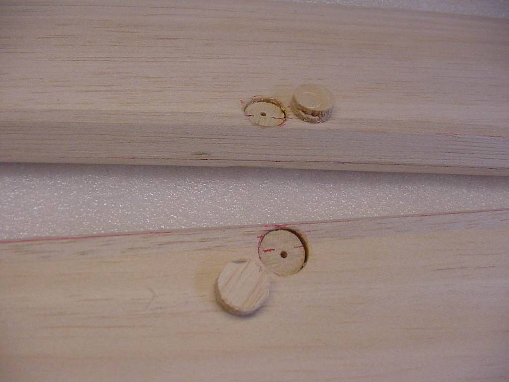

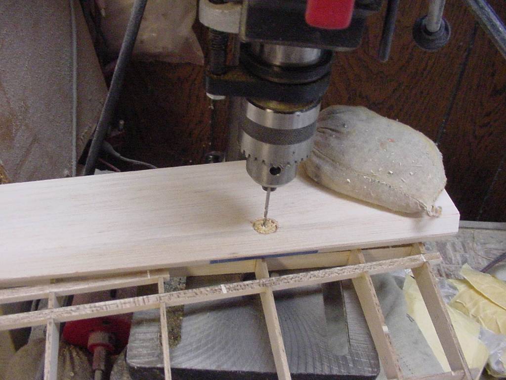

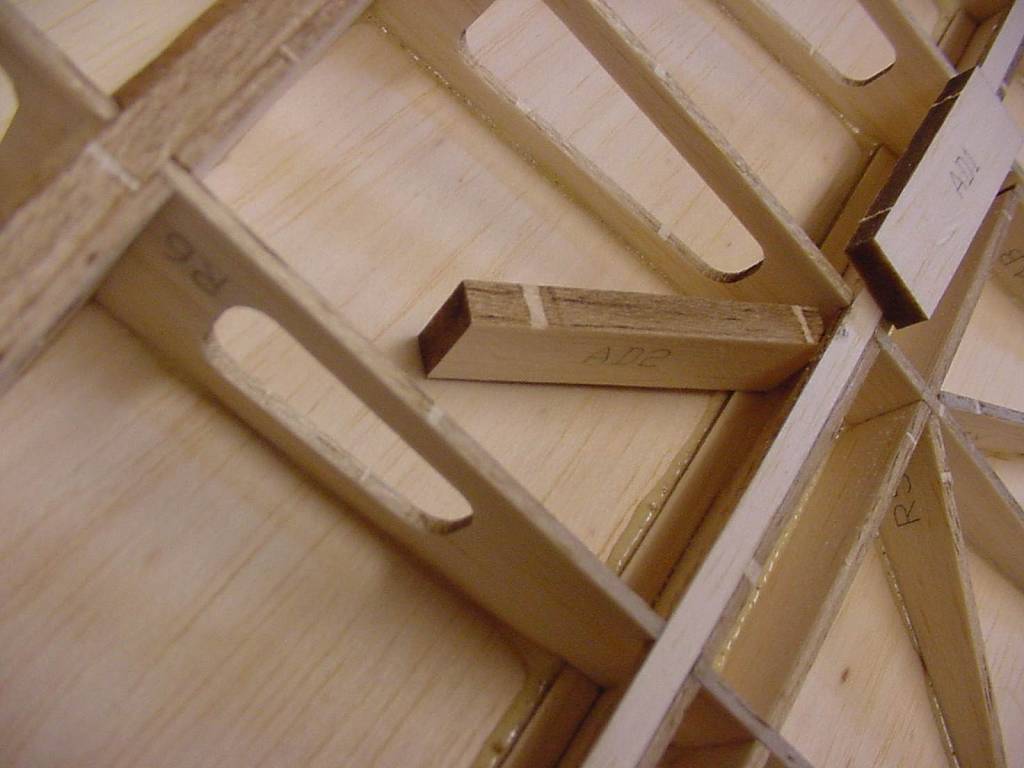

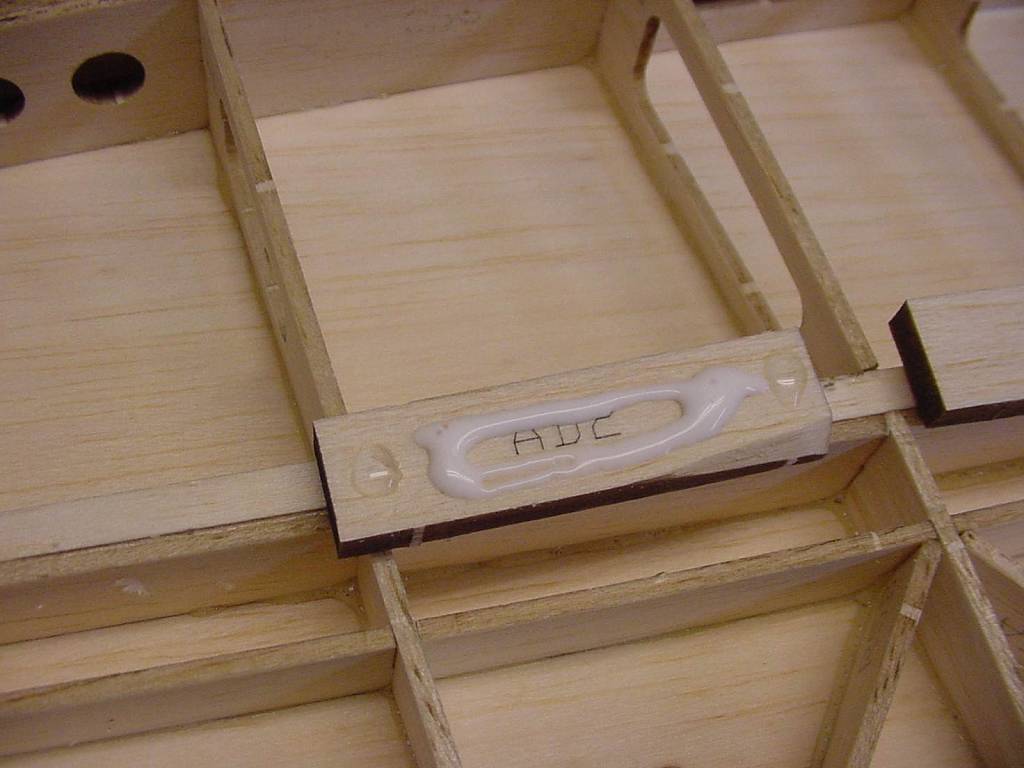

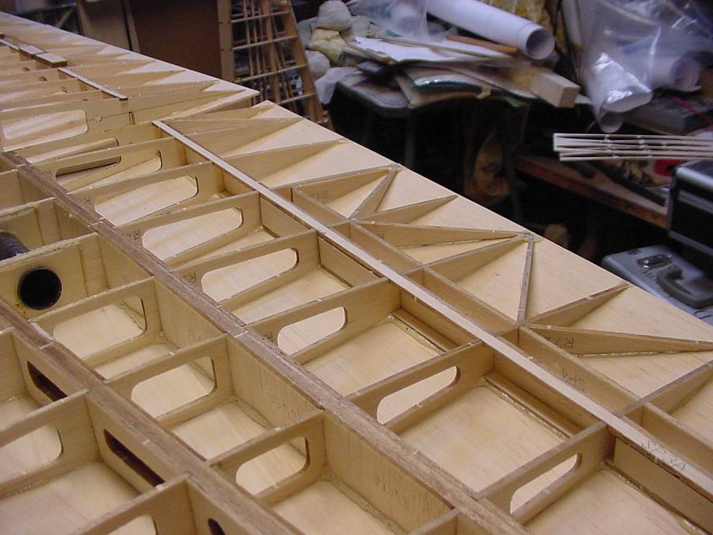

Both bottom skins glued on, trimming leading edge, installing aileron hinge doublers, installing servo box, installing solid balsa blocking for aileron stud and applying glue to attach top skin.
Dave

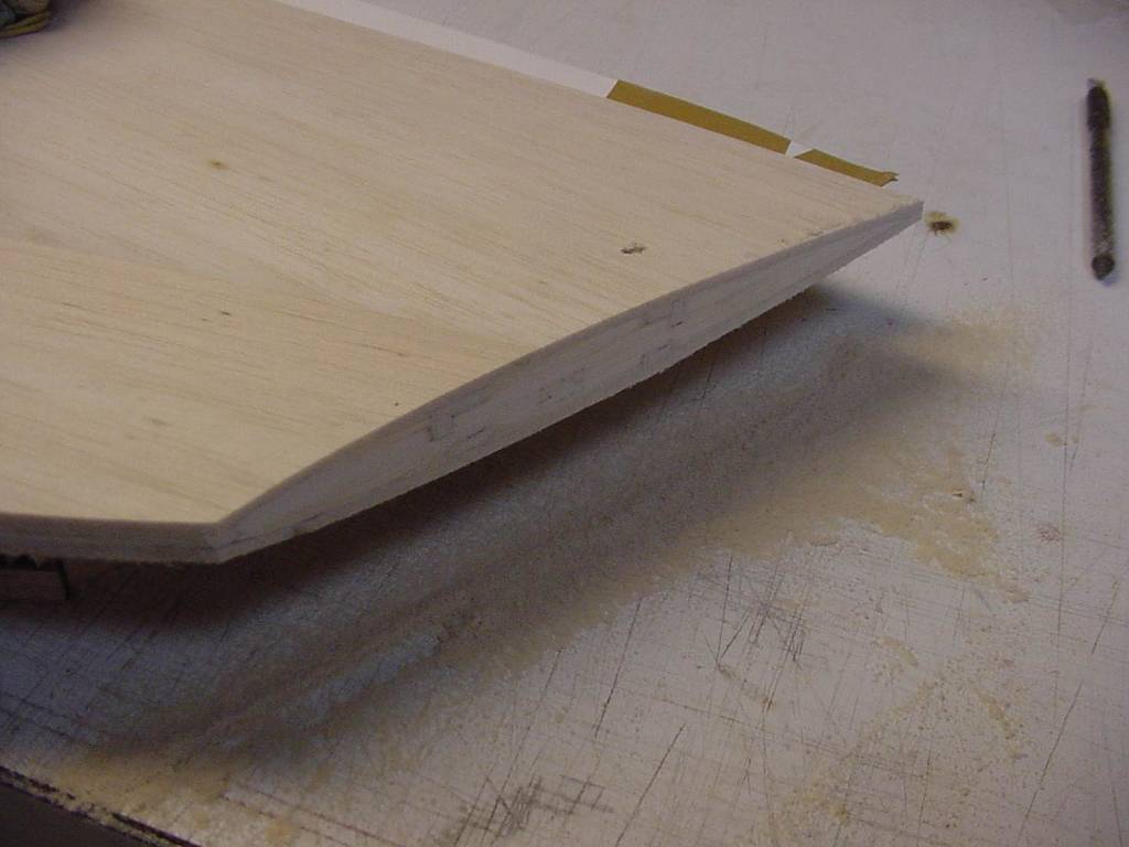

Old 12-12-2011 | 04:46 PM
  #58
My Feedback: (41)
Posts: 2,347
Received 5 Likes on 5 Posts
From: Algonquin Illinois IL

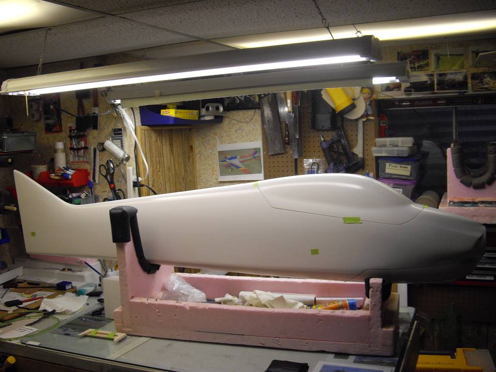

This is the fuse that Dave's new wing and stab will be attached to. It's the Mystic by Todd Schmidt. The weight of the fuse with the chin cowl and canopy are 28 ounces. I look forward to this an all American plane. There aren't many of those anymore!!! Thanks Dave it looks great. Mike Mueller
Old 12-12-2011 | 08:04 PM
  #59
Joined: Feb 2011
Posts: 150
From: Palatine, IL

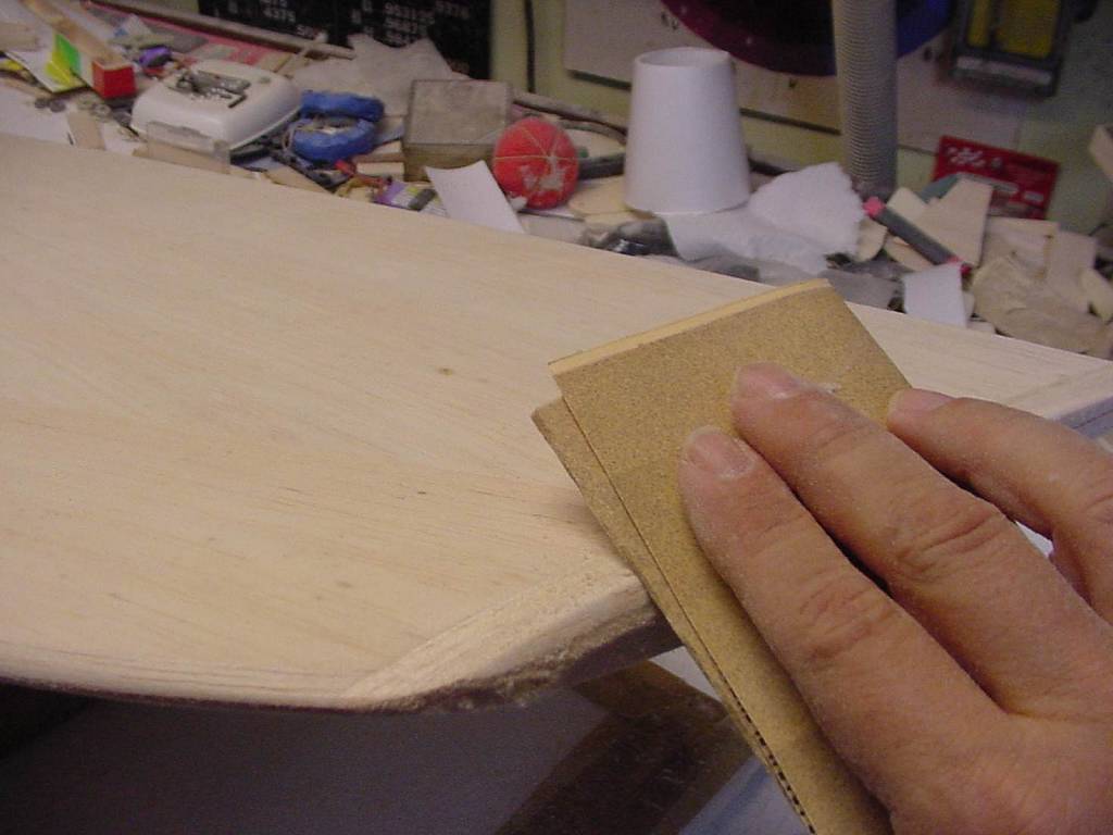

Mike, it should be a good plane after it gets all trimmed out.

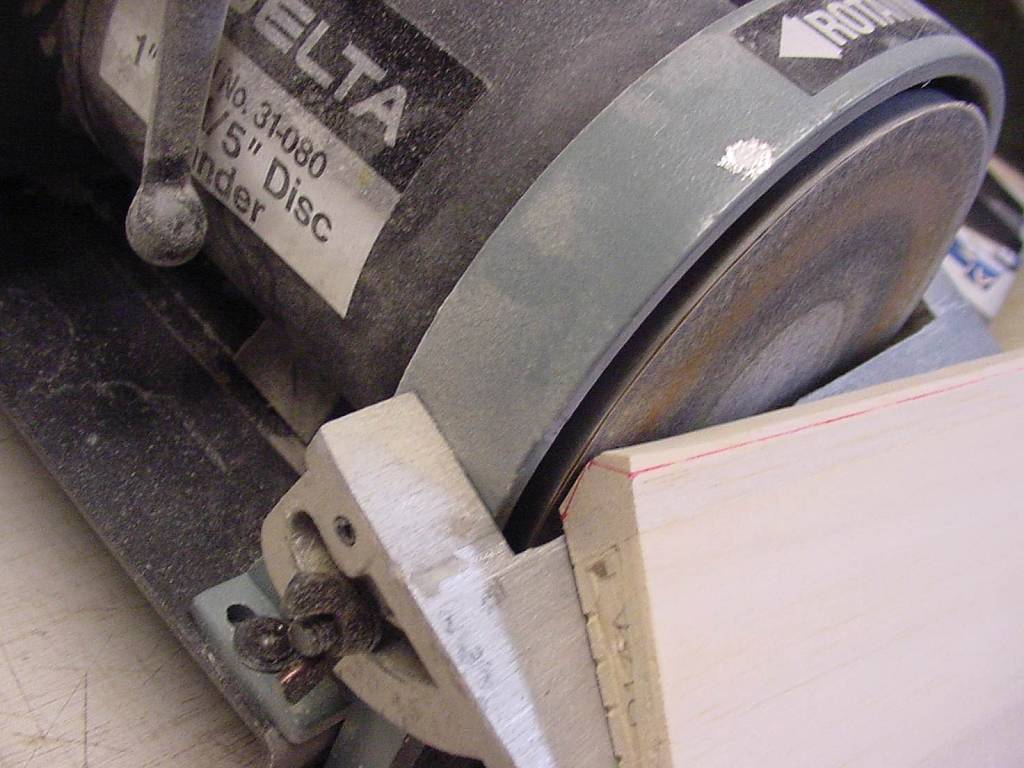

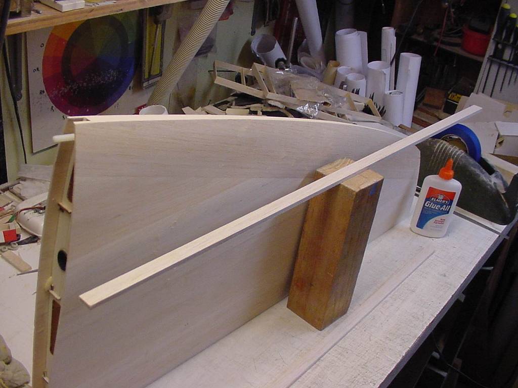

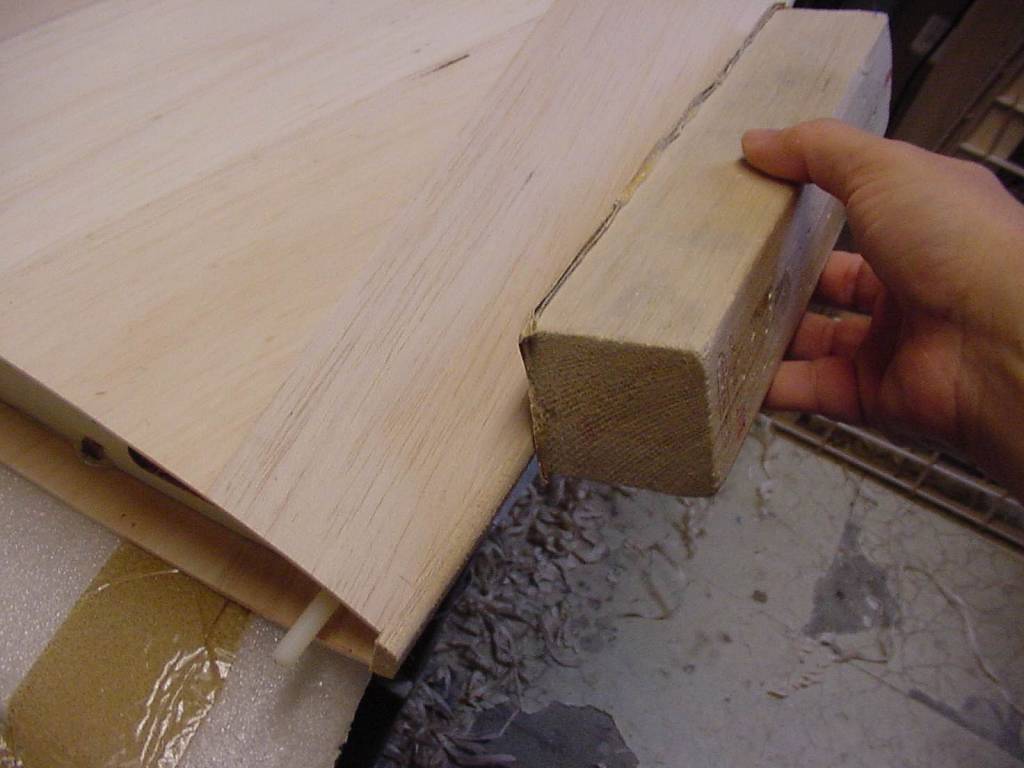

I had other things going today but was able to sand the leading edge and tip, match the panels and glue the leading edge balsa on.
Dave

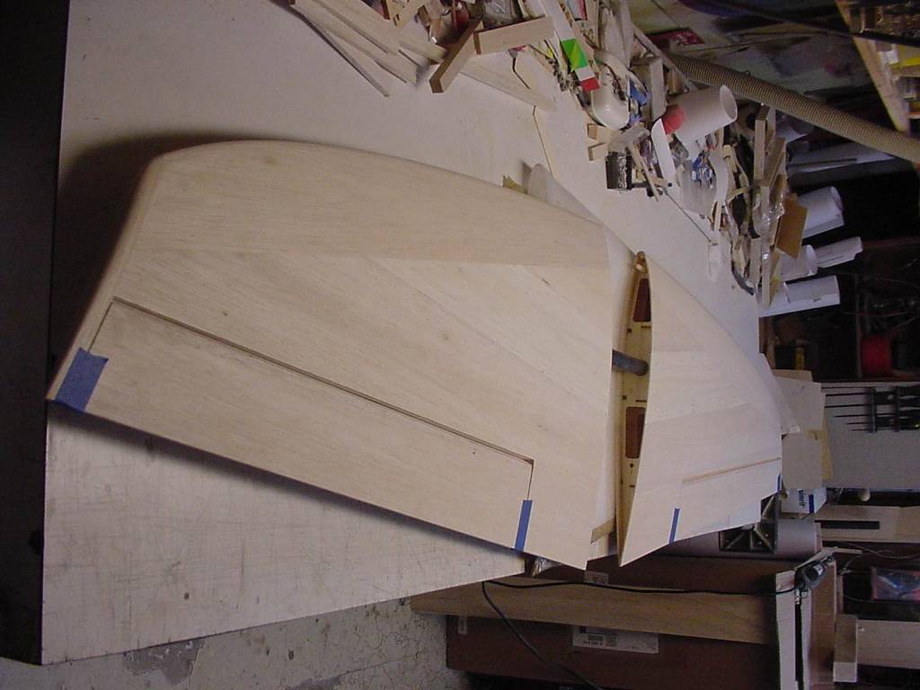

Old 12-13-2011 | 08:48 AM
  #60
Joined: Feb 2011
Posts: 150
From: Palatine, IL
Leading edge rough shape, centerline and tip blocks glued on.
Dave

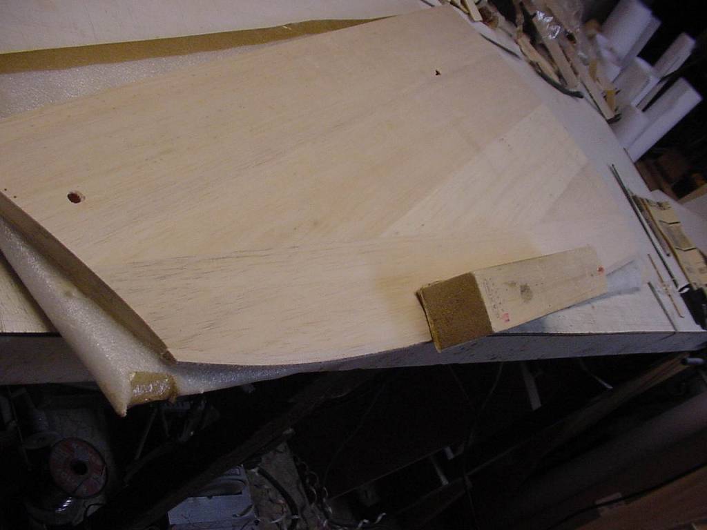

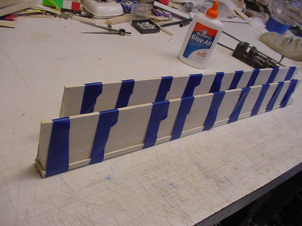

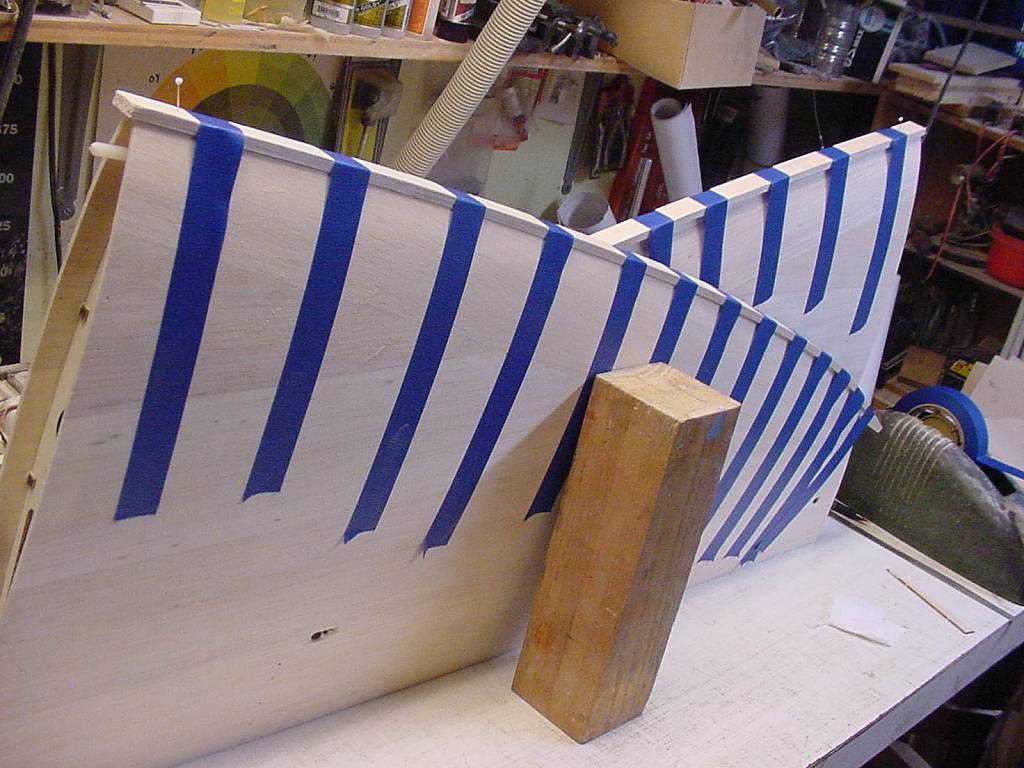

Old 12-13-2011 | 08:03 PM
  #65
Joined: Feb 2011
Posts: 150
From: Palatine, IL
Yes, a small messy shop.

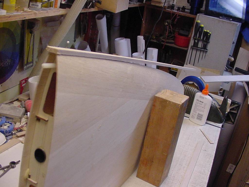

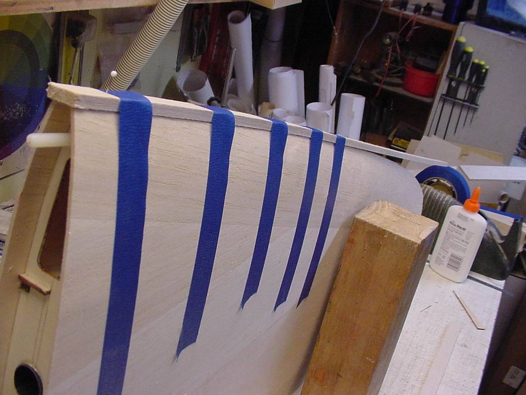

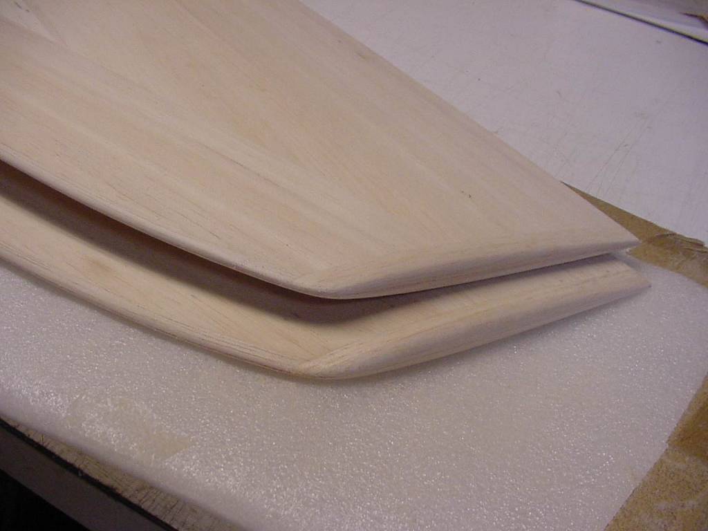

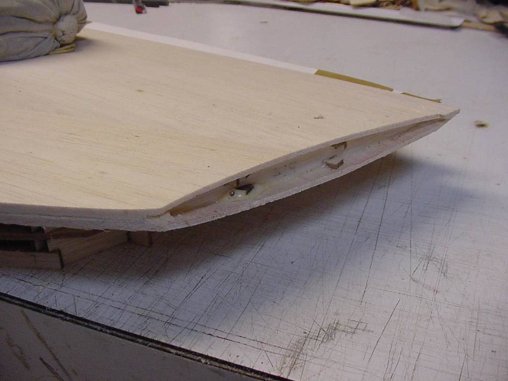

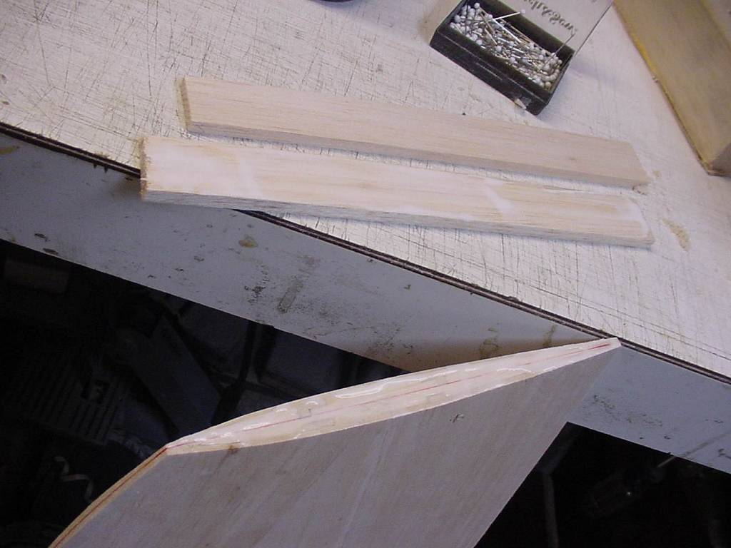

Tip rough shape, rounding leading edge and tip, cutting aileron off / sanding and gluing aileron leading edge.
Dave

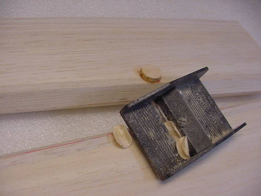

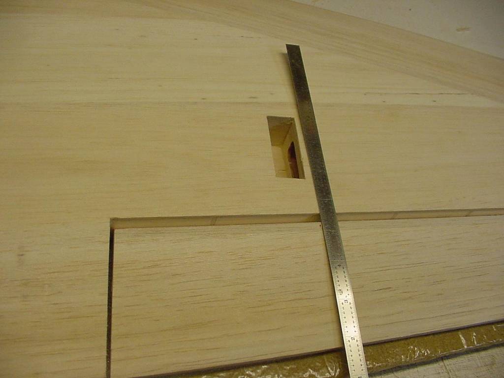

Hinging, shaping leading edge of aileron, cutting aileron servo box open, installing hard point.
Dave

More

My part of the build is finished, sorry Mike I could not get you panels as lite as mine and I messed up somewhere in matching weights. Here is the finished wing on the messy table and the finished panels weights.
Dave
