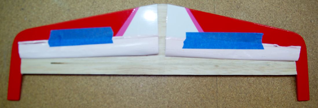

Even though "дареному коню в зубы не смотрят" ("never look the gift horse in the mouth"), I must say this ARF is a piece of cr@p. Whoever designed this knock-off, had no clue about engineering...
Any way, I gotta make it fly and not fall apart at the first landing. I peeled the covering of the nose and completely rebuilt the front half of the fuselage. Have to keep myself from rebuilding everything, which is especially hard for the tail feather. The horizontal stab will certainly fold under load--it's a thin plank of soft balsa. I peeled off the covering and discovered a piece of lite ply (which is supposed to reinforce the stab?):
At least it can serve as a good shear web!

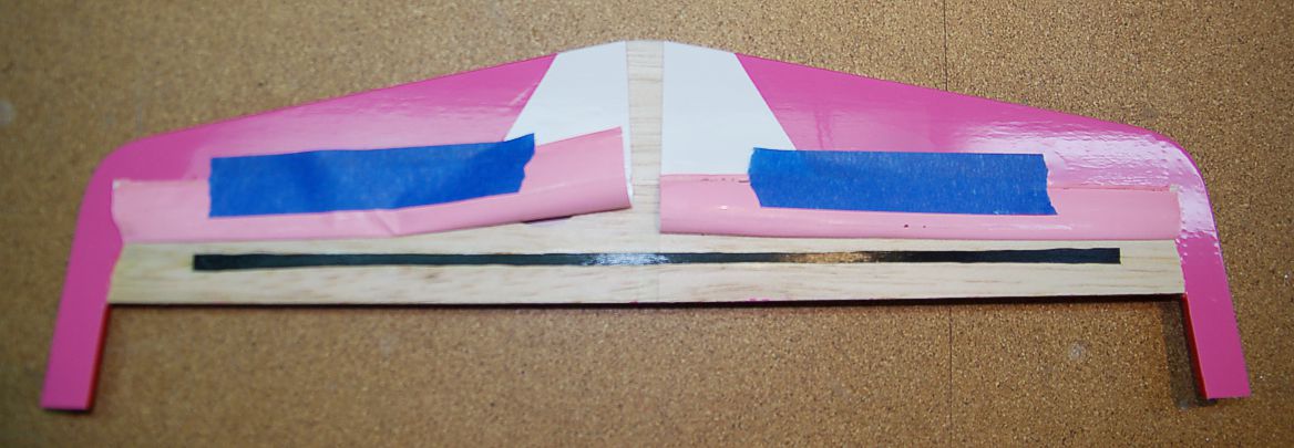

Here's a piece of 12k carbon tow spread over it:

CF reinforcement added only 0.3 g to the 24 g stab, that's about 1% of the weight resulting in 10x strength increase!

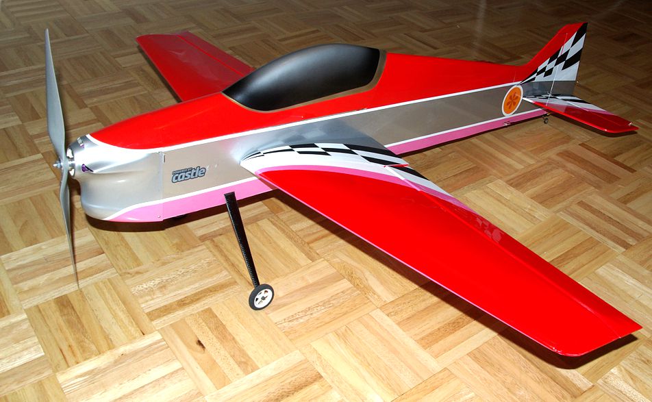

Thumbs up Maidened it this morning!
Finished the plane late last night and maidened it this morning with my sweet wife serving as a lucky charm.
The plane with EM Twister 19/40 motor, APC 14x8.5 prop (we are at mile high elevation here in Colorado), Turnigy Nano 2200 3S 45C battery, and CC Pheonix 60 ESC flew amazingly well! I've installed MileHighWings wattmeter to record voltage and current in flight: 600W at take off, then the prop unloaded and full power dropped to 550W, while most of the flight was only 200W. The 2200 battery lost only about 800 mAh after a 5 minute flight. AUW is about 1270g (2 lb 13 oz).
