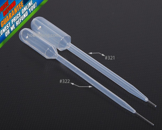

And don't forget the applicator...this makes things much cleaner and easier. Drill a 1/16ish hole at the center of the hinge slot and place the applicator at that spot. One or two drops top and bottom with fresh CA is all that's needed.

does anyone have a source for the pipet other than the local hobby shop "bulk"

If you drill a 1/16" hole in the center of the hinge slot, that will help the CA wick to the back of the hinge.  Take the end of your pipette and and pull it apart with two pliers.  The part that gets drawn apart will be about twice as thin as it was originally, that will be small enough to get a few drops onto the hinge.  Once you're done, wipe down the hinge line with acetone to get rid of the white powder that forms around the hinges from the CA.

Dave Brown Products, has CA Applicators, 12 for 5.95.

Thanks but bulk they are prolly .05 a piece ... thats what i'm interested in
