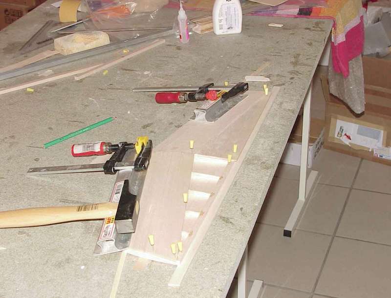

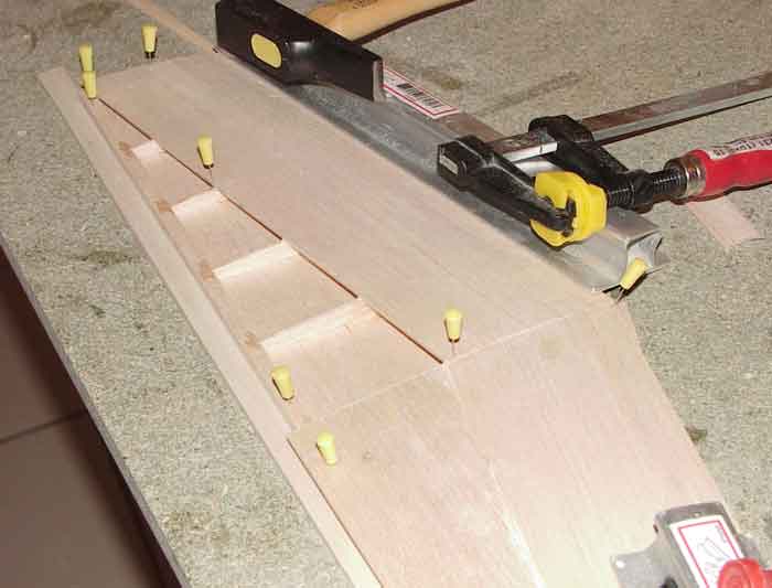

the trailing edge, it is the only difficult part , because there small ribs , and it is very difficult to get the perfect alignement , the besr thing to to is to use the side and position it on the wing to get a perfect fit

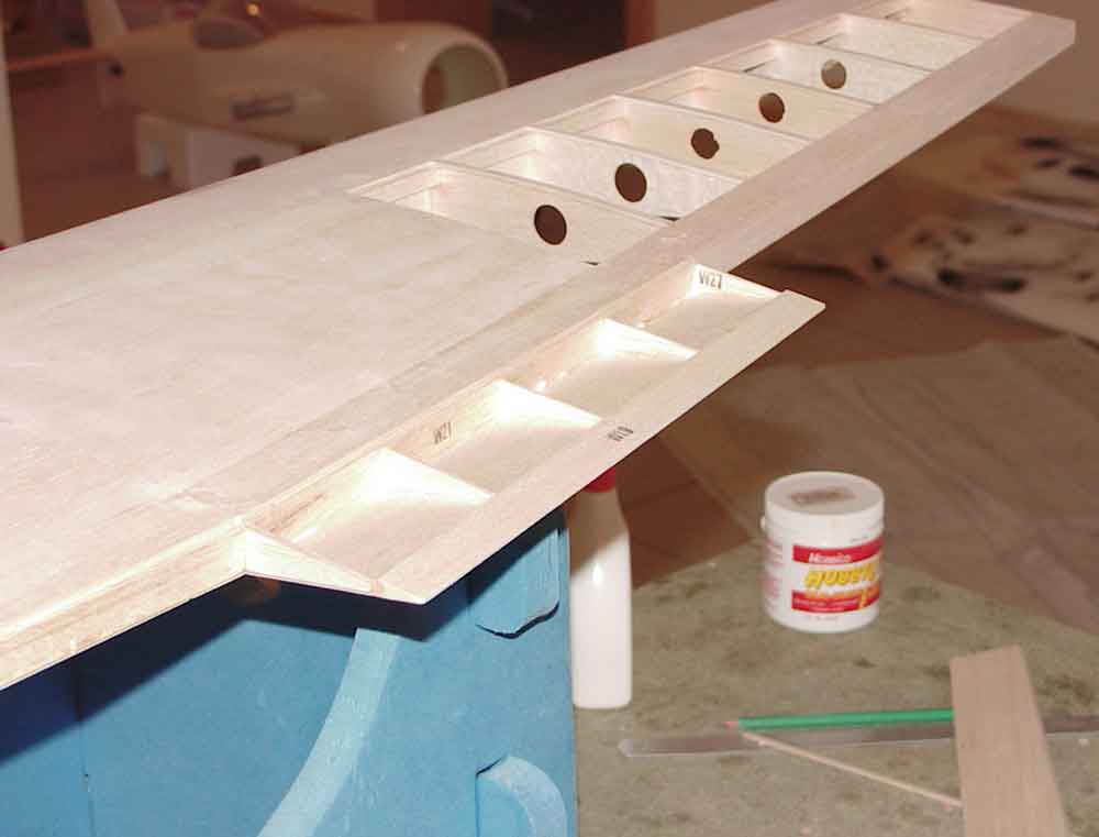

the size of the wing , i will shape the wing tips tomorow

the aileron are perfectly aligned, this kit is a joy to build

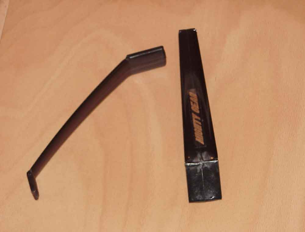

the landing gear the reference is mk 0247, it look made in carbon fiber

to finish the mode you need :
the landing gear #mk 0247
the moto mount # mk 1311
the fuel tank # mk 0612
the tail wheel #mk 581
the wheel pant # mk 0252
the bb dual elevator coupler #mk 1231
a 57 mm spinner true turn or dubro
the ys fz63 engine
rudder horn .......

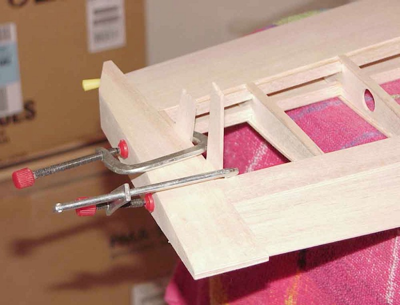

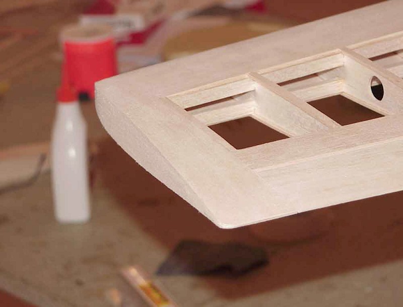

shaping the wing tip[img][/img]

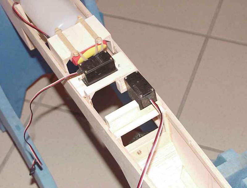

construction of the stab

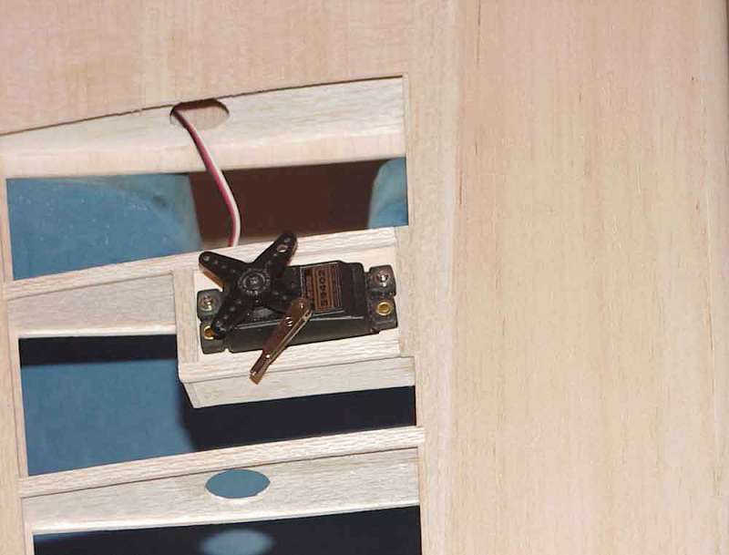

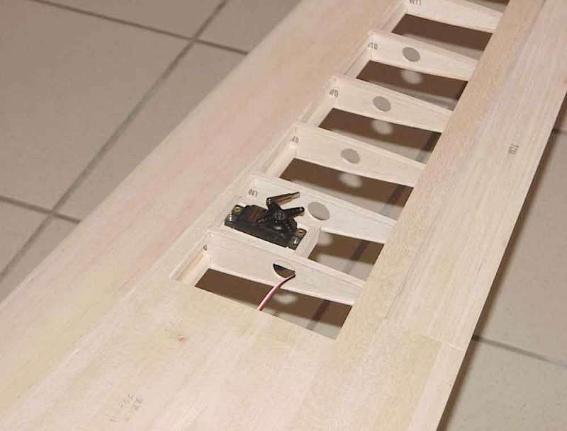

installation of the servo in the wing

construction of the fuselage

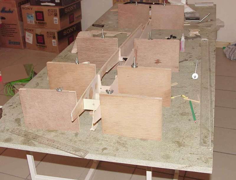

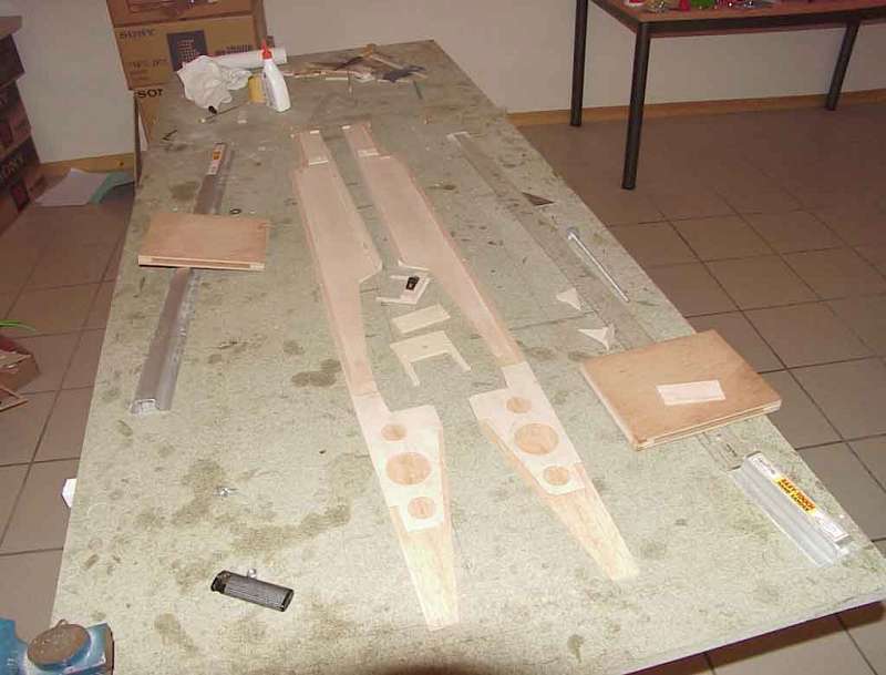

construction of the fuselage and the fuse jig

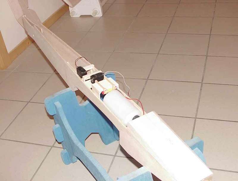

Default RE: Mk Synergy 63 Kit

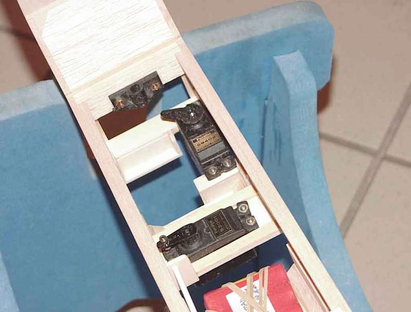

engine insrallation and radio you can see the mk ball bearing elevator link

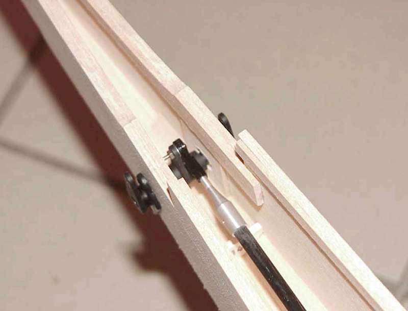

the ball bearing elevator link il will really apreciate comments on this construction if anybody build this one

Looking good! Makes me want to send an order to Singapore Hobbies. I'm personally not a fan of the elevator bell crank setups though they are smooth. Too many connections that could cause problems later on. Especially since one is not accessable after the model is built. I am interested in your fuse jig though. Care to enlighten the rest of us on it's construction?
Thanks!

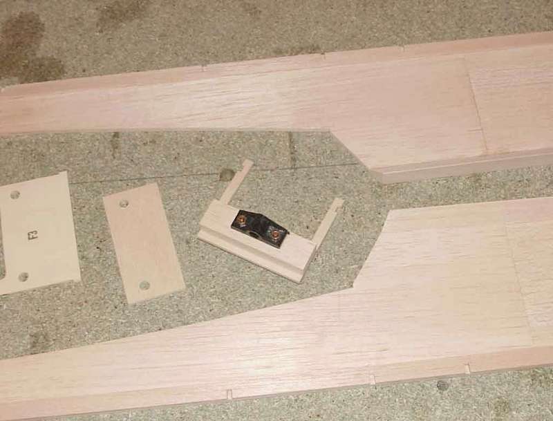

the motor mount # mk 1311
Well here is my question: Is it a soft mount ? I cannot recognise it so well from the picture. Thanks in advance
