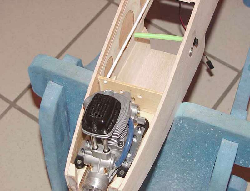

yes it an mk soft mount ,

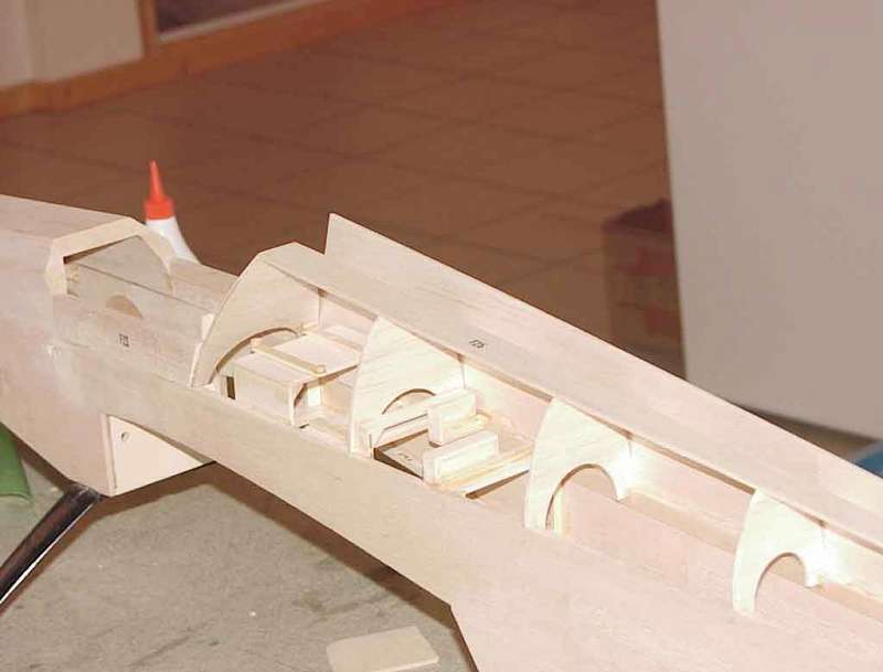

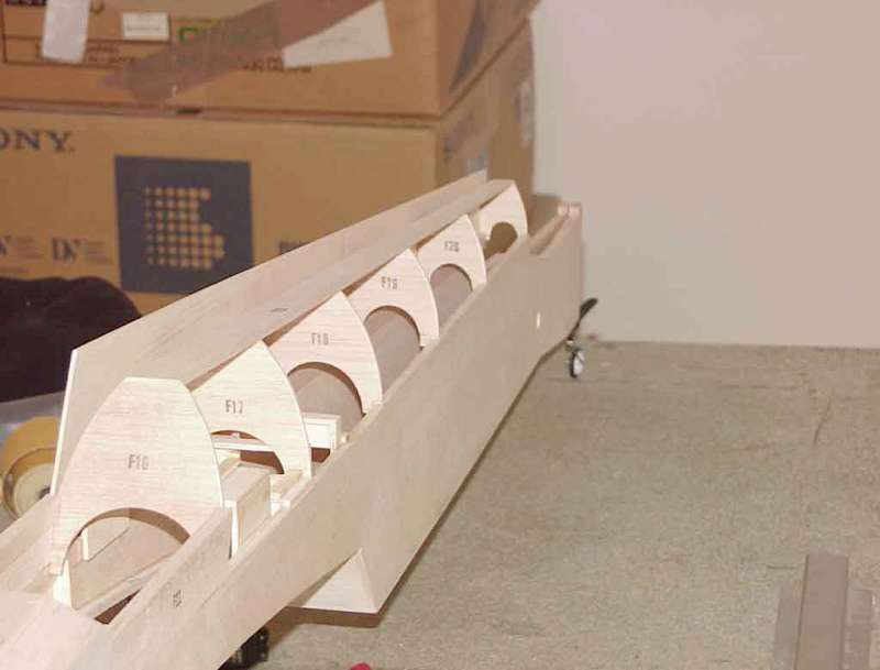

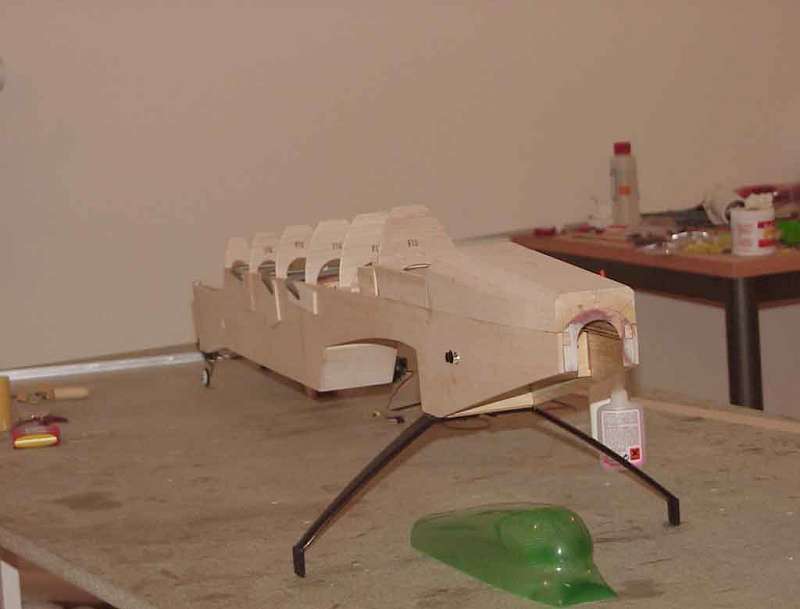

building the turtle deckl

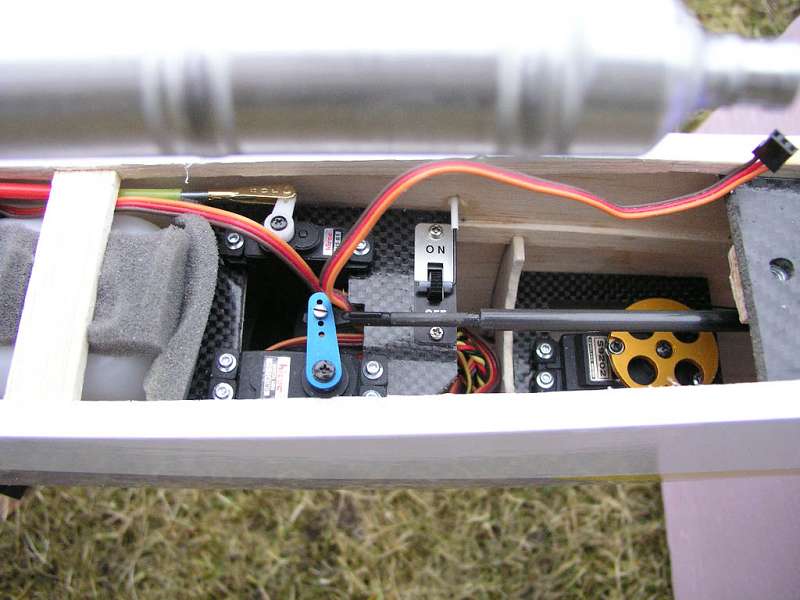

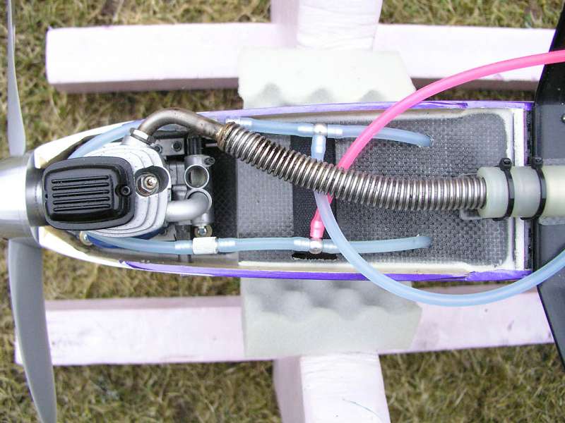

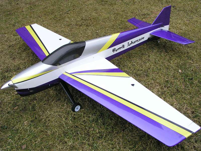

I finally finished mine. I didn’t like the wing construction, so I made wing in foam and balsa instead. Canopy and engine cover in carbon. I substituted all plywood with carbon/divinycell composites.
Ill probably do the maiden in a week or so... I'll let you know how it flies…

SWEET!!! I am thinking of getting myself one.... maybe at the end of the year. BTW, is that the new YS 63 S u r using there?

one thought, the wing looks a little big for the plane...... (as seen from the first pic......)

Yes, Ys 63 and hatori pipe.
The wing does look big in the first pic. I guess it has something to do with the camera angle and the camera objective.
The fuselage is as long as the wingspan, give or take a few mm.

the new YS 63 S or the old one? btw, did you carbon fiber the engine mount area and the firewall as well?
Old 04-01-2004 | 08:16 AM
  #64
Joined: Aug 2003
Posts: 40
From: Vaxjo, SWEDEN
Default RE: Mk Synergy 63 Kit
It's the old one, not the S.
And yes, the enginemount and the firewall are carbon as well... (I like carbon, It looks sexy...)

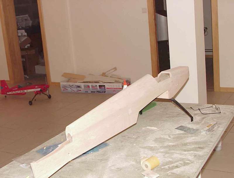

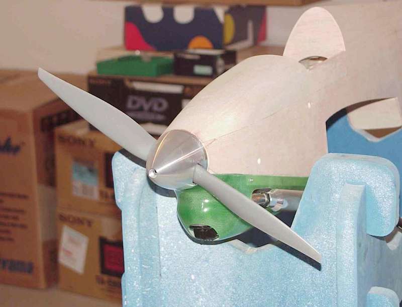

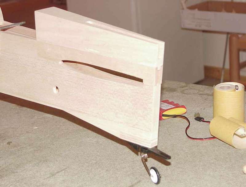

finishing the fuse
i am goin to glass it

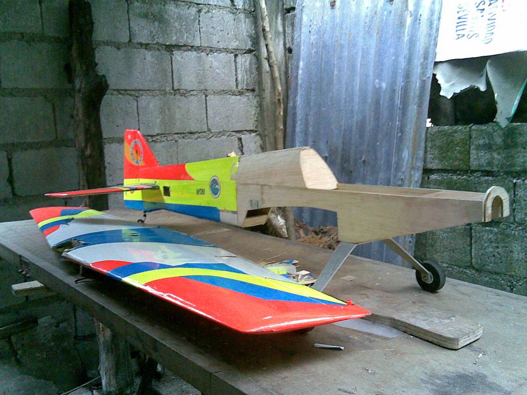

A friend of mine gave me an almost totalled MKSynergy. Look at the pics to see how bad she was when Igot her. Since there's no available glass on the market, Idecided to mount the engine in a canted position and also because I have very bad experiences with inverted engines. I've read here thatthe recommended.63 is underpowered but I'll use a West .50 since it's the only one I have in my spares box. I'll post some updates soon as I progress.

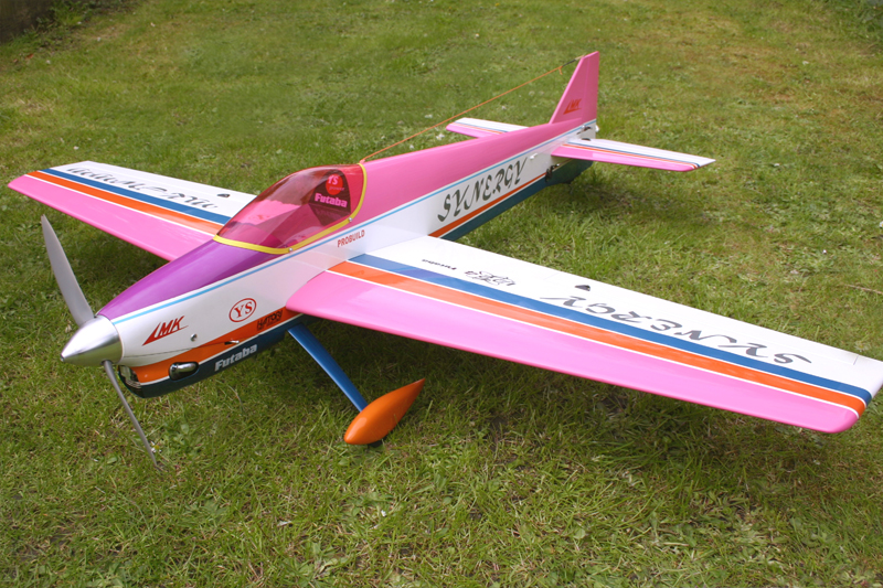

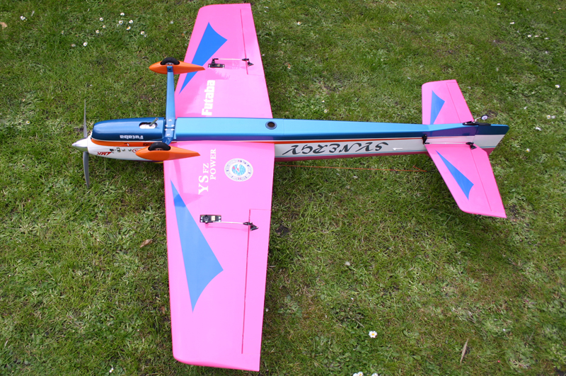

I am so glad to see there is still a lot of interest in the MK Synergy.
Here are some photos of mine, she is now 4 years old & is as good as the day of the maiden.
YS 63 is a perfect set up for pattern, big round loops are beautiful to fly.
I have now moved up to 110 size (MK Sky Star) Very little difference in performance.
Sky Star presents itself better in the air due to larger size.
Enjoy this plane, I still do!
