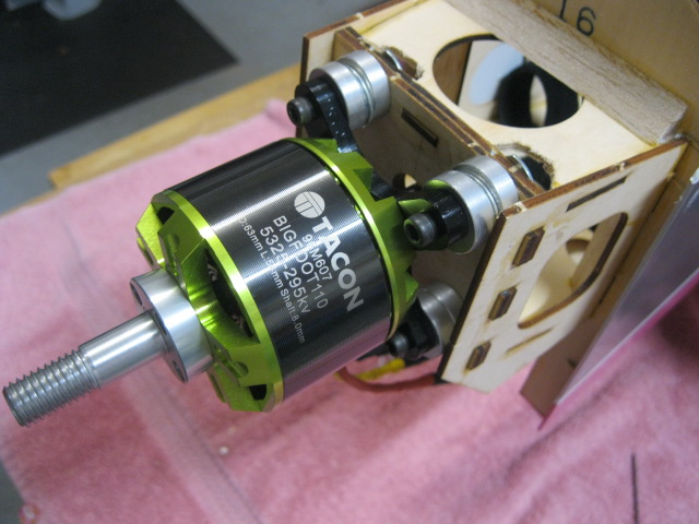

Hello Bob,
Thank you for helping me on this. I do have a question though you may know the answer. When I mounted the motor (electric) I noted that there was up thrust in the shaft of the motor then I noted that the bottom of the laser cut motor mount was noted that the third cut hole from the top cut is 1/8" farther from the front of the fuselage bulkhead than at the top of the mount, but the three degree right thrust is there? I'm not a novice builder as have built award winners over the last 40 years and all parts check out. I know in my heart that this plane was not designed to fly with that much up thrust. Currently the back of the motor is square with the main bulkhead and zero upthrust.
Old 10-04-2013 | 07:33 PM
  #57
Bob Pastorello's Avatar
My Feedback: (198)
Posts: 6,707
From: El Reno, OK
Yep. What you're seeing is right. The actual "firewall" (really it's the forward fuse bulkhead, I suppose) is "square" to the fuse jig construction, apparently. Both of mine were that way. The Upthrust ends up being built in when you assemble the motor mount firewall, and the side pieces set that. I know it is counterintuitive to see that upthrust, but the stab sits slightly positive relative to the wing, and the wing seems positive, also.
I've built a ton of pattern models through the years, and hardly any had upthrust - but Mr. Park knew what he was doing. With the thrust as built-in, these planes fly exceptionally well. I wouldn't have believed it, but it is true.
Build it stock, with the upthrust the side plates build in - it will be fine.

Hi guys,
Just got my motor mounted and noticed the upthrust as well. So, my motor is mounted at 81mm per the instructions...... did you all have to cut the backside of the cowling any. If I push my cowling on, it gets snug, but still has about a half inch to go.

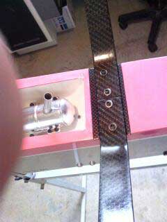

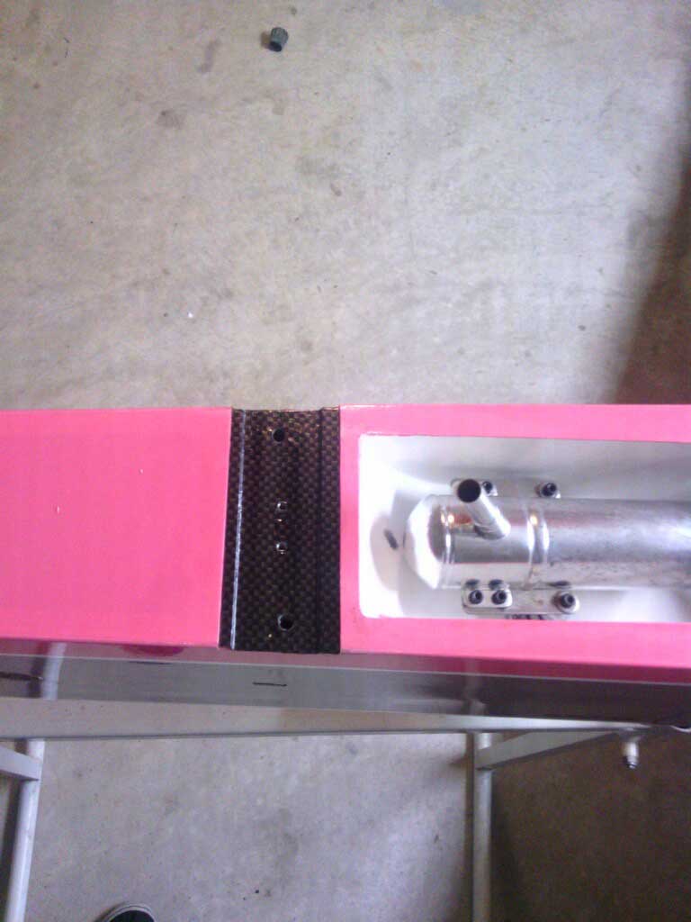

Originally Posted by mhare2000
OK, with a little searching and ingenuity I have solved the carbon Fiber gear issue on the Monolog 110. Ordered a set of gear from Graphtechrcshop.com item # 280 a quick trip over to my friend Raiko with raikodzigns.com and presto we have carbon gear! See photos below.
Looks like you laid up some sort of carbon material in the gear slot. Can I ask what that is?
Old 10-05-2013 | 05:45 PM
  #62
Joined: Jul 2007
Posts: 118
From: , NC
I liked mhare's idea and tried to find a gear that I would not have to cut. I decided to try the graphtech #127 which is for a H9 funtana. It was around 36 bucks after shipping. The fit is not too bad.... maybe a little wide where it mounts to the fuse, but it is close enough for me. The pic below shows it temporarily in place. I'll just run (2) 8-32's through the existing holes for the wire gear.

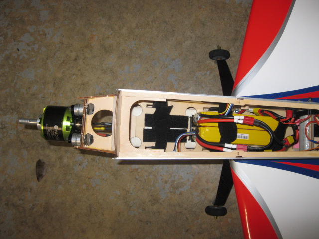

Posts: 118
From: , NC
I have 4 flights on mine. The built in upthrust was not working out......plane was climbing with power. I added a couple washers to get the thrust closer to 0..... much better now, the plane flies and tracks nice. Not sure why it is recommended and has worked for others.......

Joined: Jul 2007
Posts: 118
From: , NC
Sure thing... I'll post some pics of my setup here in bit. I'm running a tacon 110 with 2 zippy compact 4S 4500's. I have not weighed it or done the knife edge test you mentioned.

  #68
Joined: Jul 2007
Posts: 118
From: , NC
ID:	1941611   Click image for larger version
ID:	1941612   Click image for larger version
