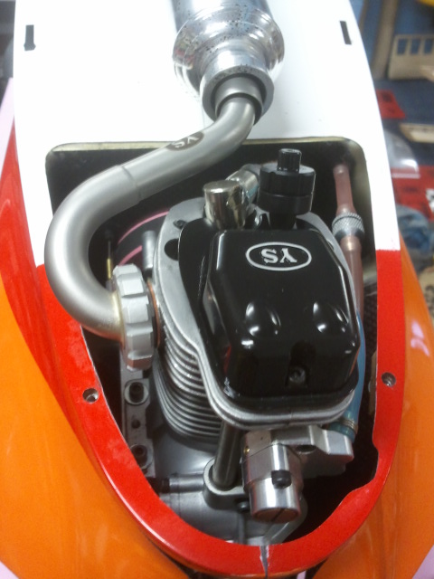

This is the new YS header fitted to my Valiant. Much easier to fit and will solve the problem of the flange screws coming loose. A very good quality product and very neat. Fits the #821 Hatori muffler.
The Header is available in a 10mm and 20mm rise. The YS header weighs 3 grams less than the Hatori header. I will be fitting the 175cdi as soon as i get a chance.

Where did you get the YS header?

Contact Richard Verano, I got mine from him.

Naruke Hobby - Japan.

Wich size rise did you use on your Valiant? 10mm or 20mm?

I previously used the 25mm rise Hatori header, so i usd the 20mm rise YS header. Worked out very well.
