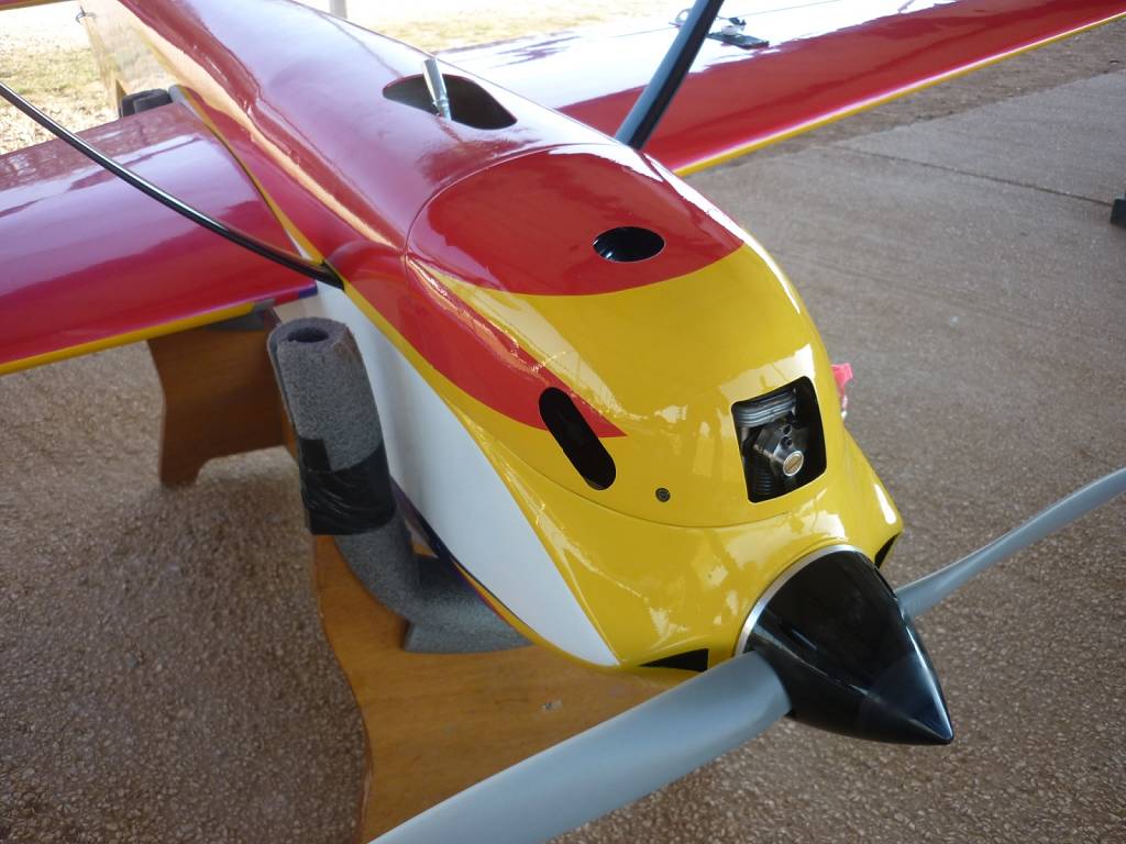

Hello
The advantage of cdi is the possibility of using fuel with little oil, the plane remains very clean. I use 9% oil (25% nitro).
The 175 uses a little more fuel. With 680 cc, 170 cdi flight last about 20 minutes, 175 cdi 15 minutes.
When I go to field with friends spend the day, I take my 5 liter and can do many flights.
Engine cooling is very important.
I made a change on my underbelly as shown on pics (before and after) and gain is about 20 degrees

The cooling is very important, use foam as papaone does on his cowling, but you can also use foam on the sides of the engines.

"The cooling is very important, use foam as papaone does on his cowling, but you can also use foam on the sides of the engines "
Claude
