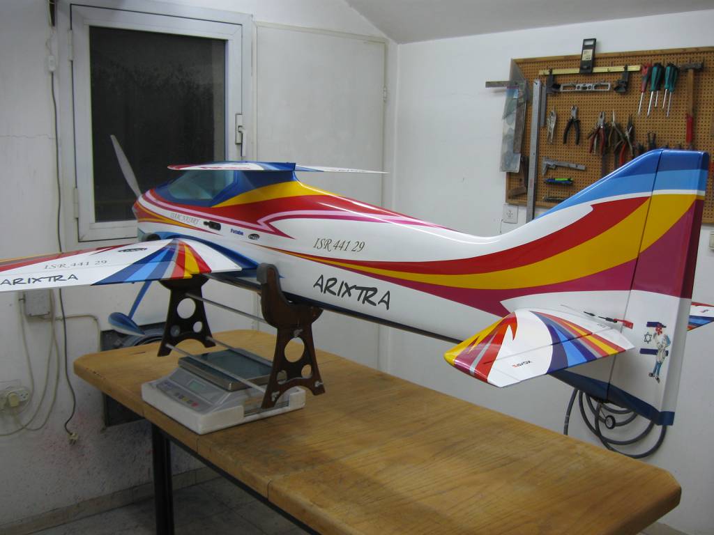

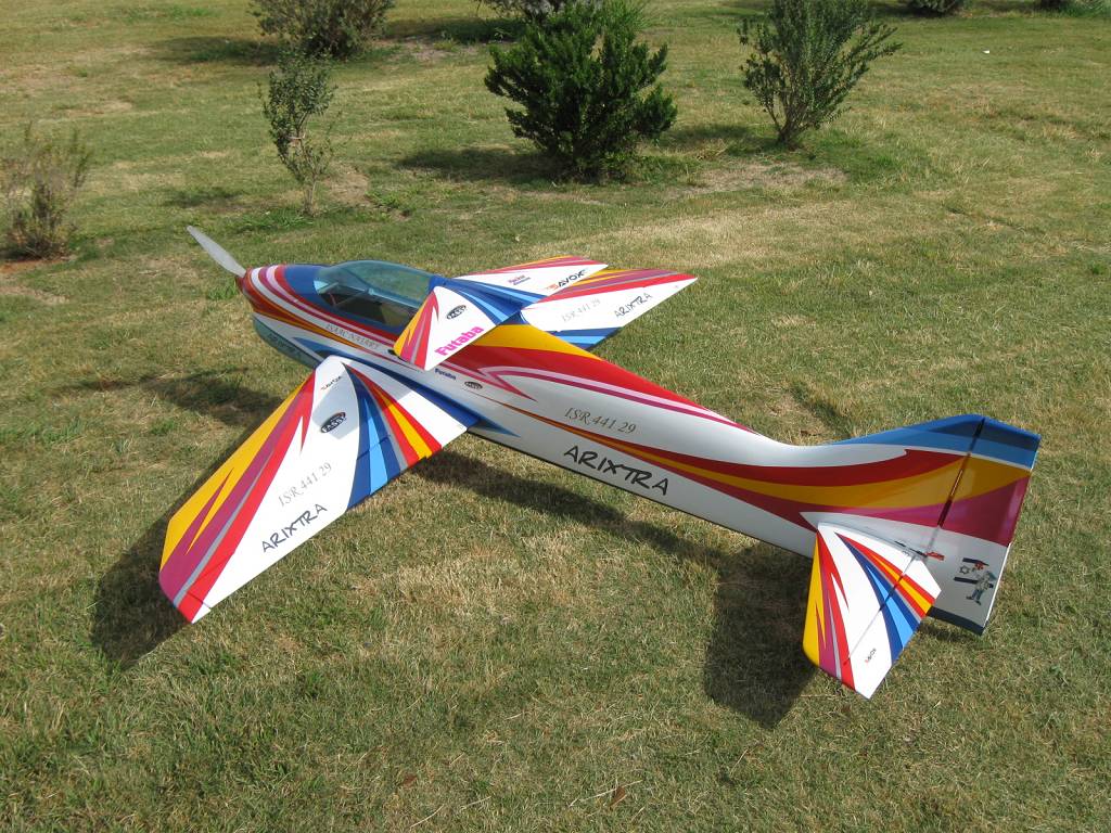

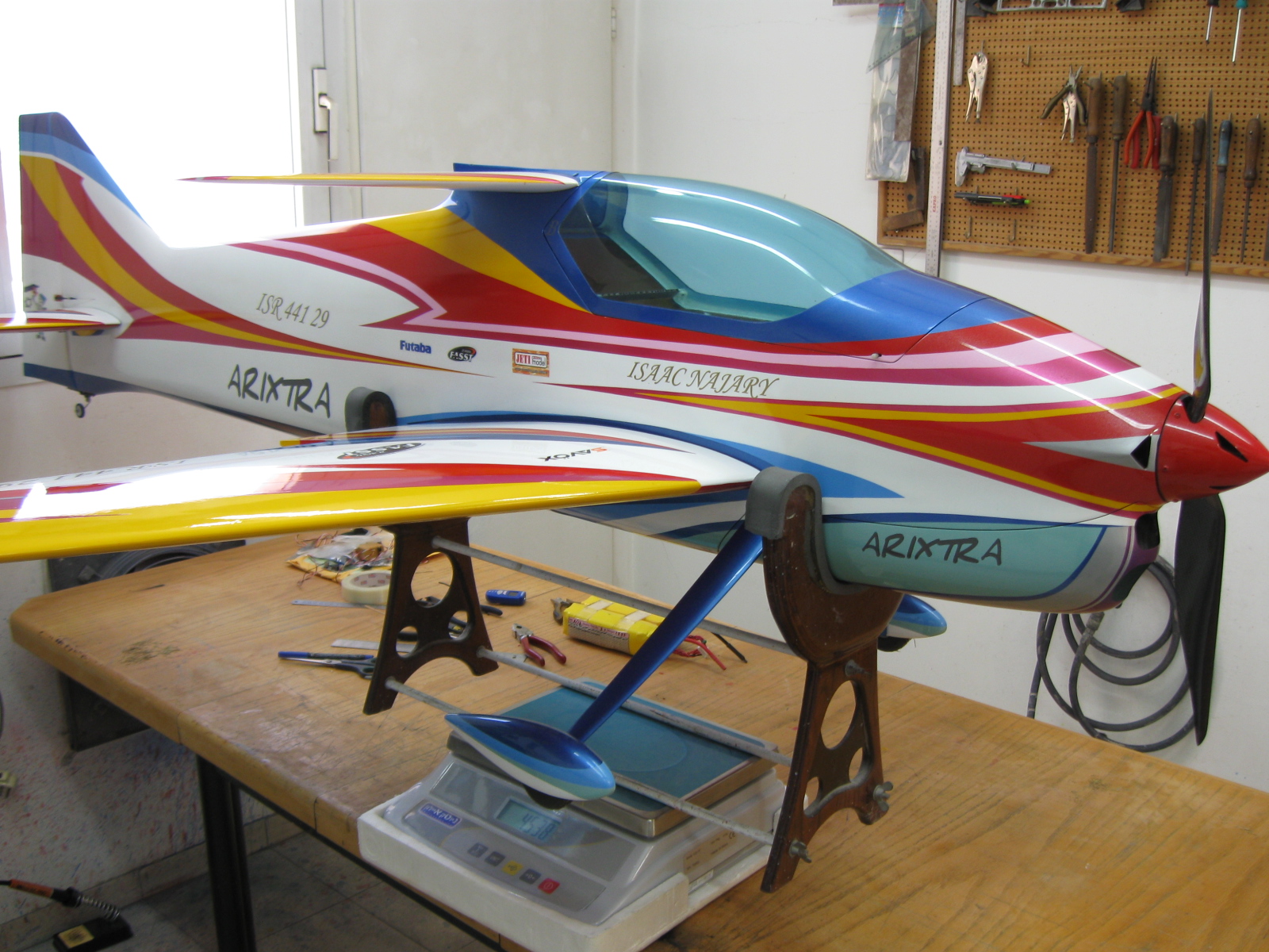

After 27 flights, I can say that I am pleased with the plane angles and C.G. place.
The angles are just as Pascal Novik recommended, (thanks Pascal):
The T canalizer: – 1° from the fuselage center line.
The stabilizers: 0°,
The wing: + 0.8°
The motor: 1.5° down, 3° right.
The C.G. is at 193 mm from the trailing edge.
Best regards,
Isaac Najary

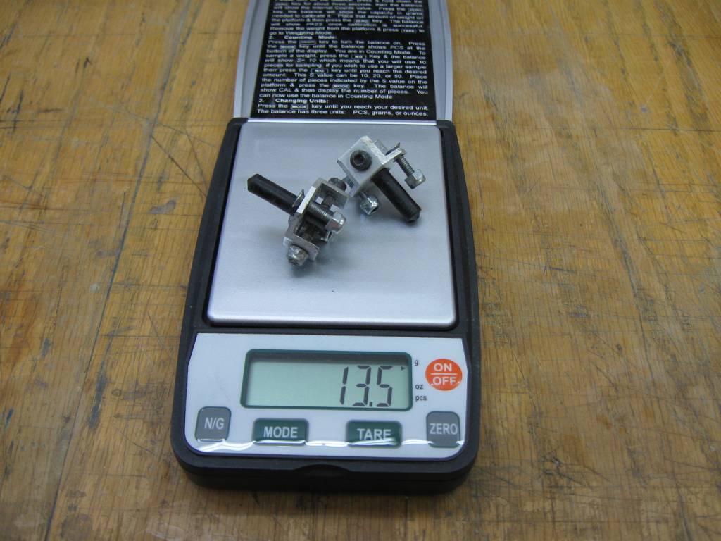

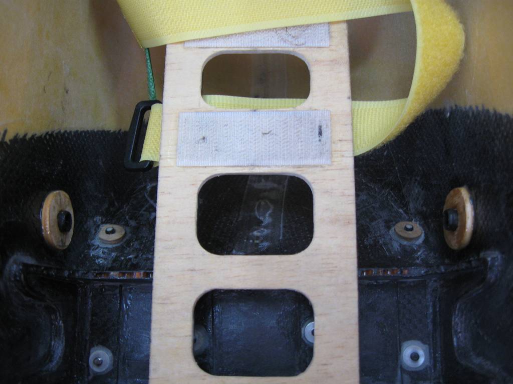

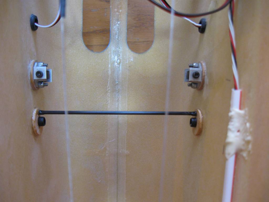

Now it is the time to remove the wings adjusters and to save 11 gram more (13.5-2.5).
This also eliminates some unpleasant flexibility from the wings roots.
Best regards,
Isaac Najary

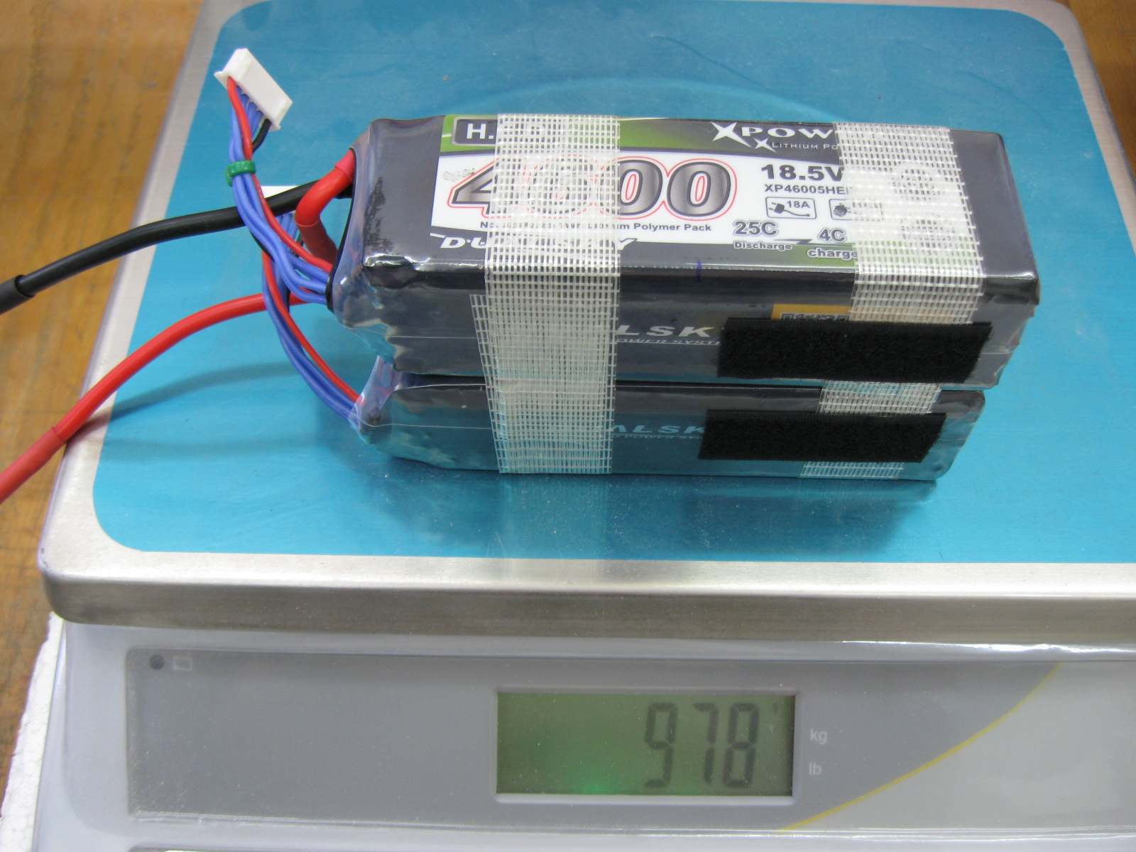

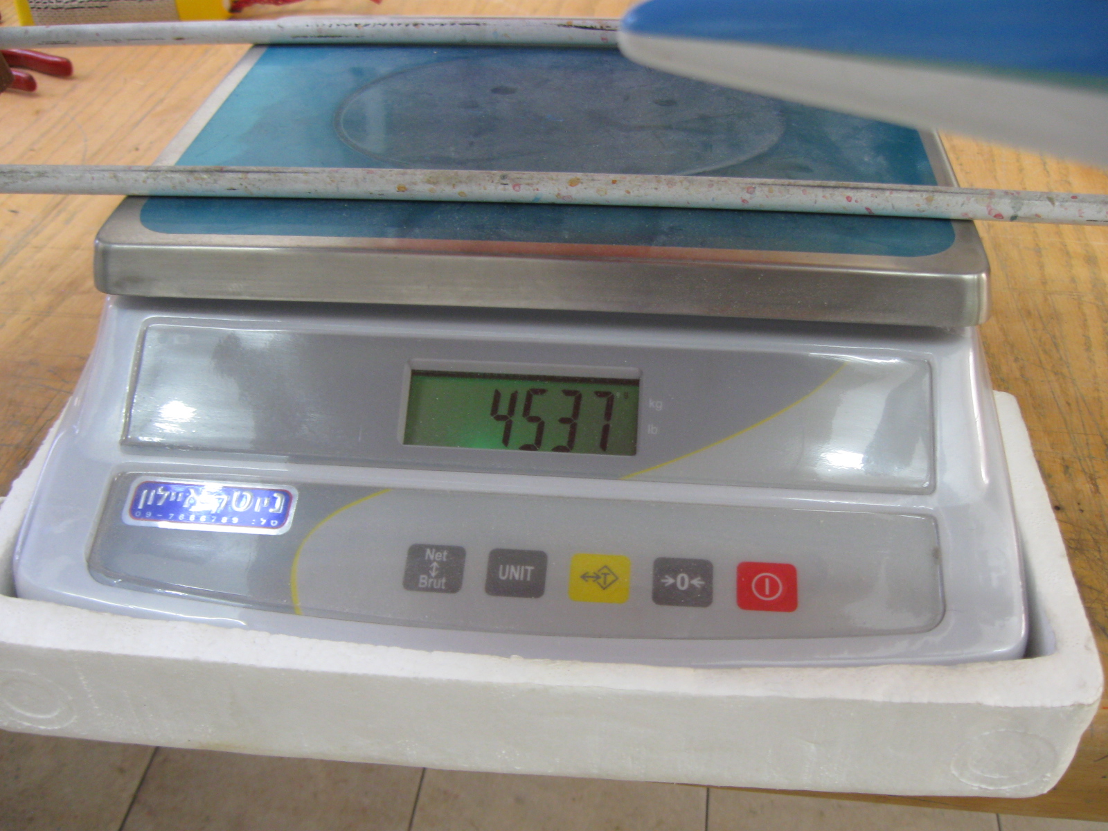

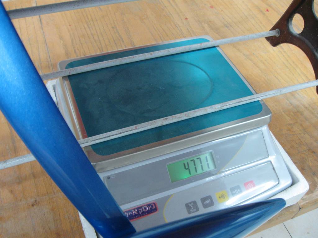

Now the final weight is = 4,771 gram.
With Rhino Battery 1,203 gram and 21 X 13 APC prop.
Best regards,
Isaac Najary

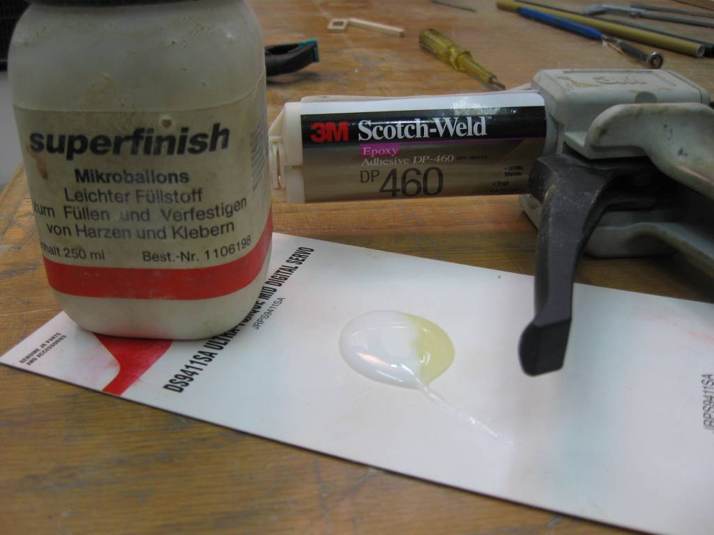

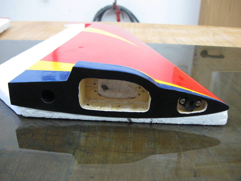

Hi Isaac,
When you fill the wing root (Post #151):
1) do you lube or do anything special to the plastic wrap?
2) are you using epoxy and microballoons? if so, is it finishing epoxy?
I have to fill the roots of my Integral. It is a composite wing so I was thinking of a wide bead of epoxy/microballoons or a wide bead of Hysol.
Thanks again for all of your work and information. I am learning a lot from you.
Best,
Joe
Old 08-01-2013, 07:07 AM
  #319
najary
najary's Avatar
Join Date: May 2003
Location: Ramat Hashrone, ISRAEL
Posts: 1,201
Received 36 Likes on 32 Posts
Default RE: ARIXTRA Build Thread by ISAAC NAJARY
ORIGINAL: gaRCfield
Hi Isaac,
Best,
Joe
Hi Joe,
Sorry for the late answer.
1. I use some water with the plastic wrap.
2. I use structure epoxy with large quantity of microballoons see picture.
Best regards,
Isaac Najary

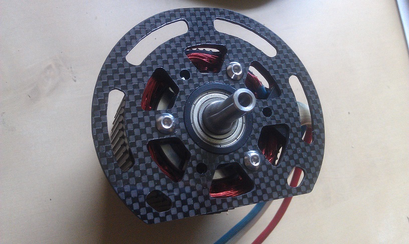

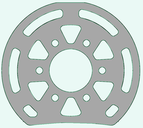

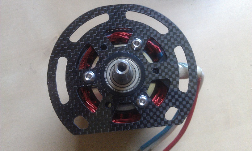

Isaac, how is your motor mount holding up? I am in the process of making a carbon mount. My first piece looks great but I am concerned about how little material I have surrounding the bolt holes. I know I could use a little more but not sure how much. This is carbon from HK (this mount is .060"/1.5mm, but I will use either 2.5mm/.100" or a piece of .090" I have. Your mount in #104-105. The digital picture is my next rendition. Actual part has 2.8mm material to either side of hole. Digital model has 4.65mm. Holes themselves are 4.6mm diameter.

Cool
The Arixtra weights 4,537 gram!!!
With the new DUALSKY batteries SD-130730F (4,600 mah 25C) - 978 gram!!!
Best regards,
Isaac Najary

Isaac, where did you get those batteries? Have a link?
Thanks.

Hello Isaac
How many flights with these batteries ?
Claude
Old 09-05-2013, 11:29 AM
  #325
s-chester
Join Date: Nov 2006
Location: petch tekva, ISRAEL
Posts: 76
Hello Claude
Isaac asked me to answer because I have more experience with these batteries
I have two batteries, each one has 12 flights
Presently they are like the batteries from hobby king, the rhino 4900 20C
In thrust, power consumption, heat and will internal resist (average 1.4 per cell)
Chester
